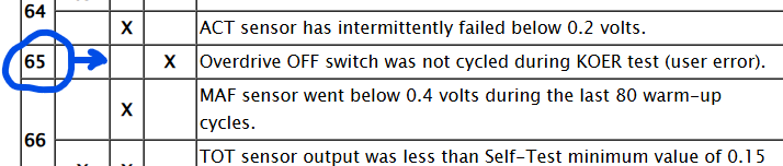

I was reading online where other people also received the code 65. And apparently it’s due to me not cycling the E4OD OD switch during the KOER Test.

Thanks. that I what I was reading elsewhere. This in my first truck with an E4OD. Previous models had the AOD or C6. So I didn’t need to switch the OD switch and the KOER test never prompted me to.
