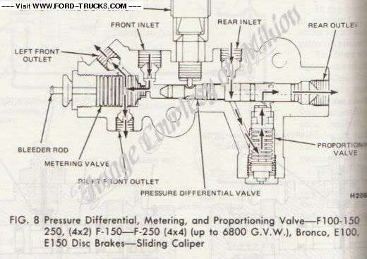

GVW dictates bleeder rod in or out.

I did forget about that proportioning valve pin. I’ll pull that in the morning
