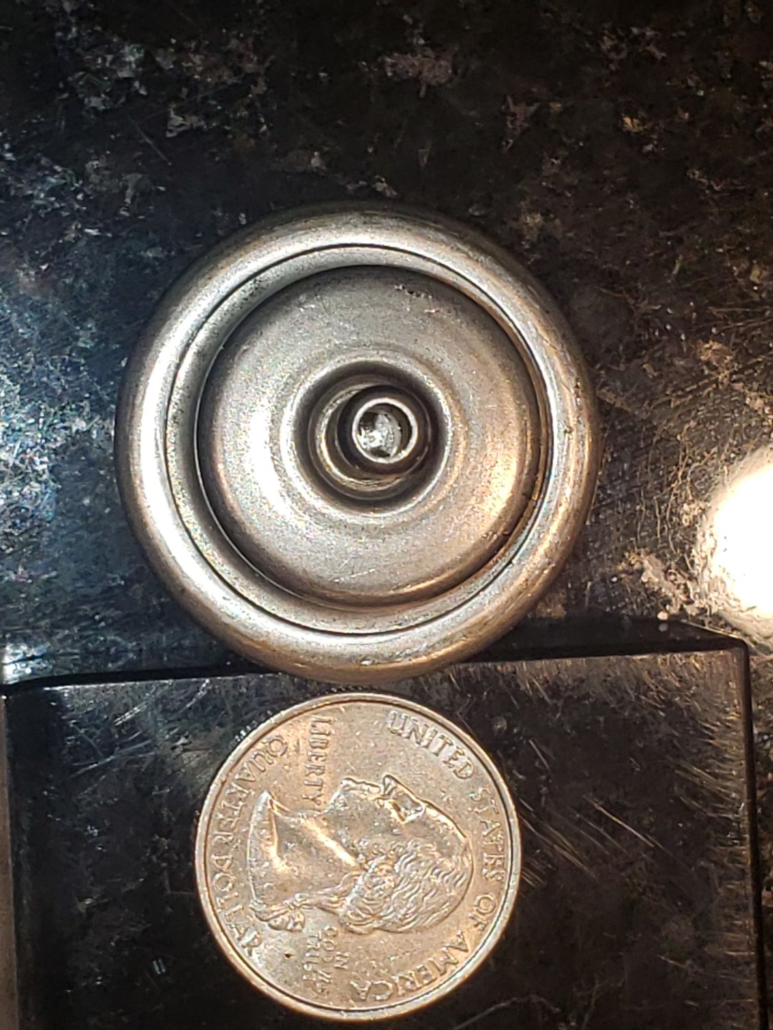

I have a 2000 Ford Excursion with the 6.8L V10.
I lost the snap ring for the Fuel Pressure Valve. While removing the snap ring, it dropped of the snap ring pliers. I thought no big deal, I will locate it after I get the fuel pressure valve out.
Well Hells Bells, I can find that dropped snap ring anywhere. Of course you can't get an eye back there to see anything. The only think I'm able to do is take my cell phone and take random pictures at every angle possible. Still, no luck finding that thing.
Here is my problem, I can't find a source for that snap ring anywhere.
The local Ford dealership says that they do not even have a part number for it.
The local parts stores don't have anything.
None of my local auto recycling yards have it.
If I can't find a source through this form, I will probable purchase something from McMaster-Carr.
Does anybody know the actual part number for this part, or even better yet, where I can source it.
Thanks for taking a look at this.
Dan
Not my snap ring, just a photo on the internet

It is serviceable, albeit not easy to get at. That's why I bought the replacement part first. I figured if I can't get it out, it can't get serviced.

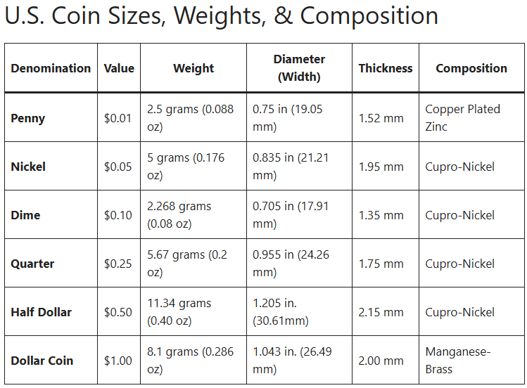

If someone could take a picture of this retainer ring alongside a quarter similar to what I have attached for the fuel pressure valve, I could use the quarter to scale the image. For example, a quarter is .955" diameter. With the size of the quarter known and the size of the fuel pressure valve, I can take a picture of those two side by side and the scale that image with my solid modeling software.
From there it is super easy to parametrically model the ring.
From there I can source the retainer ring from a non-automotive source.

I have ordered two different styles from McMaster-Carr.
The Inverted snap ring was $7.92 for a qty of 10
The Internal Teeth snap ring was $6.32 for a qty of 10
