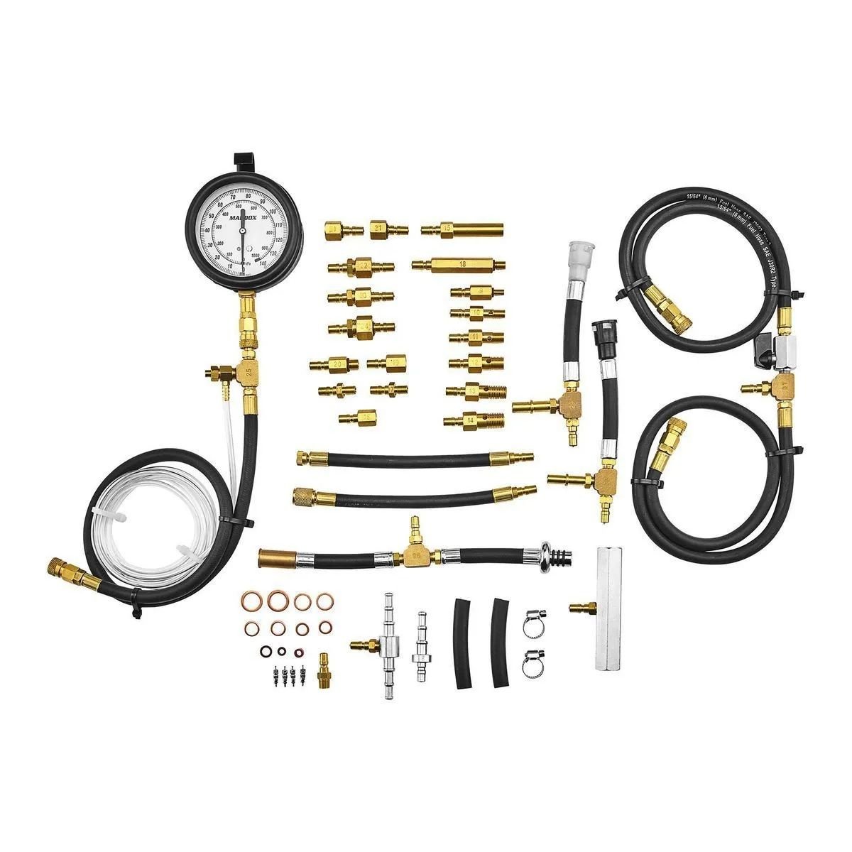

Sounds like a fuel issue.
can you check fuel preasure from the Schrader valve on the passenger side .
if you don't have a dedicated test tool , you can use a tire pressure gauge .
WHAT?? thats a fire waiting to happen , most auto parts stores rent the kit, play safe do it right or don't do it.
