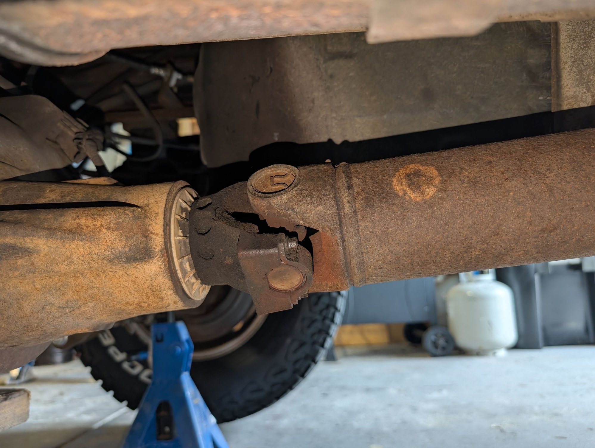

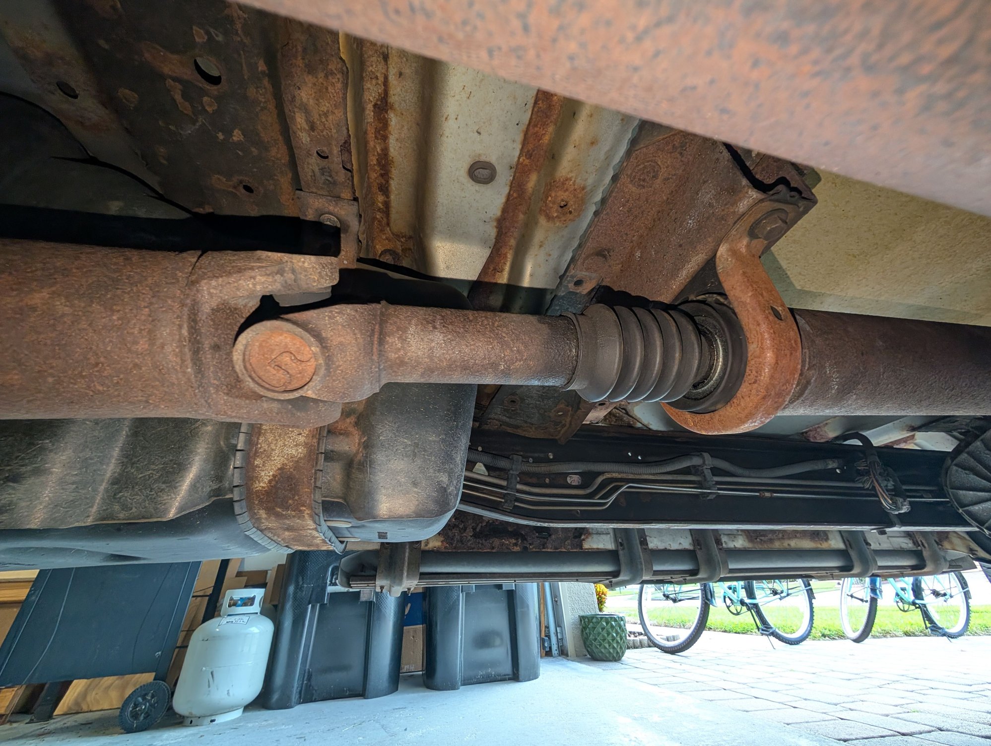

Follow up: the noise comes from the rear U-joint that holds the drive shaft to the back of the rear axle. I moved it and saw the slight movement of the U-joint. I think they are original. So why I am at it there is another one that attaches at the front. Sorry bad at the terminology. Ill get sealed Spicer U Joints. There are 4- MM 8 hex cap bolts. I need a 6 point box wrench. I don't want to strip anything but I put new ones back in. Do you think I can sand down the outer drive shaft? I am tempted to do it myself. I had a shop do the front shaft for the 4 wheel drive. This one comes down when you take the carrier bearing down.

Personally I wouldn’t sand anything.
As for the bolts, give it a good spray of PB Blaster/liquid wrench and let it sit overnight. A 12 point box should be just fine, the torque on those shouldn’t be too much. Just tap the wrench with a hammer to help shock them loose if needed. Take your time and be patient and I doubt you’ll round them off.
Do you have a press? You can bang them out with sockets and a hammer but they can be stubborn

I ordered a 6 pt 8mm wrench from NAPA. Yeah, I always do the PB Blaster shower on this 23 yr old beauty. Sometime even break out the Map Gas and yes, a few bangs of the persuasion hammer. Its gonna to be a Fall job for sure...

those bolts have blue loctite from the factory , so use the pb blaster , then the map gas torch before applying the wrench.
a drop of lecture on install is a good thing .
