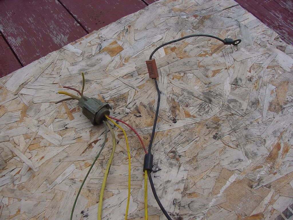

Is this the fusable link you replaced with a fuse?

and yes, thats the fuse that im dealing with
