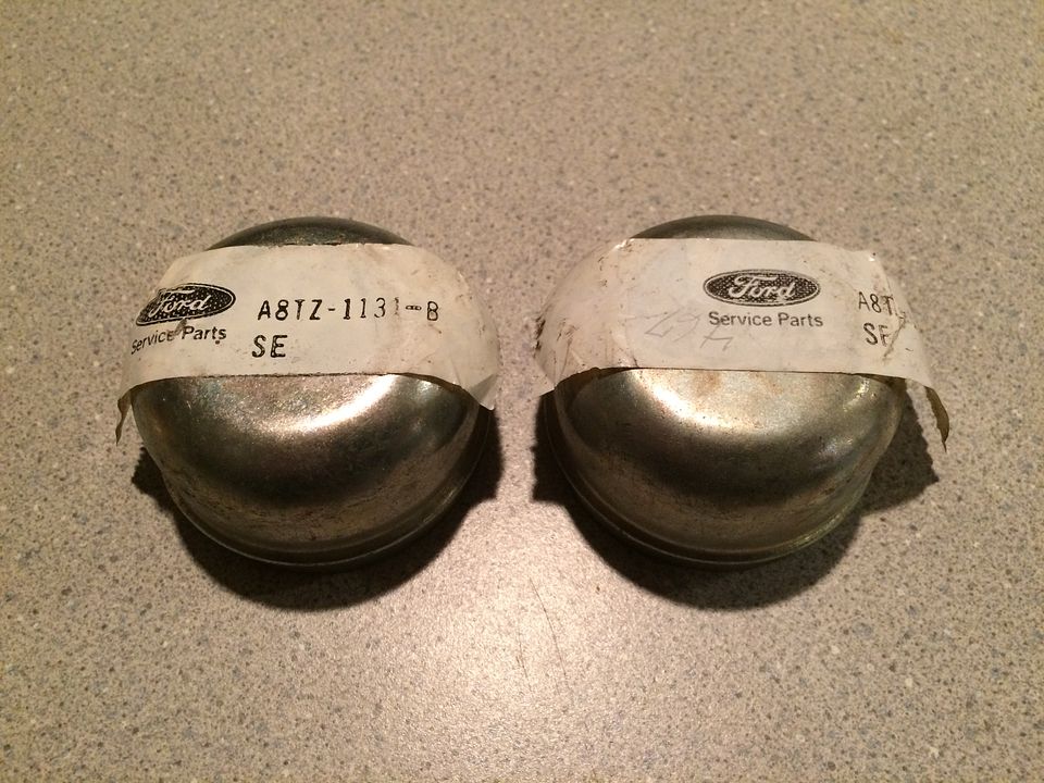

What we need to know is if the truck @Pickupmanx2 is working on has the Heavy Duty 12" x 2 1/2" brakes like a 1966 F250 Camper Special might have or the 12 1/8" x 2" that all 1965 F250s and some 1966 F250s came with.
The dust caps were different for the ones with the H/D brakes for 1966 and up.
A8TZ-1131-B - CAP - FRONT HUB GREASE - 2 1/4" O.D.
Otherwise, it would use
LF-1131-A - CAP - FRONT HUB GREASE - 1 31/32" O.D.
Old Aug 28, 2025 | 10:18 AM

Dorman #13973 has the same diameter as the Ford LF 1131-A, 1 31/32” O.D. I think that is correct for 66 F250 2WD? Someone smarter than me can correct me, though.

It might be correct or might not. My post just above yours mentions the Heavy Duty brakes like some Camper Specials came with which used the larger sized dust caps. No, I'm not smarter at all just had run across this when researching for my one truck.

YES, they are the 2 1/2" brakes, and the dust cap is the 2 1/4" cap and unfortunately I'm going to need a brake drum also... the brakes had a bounce to them, DR side has a crack and is slightly out of round, the young guy I sold it to, then bought back from, had put spacers on the front, didn't loc-tite them, they came loose on dr side and wheel came off, bent fender and bent/cracked brake drum ugh..

There’s one of the larger one Chad listed NOS on eBay.
