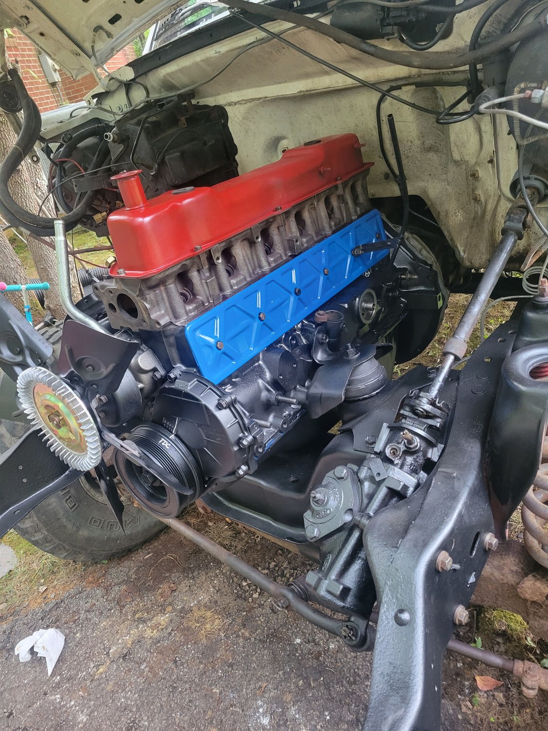

So I installed and torque down the head bolts and now I forgot something and have to take them back off. So can I reuse the bolts or do I have to buy a new set?

It's on a 1991 ford f150 300 4.9l inline 6 I dont know if that's makes a difference, i torque them 3 days ago and forgot something now i have to take them off.

Digging the red and blue theme... gives off AMC Rebel Machine vibes.

the red goes with the red trim around the truck and i threw the blue on there cuz of the blue felpro gaskets. I had to take the head off bec i used the high tack red crap on my head gasket then i read ypu can only use the copper spary.
