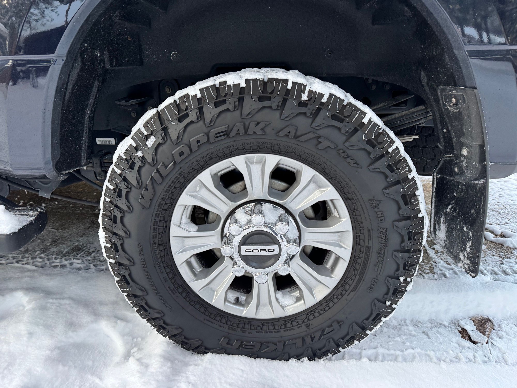

The Falken Wildpeak A/T4's are also 3 PMSF rated. When I switched rom the crappy GY Wrangler's that came stock on my truck I knew I wanted a 3PMSF rated tire.
Also, I just posted a 30k mile update on my WP A/T4's over in the 6.7 section. Here's a link to it.
In short though, they have been amazing tires. Great traction in all conditions I have been in, which is mostly wet roads, but they have seen other conditions too. 10 ply, load range E, 3 ply sidewalls, and rated for HD trucks. They run quiet and in 30k miles with routine rotations, have gone from 18/32 to 13/32 (fronts) and 14/32 (rears) so they are wearing great. I fully expect to easily get 60k out of these tires, and that is under the weight of a 6.7.
