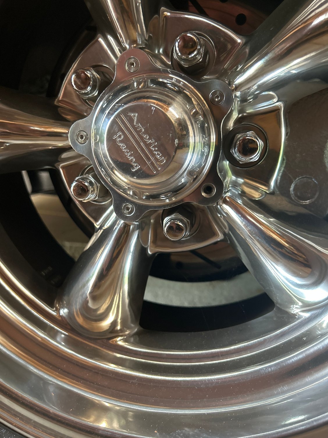

Wheel screw
Blue Loctite only works on most screws not sure I want to use red
Got any ideas??
Got any ideas??

Definitely not Red!!!
Blue should be fine or you can use the white thread sealant which is lighter duty than the blue. The orange is heavier duty but still removable like the blue.
A drop of the blue loctitie will take care of it. Yiu don't need much. Literally just one drop.

Yeah used blue
screw is ss wheel aluminum don’t know if expansion is the problem? Or the difference in material

Interesting. I have the same rims and have lost one of those screws as well. the rest are fine.

Those wheels just look like... Cobra!
Blue is good - red usually takes heat to loosen.
