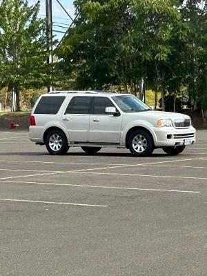

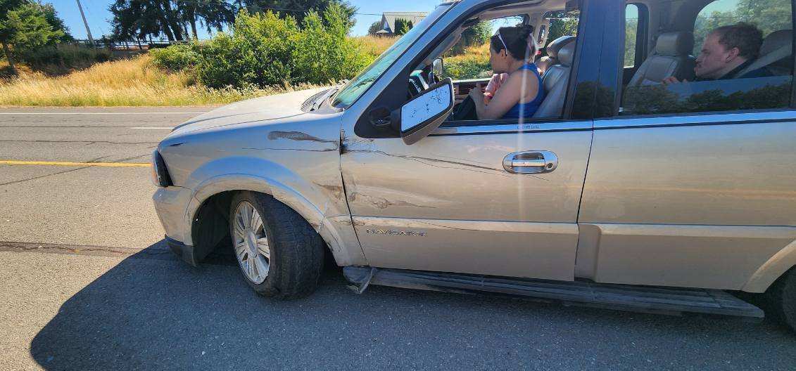

The doors are the same between the 06 Navigator and the 06 Expedition. I am waiting for a bottom ball joint for the navigator before I can get it in the shop and up on the hoist. The bottom ball joint pulled the ball out of the socket on impact. The ABS and roll stability control let my daughter keep from hitting opposing traffic head on. Even with the left front wheel along for the ride. The shroud hits the fan on the passenger side and the tire dented the firewall and bent the frame. The body bolt that I can see is tilted, it was straight before. I suspect that the whole body tub is twisted on the frame. I have purchased two other 06 products to save this one. I bought the original Navigator in 07 with 30k miles. I am vested in this car, it was in excellent condition until July 11th. If the tub is bent beyond what I want to deal with I will transfer the air ride, 4wd and the complete interior to the beautiful 06 Navigator I bought. If I can save the tub I will transfer the tub and powertrain to the 06 Expedition frame I purchased today. The white one is the 2wd I purchased in the 16th.

Glad to hear everyone is OK after seeing that picture.
Your plans sound like a lot of work to salvage a 20 year old vehicle. I have an 03 Expy that I bought in 04 with 30k miles. It now has 180k miles. If mine went through something similar, I'd thank it for the memories and send it to the junk yard. Good luck.

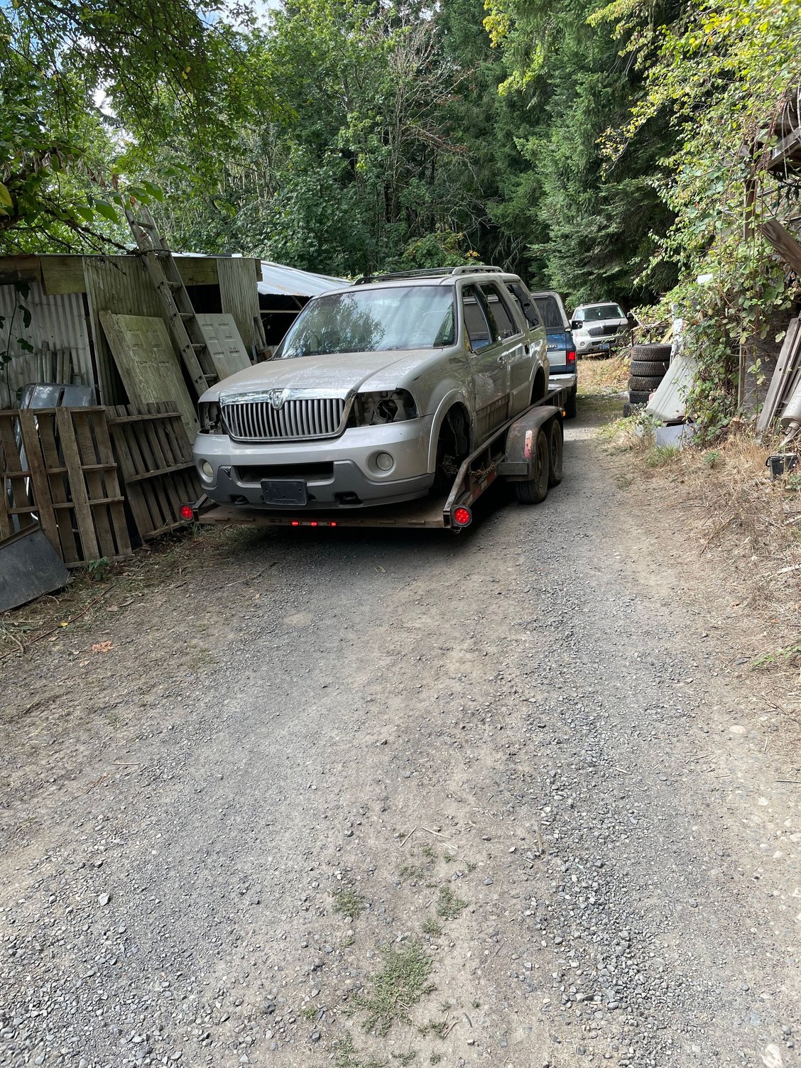

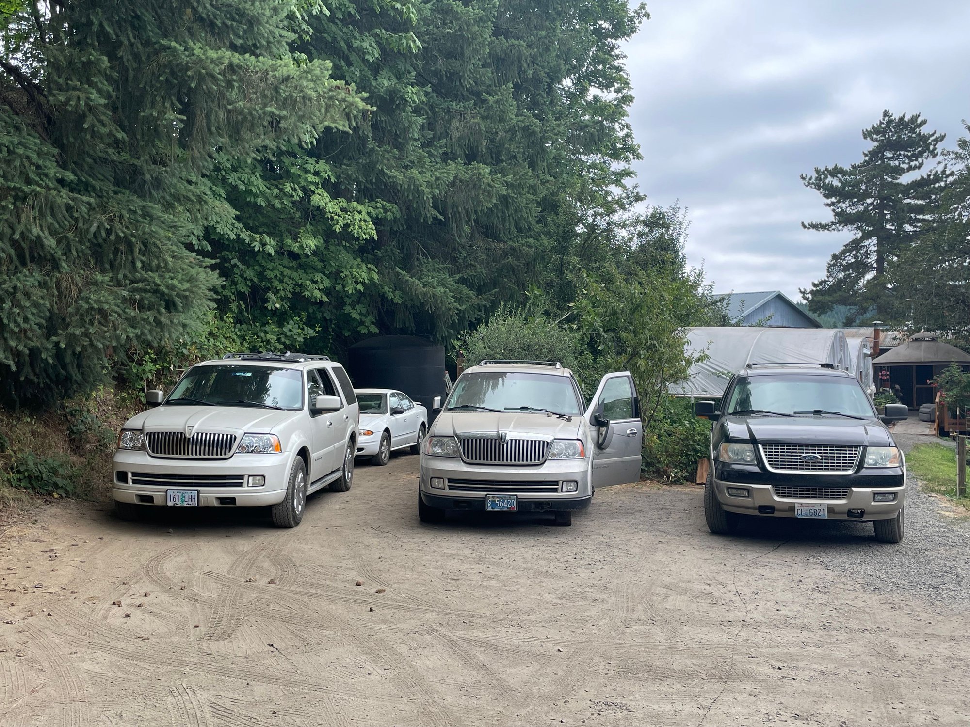

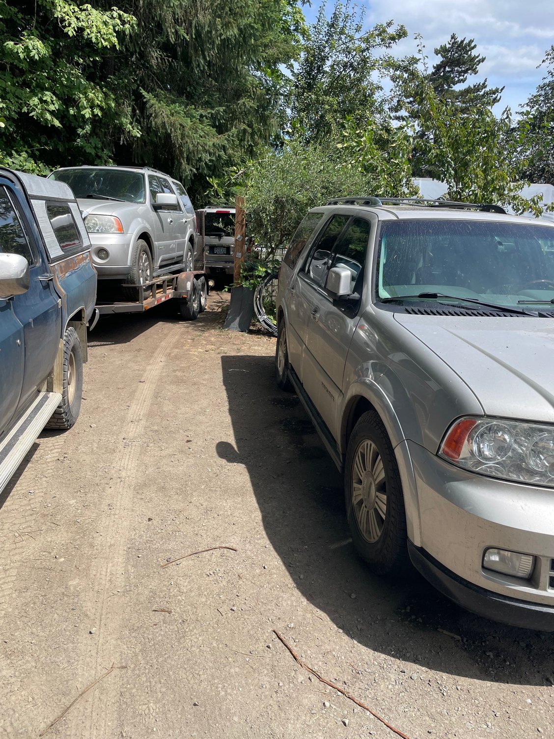

Bought two more Navigators this week. I bought a pair of 2003 Navigators the same silver as my wrecked 06. 03-04 are the same, 05-06 are the same. The two 03s have the four cam, 32 valve 5.4 and a 4R100 trans. The 06s have the 24 valve 5.4 and the six speed ZF transmission. I got the lower ball joint installed in the wreck so I could drive it into the shop.
I am going to built one of the four cam cars as a replacement for my 06 wreck. One of the 03s is almost ad nice as my 06 was before the wreck. Progress, I retire in ten more work days and will have more time for these projects.

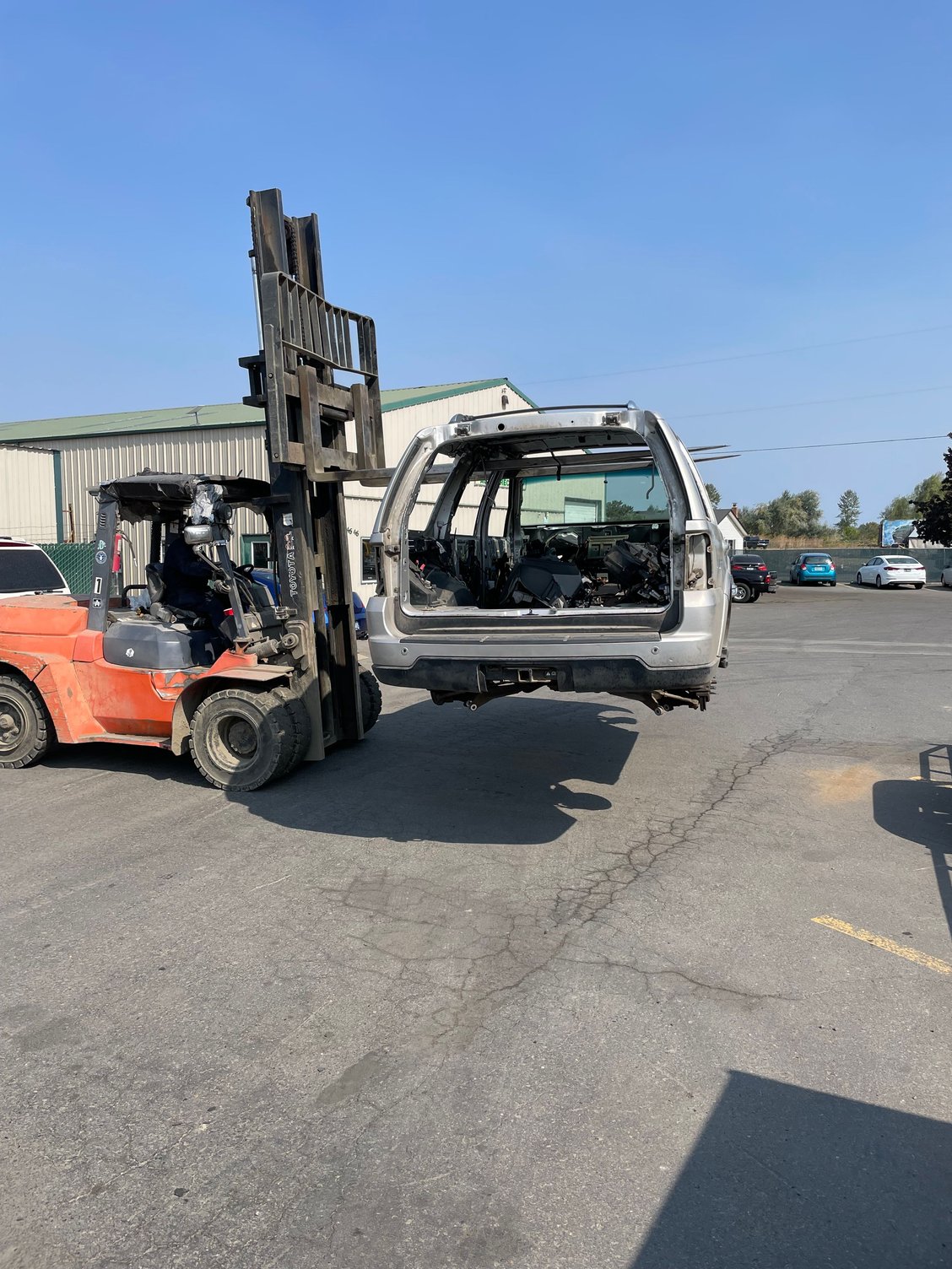

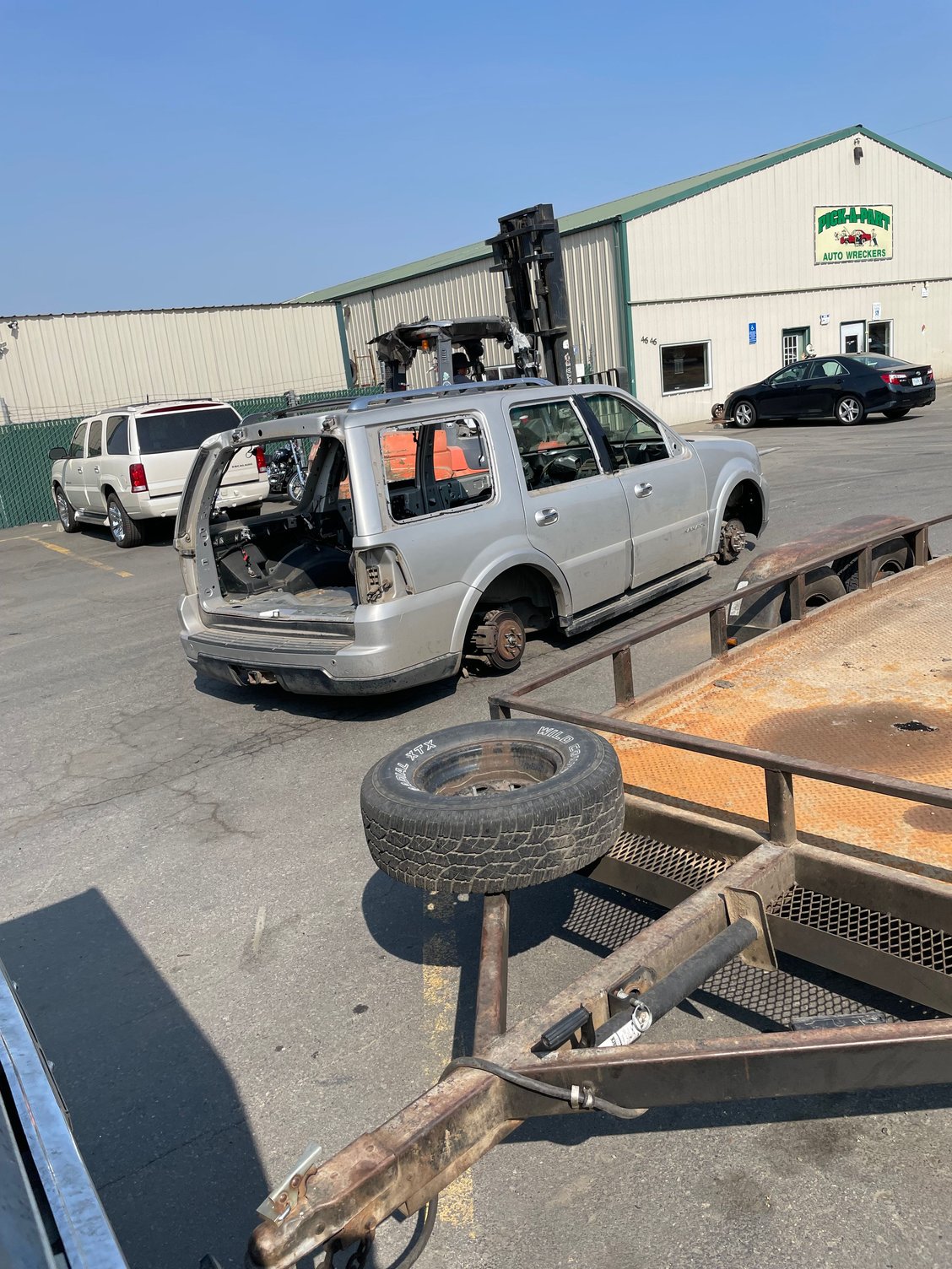

Update, the original Navigator is stripped and gone. Stripping the parts donor 03 now. Tranny out today! Engine tomorrow?
