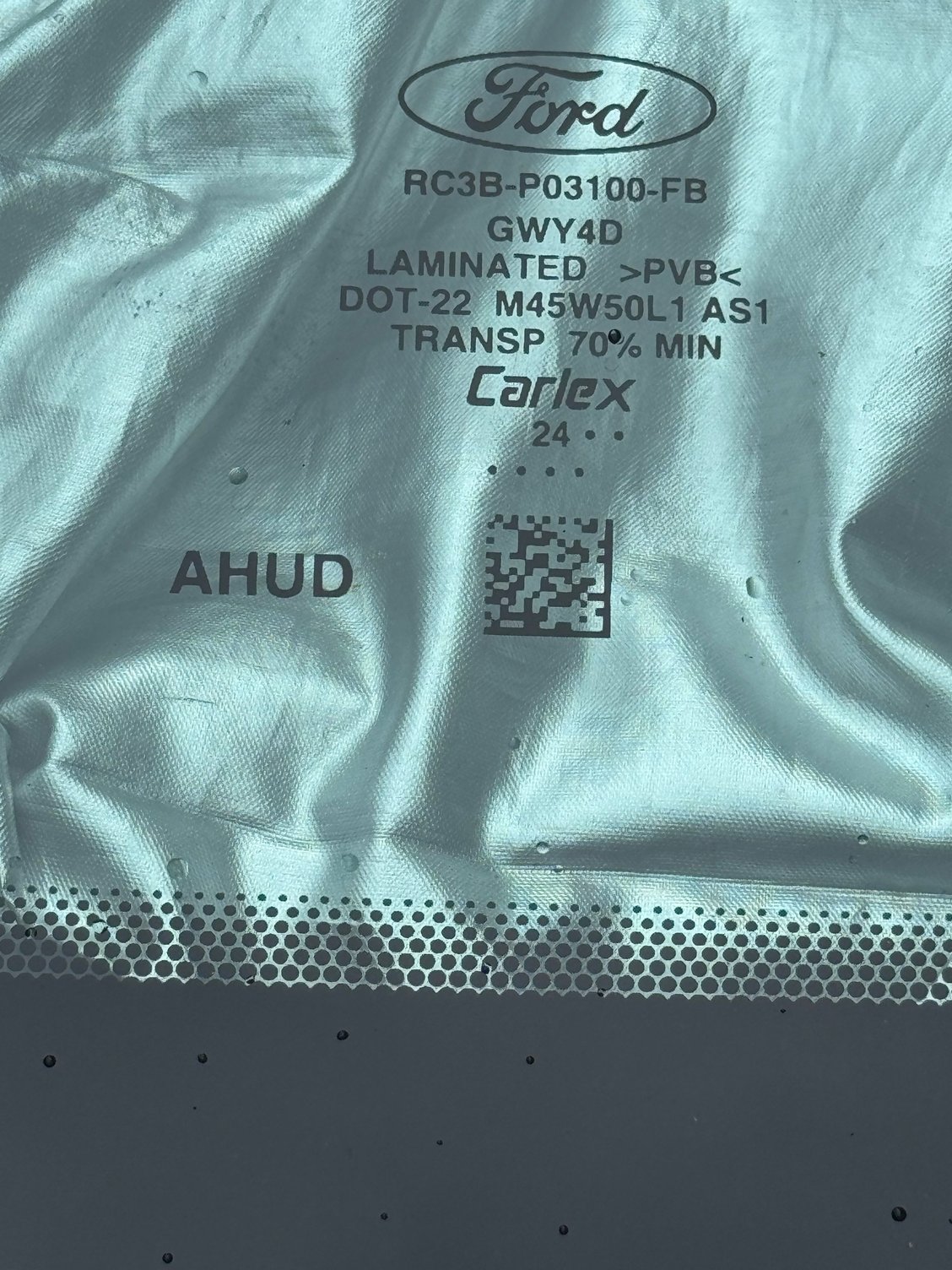

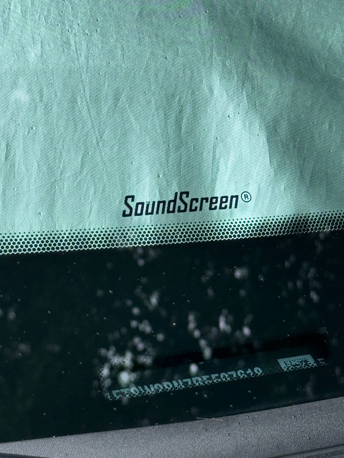

Just curious with the windshield they put in . What would the Ford manufacturer number would be on the windshield . Does anyone have a 2024 F250 with hud ?
Just curious if this windshield is really a OE windshield. The manufacturer number on this one is RC3B-P03100- FB

I have 24 KR with HUD and had to have windshield replaced and had Safelite do it. Had to make sure when they showed up they had the OEM windshield and not their version. Seems if you don't make it abundantly clear you'll have to delay a day or two for them to get the OEM. Appears you have the same part that is on mine. I made sure the FORD logo was at the top and at the bottom it had AHUD and SoundScreen. Also make sure the electrical pigtail at the top of the screen comes with the windshield.
