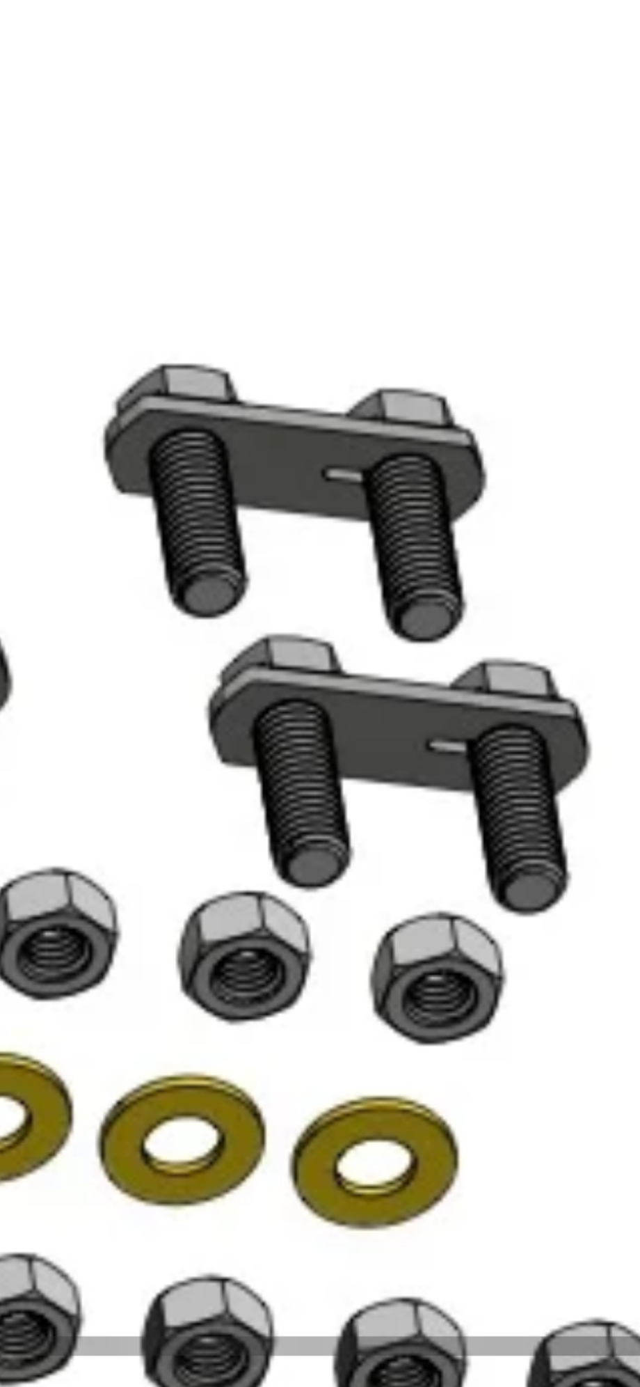

im looking for rivet gun type tool inserted box bolt but all I seem to find are these....
anyone have a lead on more box bolt options?

maybe I am thinking about these rivet nut type inserts......

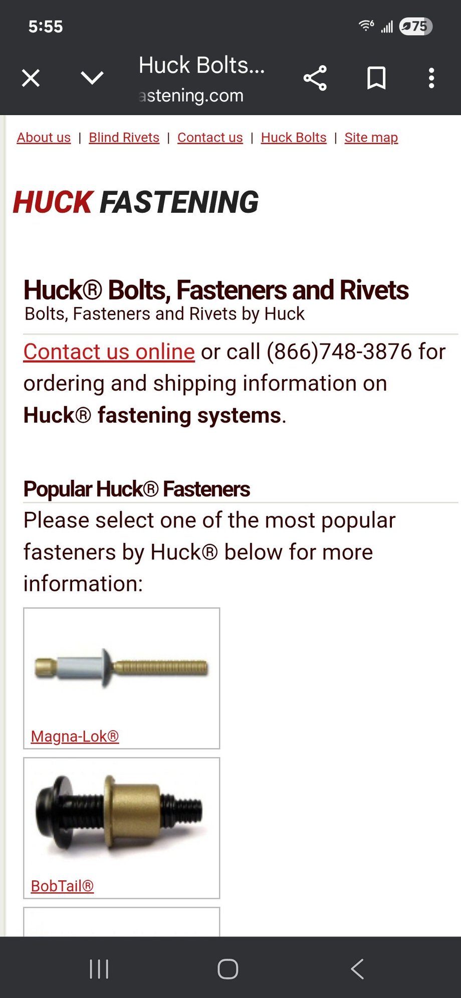

For anything bigger fastener wise you'll need to go to huck style, but the install tool is spendy for them.

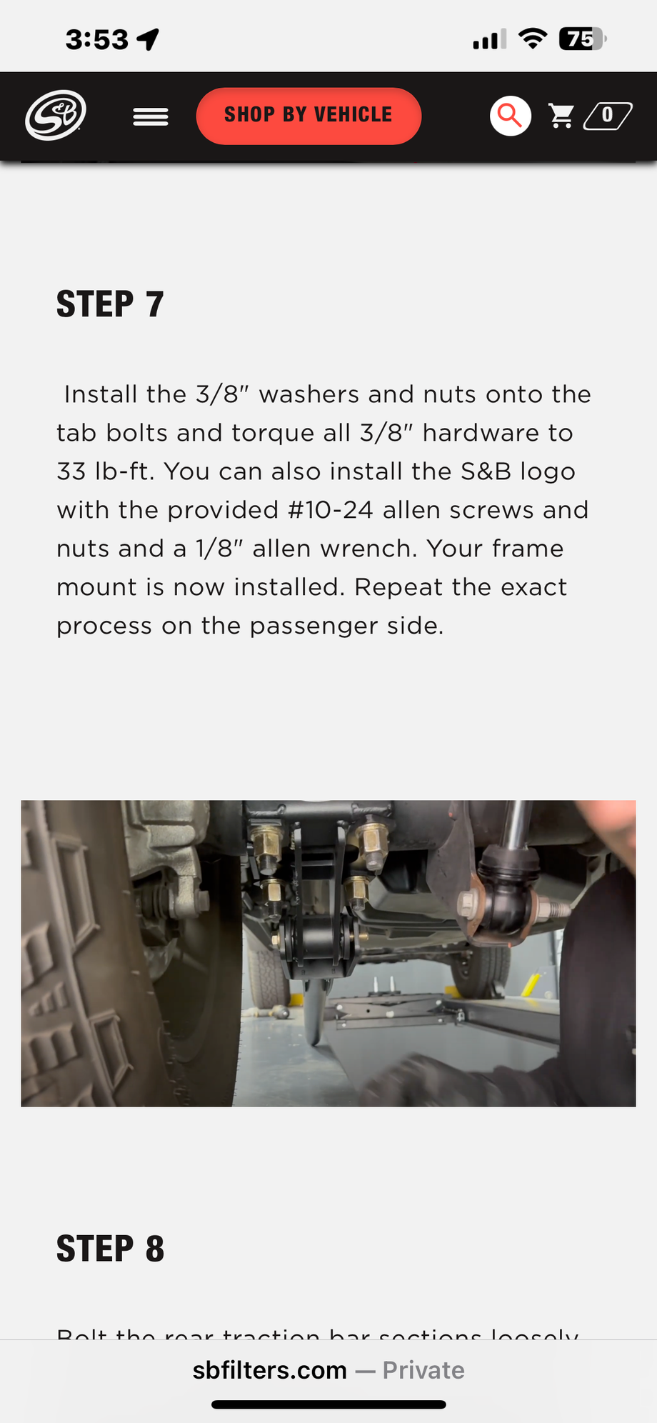

not sure if I want to use the bolt sets that are included in the kit....they all have to be fished thru using the nearest drain hole....or use boxbolts like the first boxbolt I posted a pic of....not sure what the clamping force is of the box bolt....I read some FAQ's to the producers of boxbolts concerning clamping force and the manufacture responded with contact us to get our help on determining how you can test clamping force. which to me means there is **** poor clamping force especially joint gets repeated shear loads like a traction bar mount vs two beams inside a building that doesn't really get tugged and pulled.
the rivet type seem to get loose frequently since there are published replacement proceedures...guess they get loose over time.
so it looks like I will be fishing bolts thru the frame.

Huck Bolts, Fasteners and Rivets
https://huckfastening.com/

These are the bolts

Hmmm
I see the challenge
I see many bad words
but slow and steady, how close are the largest hole that can accommodate the double bolt plate

The torque for the box bolts 3/8 dia shank seems to be the same as required for the supplied bolts….pondering
