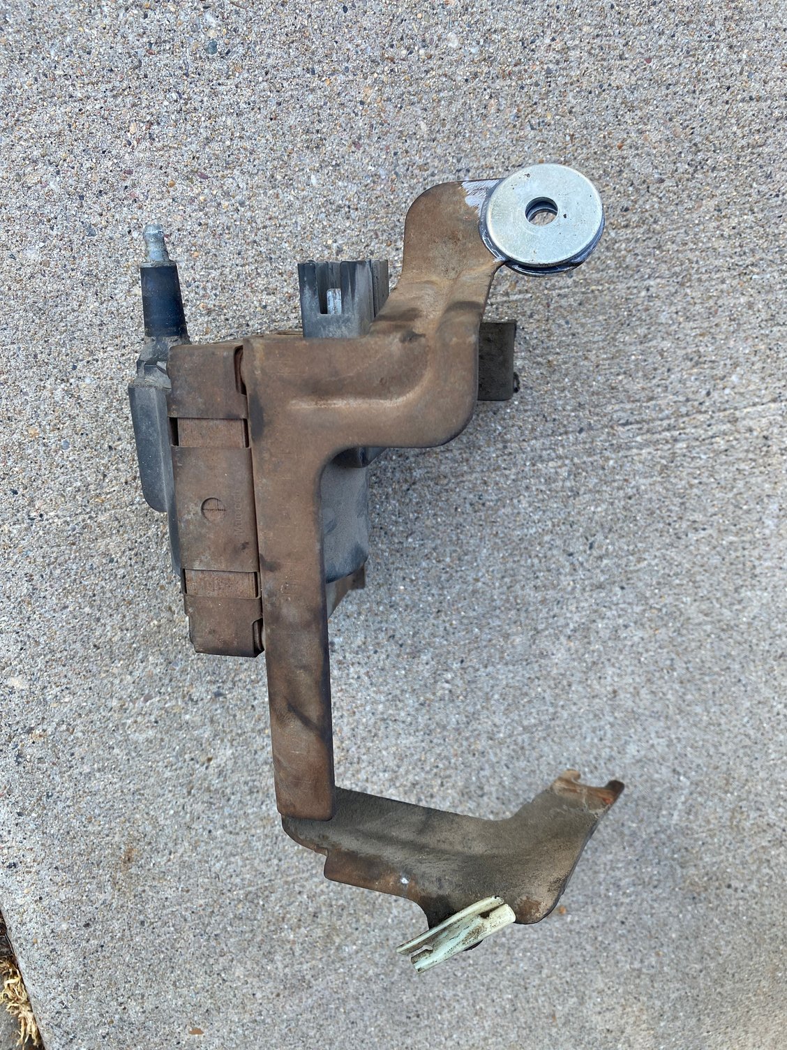

I've noticed a broken part under the hood and from what I can tell I believe it is the Ignition Coil mount....correct?
I've tried searching for a replacement mount - does anyone know where I can find one?
(86 F-250)

Take it to a local fab shop or one of your neighbors if they weld. Have them weld a washer on it, will be good for a long time. They sell the brackets for a 5.0 mustang the same years, but I am not sure it will fit.

Fender washer sounds good. How about one on both sides with the broken end sandwiched between them with a coating of JB weld as the mayonnaise? Clamp that together for 24 hours and you should be as good as a weld.

Regardless of which condiment is used, I'd suggest a slightly different plan of attack. If you simply repair the bracket at the crack, that's still the weak point. Instead, cut the bracket back a half inch or so from the crack. Fabricate a longer repair piece (with the bolt hole near one end) to match the original dimensions, overlapping the existing bracket. Bolt or rivet the two pieces together. Should last a long time.

You can use a nut and bolt for your clamp. Put a light coat of oil on the bolt so it doesn't bond to the JB weld. Then you can remove it easily after the epoxy cures.

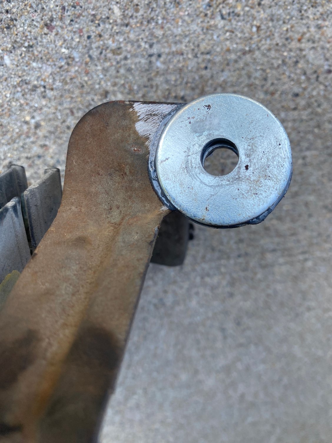

It worked!
I found a couple perfect washers - then roughed them up good on the inside. Put the pieces all together with some JBWeld (used some oil on a bolt as suggested) then tightened it all down to let it dry for 24 hours.
Wen't back in to place pretty slick.
Thanks all for the suggestions and info!!
Perfect!!! (perfect enough anyway)

I am not sure how to reply and it alert others on the thread - but pics posted! Thanks for the help!

Looks good
