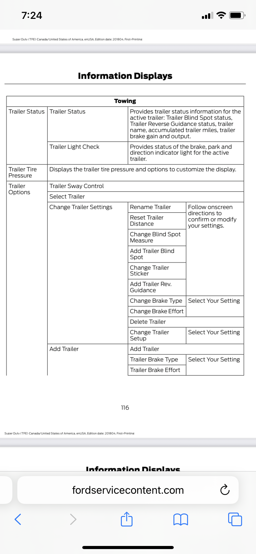

You may not need this video but it might help.
