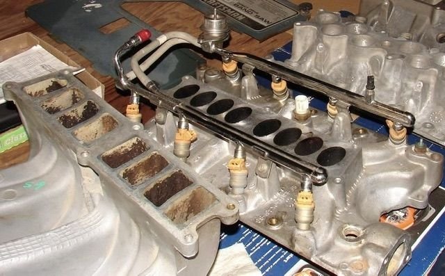

Originally Posted by Sycostang67
Good to know the upper intake is different, would not have guessed that..
Here is a picture from Scndsin’s 302 upper to 351W lower hybrid intake thread. The 302 upper is on the left and the 351W lower is on the right
