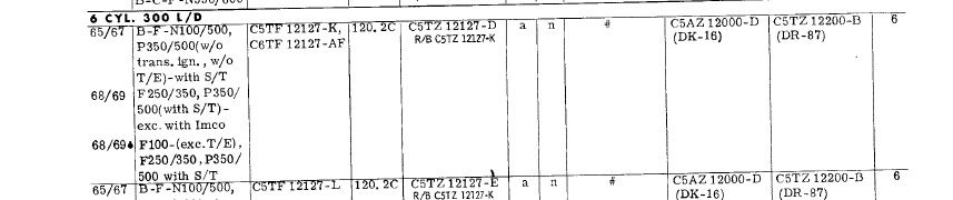

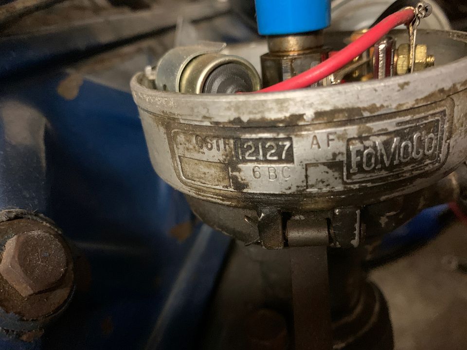

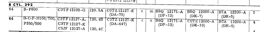

A correct original distributor should have a date code on it that precedes the date of the truck by a few days to a few months at most. At least from 1955 through 1964 they had FoMoCo in script letters cast into the distributor along with the base number -12127-. They then stamped each with a prefix, suffix and date code of the day the distributor was assembled.
Here's a 3MB (December 2nd, 1963) date code C3TF-12127-K - good for a very late calendar 1963 (1964 model year) built to early calendar 1964 292 V8 for example.
Starting in 1965 they went to the FoMoCo block lettering like this one below.
This one a 6BC (February 3rd, 1966) date code C6TF-12127-AF - good for an early 1966 300 (but not 240 since they used the Load-O-Matic) 6-cylinder in this case.
It can be easy to tell if a distributor is definitely NOT original or if it is potentially original or plays the part well.
The original vacuum advance canisters had a removeable fitting on the front with a threaded opening for the fitting to screw into.
Visibly distinct from the one-piece replacement canisters.

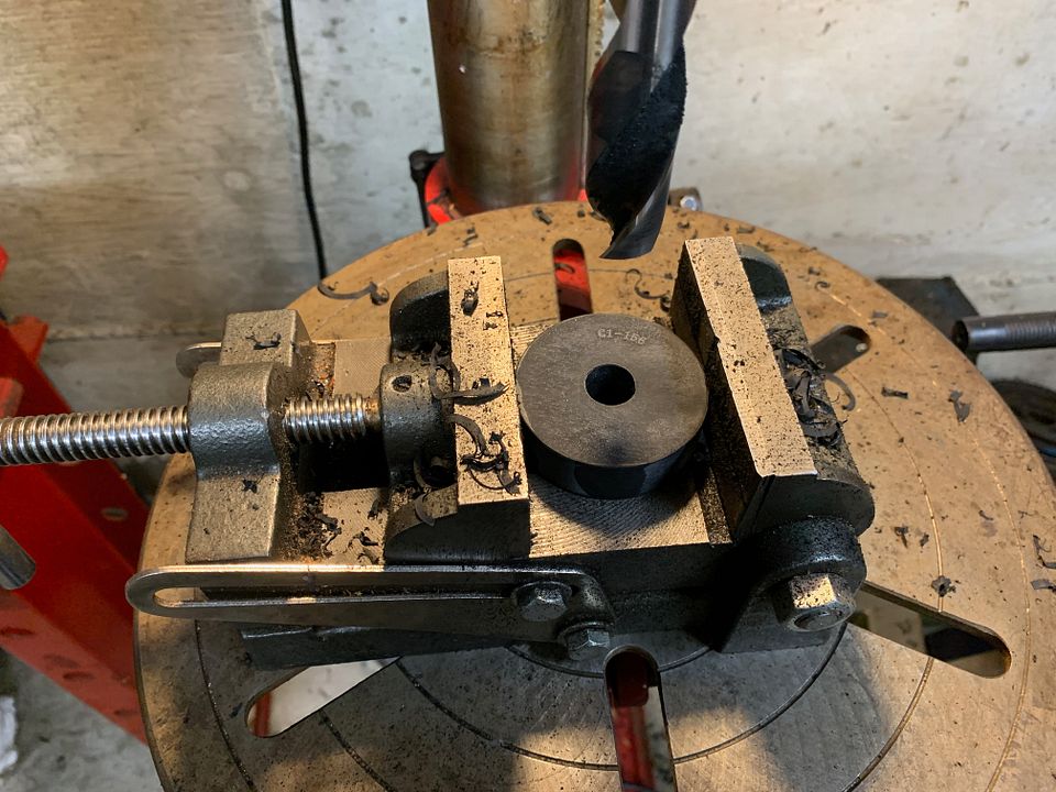

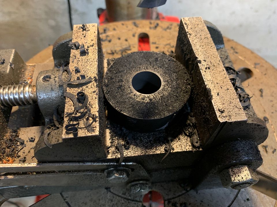

I believe - but not positive - that you have a Pertronix 1 module there. If so, the black piece has 8 magnets in it that each create a Hall Effect to fire the applicable cylinder. I would think there should not be any problem opening up the middle center of the black piece so the rotor center passes through it and seats a bit better. As long as the black piece spins with the distributor cam and the rotor it should pass by the stationary Pertronix module and create the energy to fire that cylinder. Might sound funny but I'd probably put the black piece in the freezer while I found a drill bit just slightly bigger than the base of the rotor. After a couple of hours pull out the black piece and drill the center of it. Freezing the plastic makes it easier to drill without it burning the plastic. Works with rubber, too.
Rubber body mount frozen
Then drilled clean as a whistle
A very sharp drill bit helps.

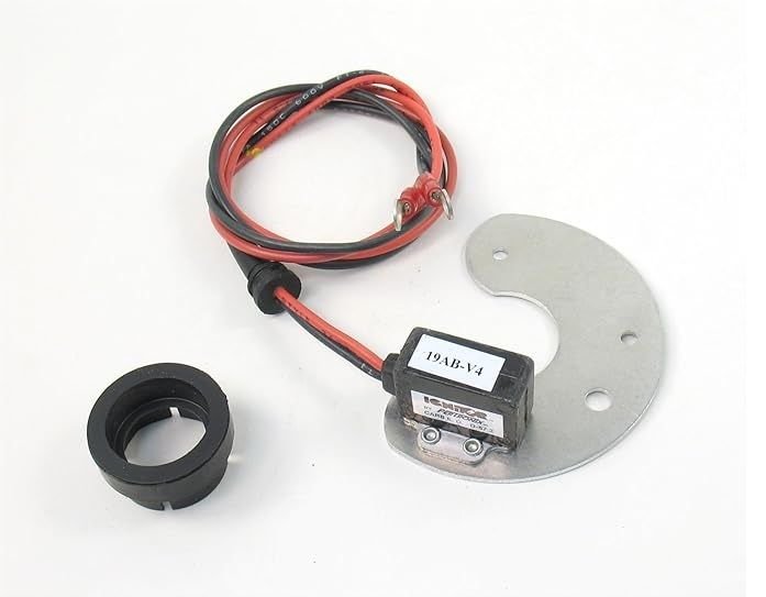

It looks like it is still available. In looking at the first picture below it almost looks like the magnetic sleeve reluctor has a larger center hole, doesn't it? Or is it just me?
Amazon.com: Pertronix 1281DV Ford 8 Cylinder Ignitor : Automotive Amazon.com: Pertronix 1281DV Ford 8 Cylinder Ignitor : Automotive
From the Amazon page
PerTronix 12813 Magnet Sleeve (only) for 1281 Ignitor Kit – Pertronix
From Pertronix web page. Might be an older picture?

I think you are correct the hole is larger in the one in the kit.

The 1281 and 1281DV are different. 1281DV is for dual points so that's why the picture on Amazon is showing a different magnetic sleeve.
