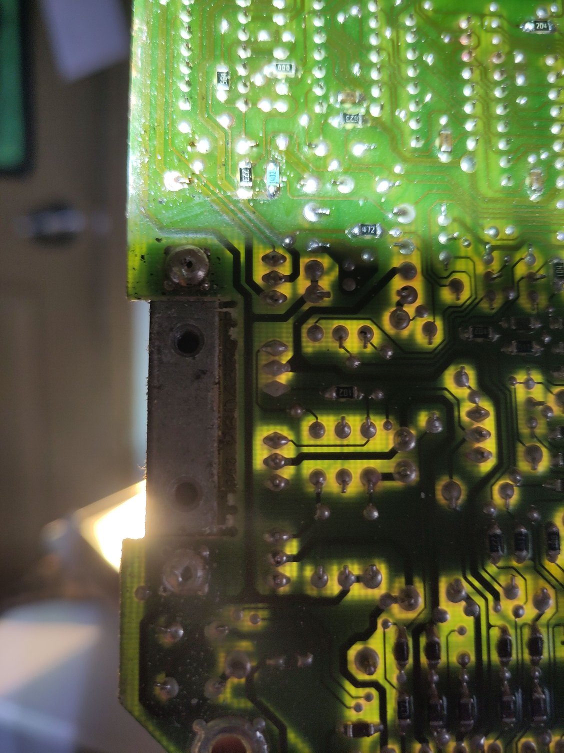

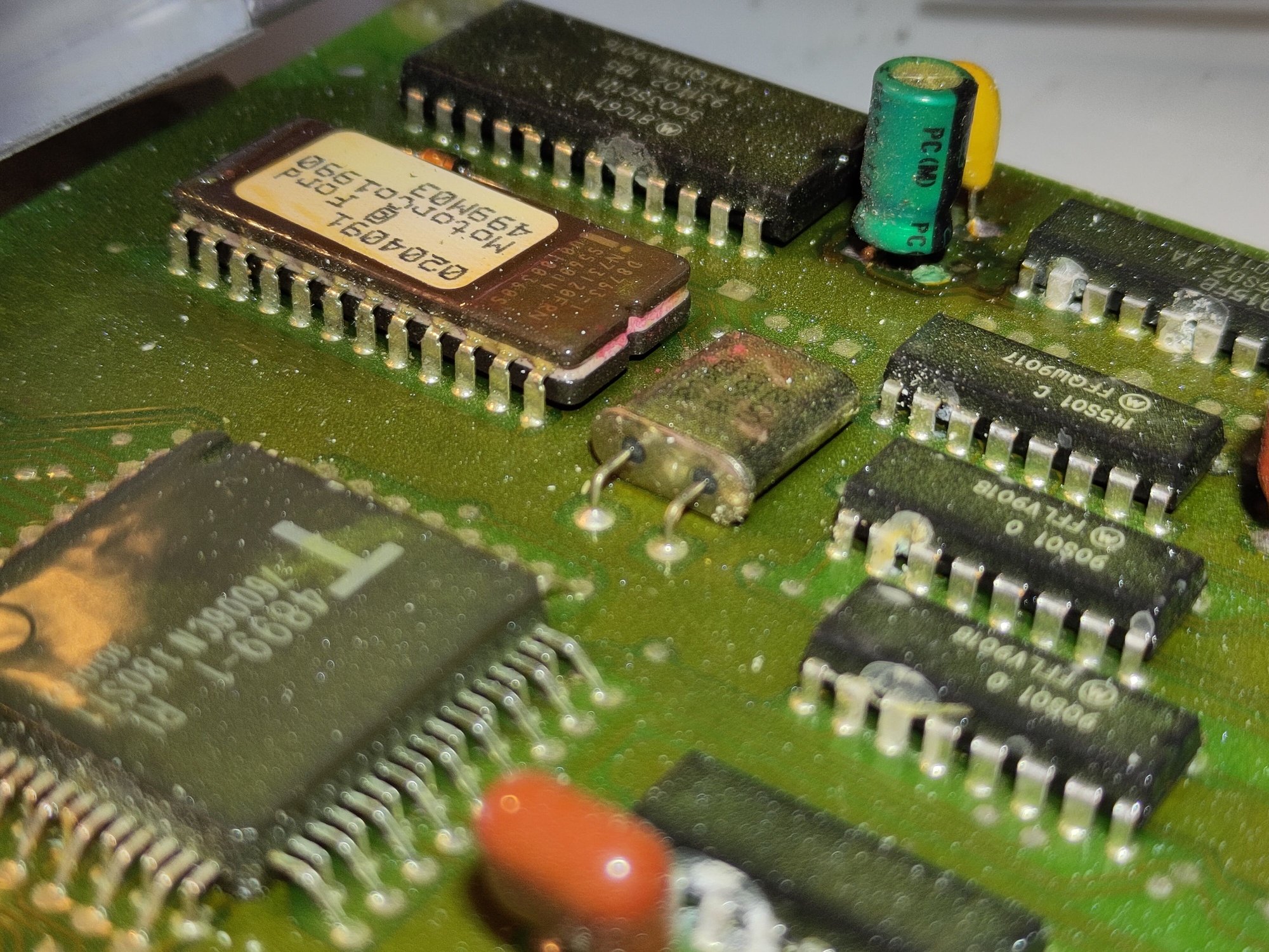

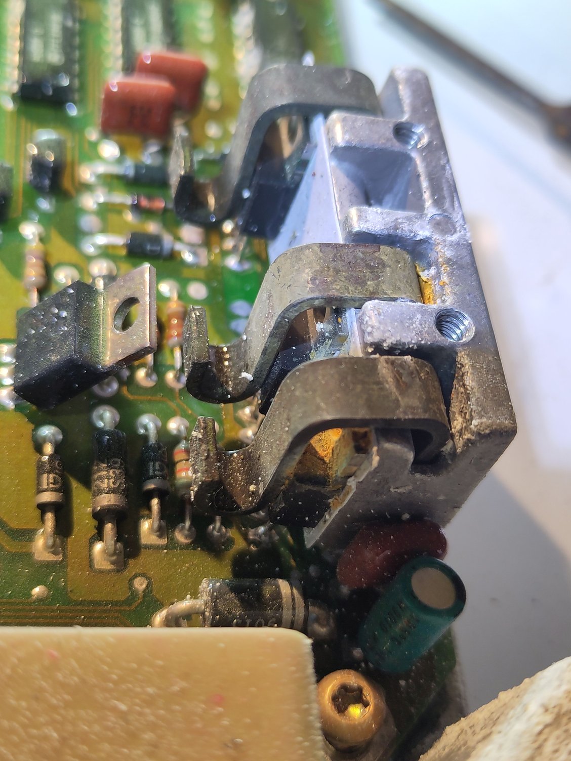

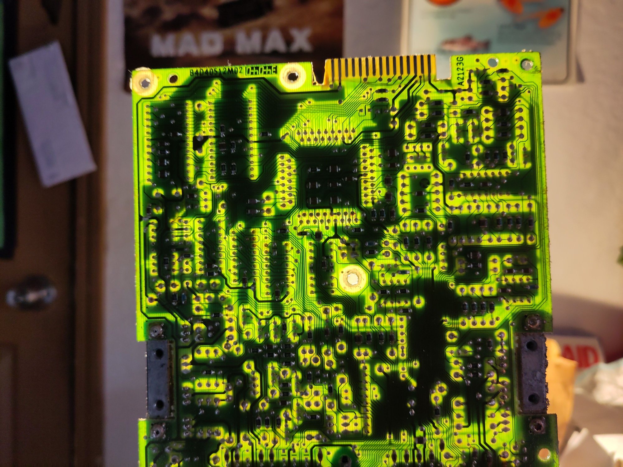

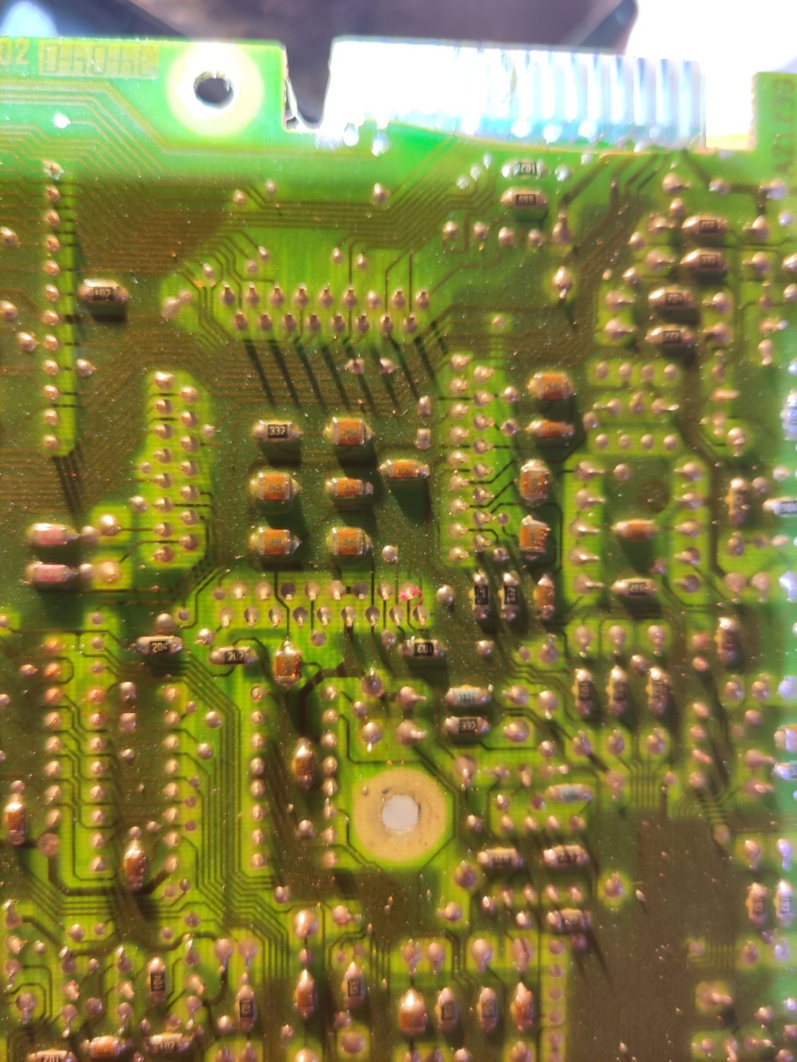

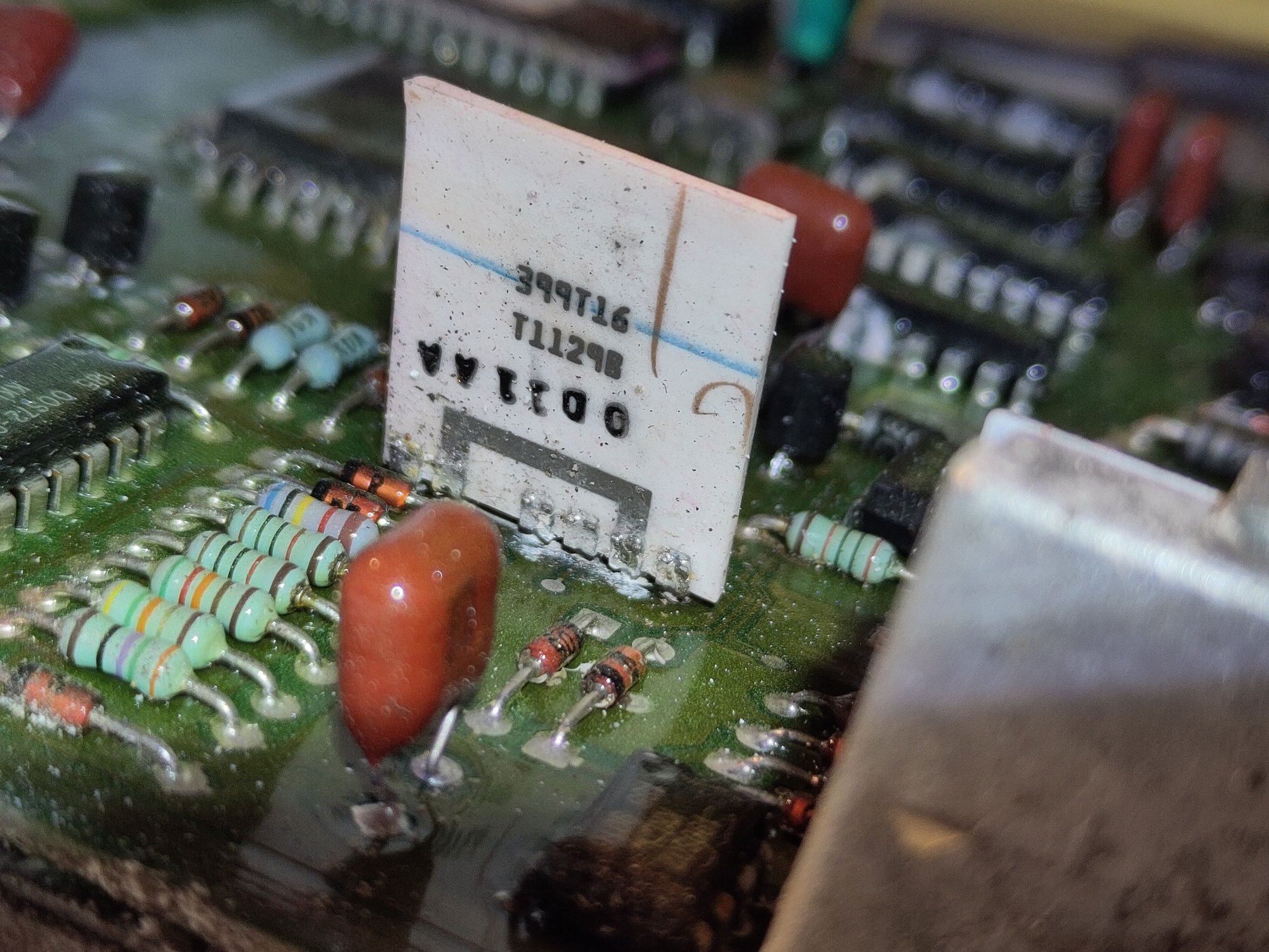

First time poster long time stalker, sorry if this isn't the correct thread but I'm desperate. Is this ECM problematic looking? 1987 F150 4.9 manual transmission.

It looks like that truck or the ECM was under water as there is a lot of badness in there.
Yes get new one check with the local parts stores with the trucks info, may need the VIN and the number off the ECM and see what they got.

Although I have plowed through some puddles, the West Coast salty air is probably the culprit here.

It may or may not be the problem but from what I see that is where I would start as all that green stuff and dirt, etc. cant be good
