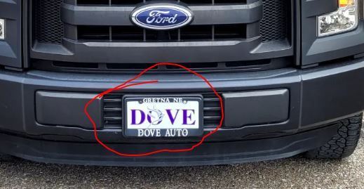

If it were an Ecoboost, the front bumper would have an opening in the middle of the bumper for the intercooler.

he told me it was an addon upgrade to this truck. does that seem to track at all?
the only way im will know for sure is to go check the engine....

used car salesman/dealer, all the same thing......
is this an echoboost bumper?
