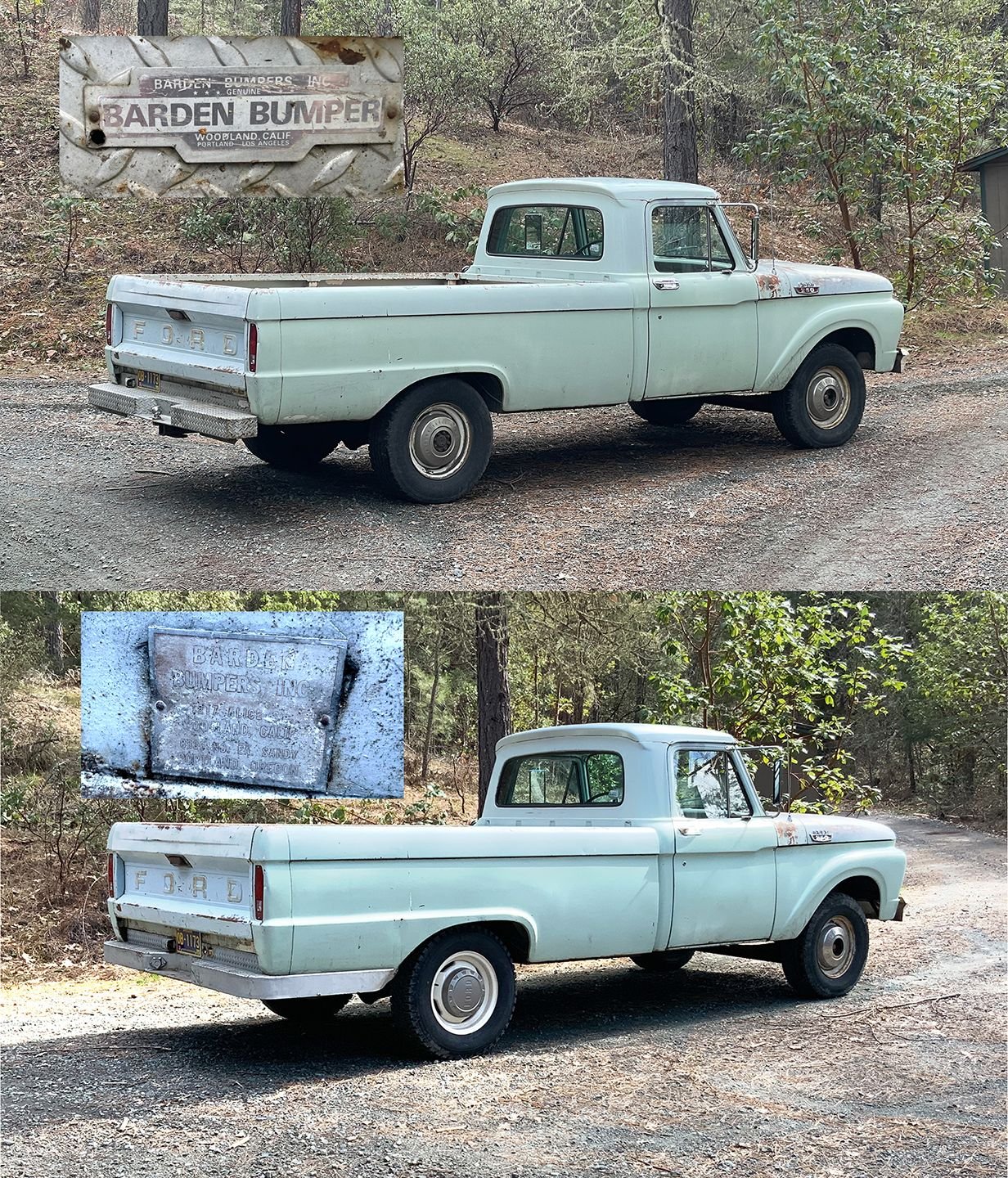

The style of bumper you have on there now with the steps just on the outside was to allow someone to disconnect the tailgate straps and drop the bumper down so it hung vertical and then you could shovel dirt or gravel, etc without it getting jammed up on top of the bumper or stuck between the box and the gate. I had a 67-72 non wraping bumper on my 64 for a bit but went to the full wrapping one instead. I used some aluminum binder post bolts to hold it to the rear sheetmetal behind the wheels. If The bumper gets hit from behind the binder posts should fail before the sheet metal gets damaged.... At least thats my theory, lol. Rear dealer installed bumpers were kind of a regional thing stylistically, it seems. The biggest manufacturer on the west coast back in the day was Barden. Most of the ones I see near me in Oregon are this style.
Barden Bumpers
Barden Bumpers

Thank you!! One, for the great explanation of the odd rear bumper, I always suspected that being "notched" was likely for the reason you mentioned, but I don't think I am likely to ever drop the tailgate and pile soil or gravel in the back of my slick at this point.
Second, thanks for the very clear and concise photo's of the '64-'66 and '67-'72 front bumpers. From that, I think it is safe to say that my bumper is not original and from a later model truck. Maybe I will get lucky and find the correct one.
Last, Great looking '64! What color is that? I really like the rear wrap around bumper, also the fact that it reached the rear wheel arches. Mine are a bit short, but if nothing else, I can use my rear bumper as a templet to fabric one that looks like yours.

Thanks for sharing, I didn't even notice the two tone in the first photo's with the before and after bumper change, I kind of like it as I am personally partial to the two tone paint style. However, my truck is simply Wimbledon White. If and when I can, I will probably keep the White and do a bit of a monochrome look with a black rear bumper bed cover, and wheels, with red accents to play off the red interior.

The two tone is just photoshopped for now, it's actually all green.... I have to do some rust repair in the leading edge of the hood so I figured I will paint it back to the original WW and then go from there to paint the door uppers and the upper bed sides. Someday, that is.... Ive got to finish rewiring it and finish the repaint of the interior. Going back to the original WW in there.
