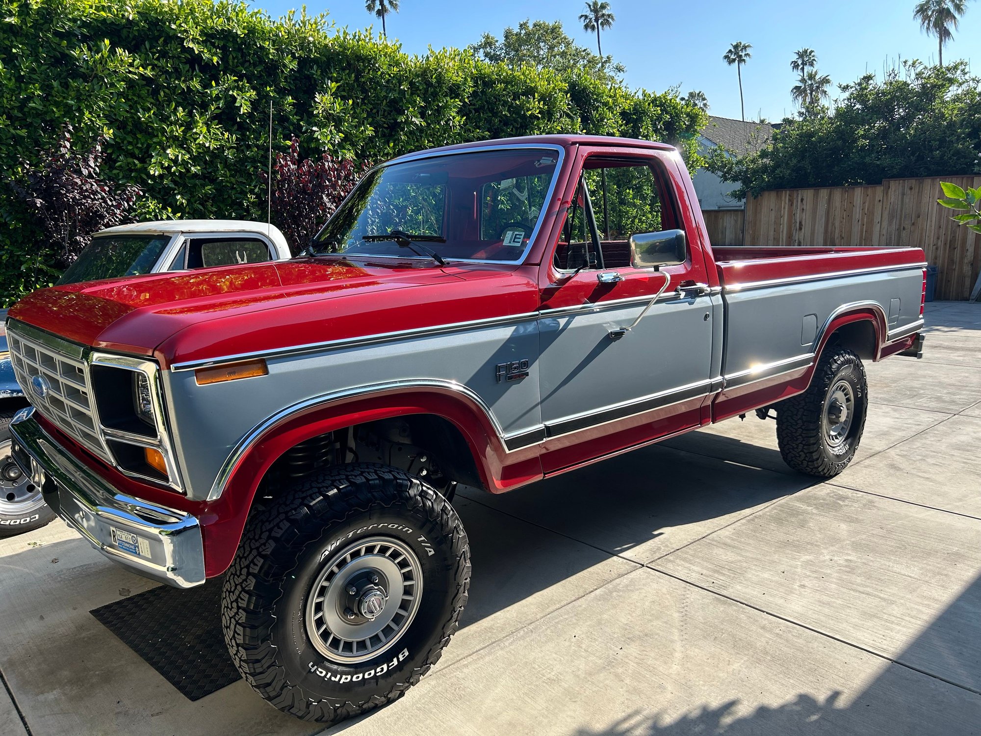

I have a 1983 Ford F150 with 83,000 miles on it. It’s damn near cherry and I will never sell it so I don’t care to keep it all original bone stock. I’ve lifted it 3 inches and exhaust, but I drive it to my cabin in the mountains and it’s slow as ****. I’m not expecting it to be fast, but I’m looking to get more power from that 302. I wanna know what’s best for intake carb headers maybe even a cam. I’m also curious if I’m gonna have issues with the vacuum lines because I believe the transmission has something to do with the vacuum line. Yes I’m in California so smogging is an issue although I got people and hopefully Jay Leno’s law passes. What do you recommend?

First of all stunning truck!!! Did you just get it? As for power. Have you gotten a baseline yet? Make sure its solid, not tired, and running as it should before jumpping in. I really dont know what mods your allowed, but is the motor is solid, and healthy you cant beat a cam/intake/carb/and head swap. That era heads were real bad for power. even later era stock E7's were a huge step up. Keep any mods inline with your use. Mild cam and heads, small carb, and intake. Keep that power band low.

Being you have a look over and sniffer smog test any mods will be tuff if they are not CARB cert.
Then tires do not look like stock size they look larger and add to it a 3.08 gear ratio the truck may had I can see it being a dog or as you say "slow".
You did not post the transmission you have and O am pretty sure they did not use AOD in a 4x4 but maybe a SROD that has over drive?
If it dose have over drive I can see it being a bigger dog then.
You can do a gear swap front & rear to say 4.10 / 4.11 then add a Gear Vender over drive to the transfer case, can only be used in 4x2 mod.
You get the power back before the larger tires and even then some, have over drive and you can split the gears above 20 MPH.
I did a gear swap for think 3.08 to 4.11 on a full size K5 Blazer with a diesel. I also went from a 235 / 75 / 15 tires to 10.50 / 15 and with the gear change was better than when it was new.
