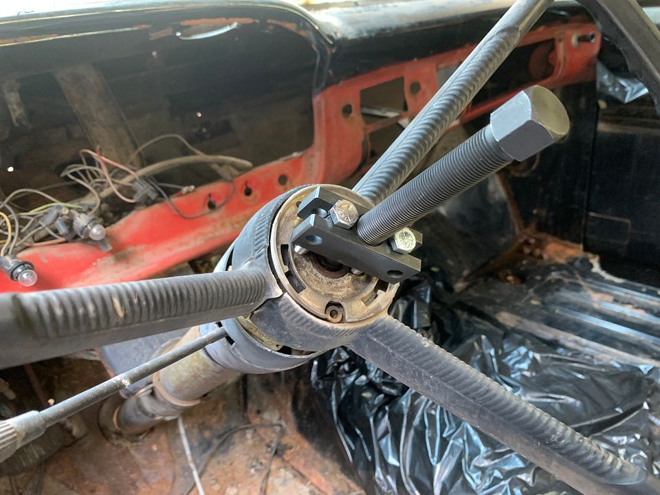

Sort of surprising the alignment place didn't see to that detail, but it should be possible to remove the horn ring or button, remove the nut that holds the wheel on and pull the steering wheel - typically with a puller similar to the first picture. Re-clock to center, put the nut on and torque to specification. Put the horn button back on.
The splines on the steering shaft allow the wheel to be put on in any position around the clock one spline at a time.
