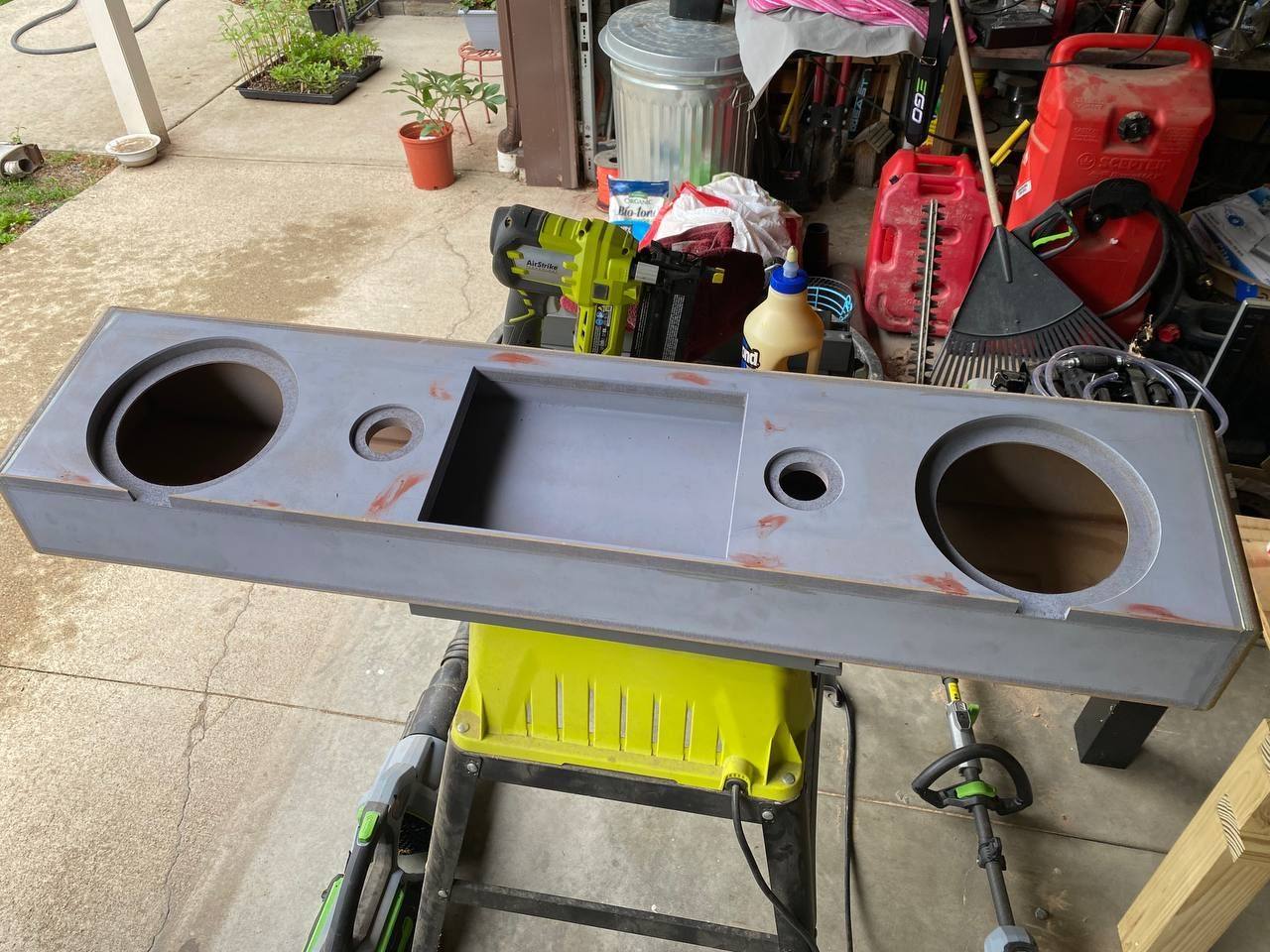

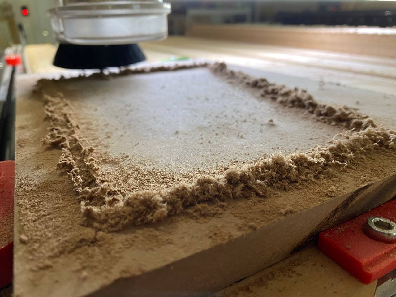

A buddy with a sweeeet work truck asked if I could throw some bump in that backseat.
Finished the box.

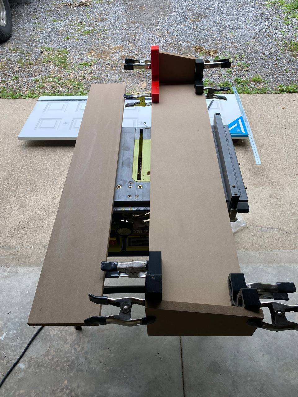

3/4 MDF
3/4 MDF

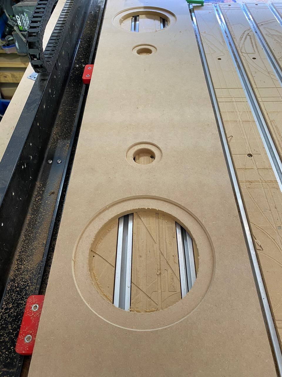

Shapeoko 5 Pro
Shapeoko 5 Pro

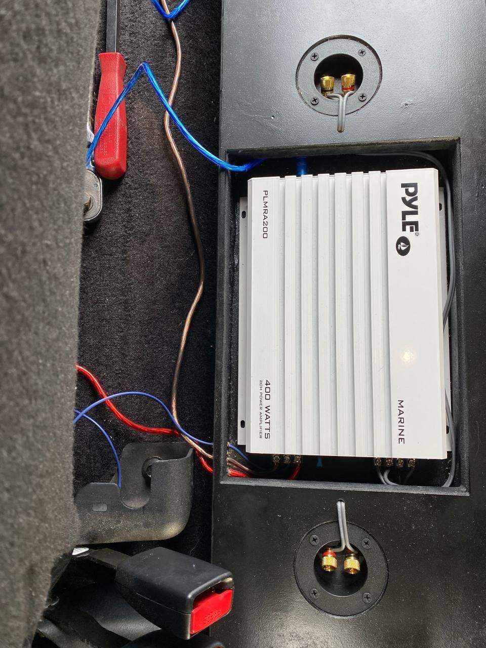

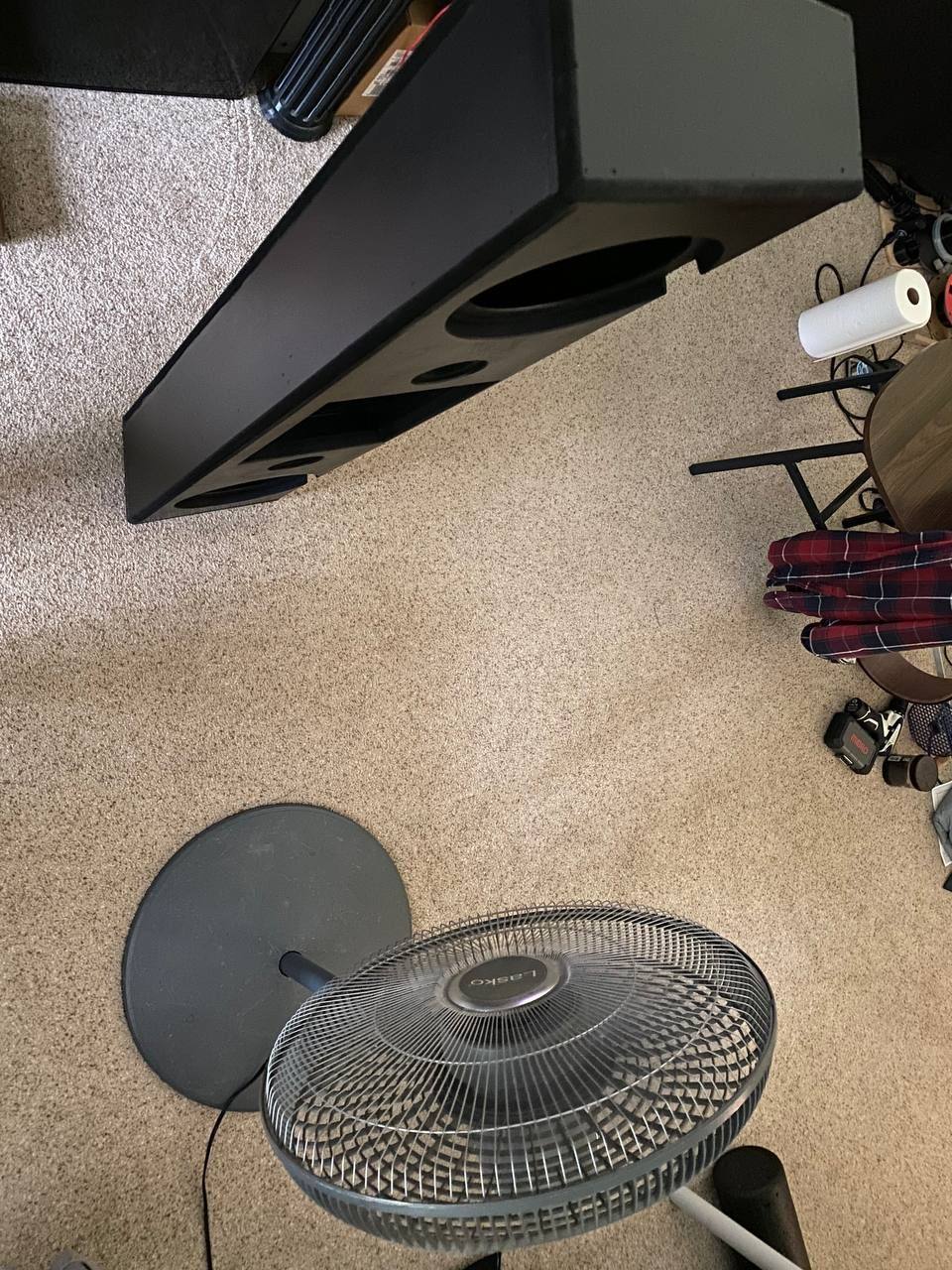

Amp Rack recessed with jacks and subs. Going flush, up firing.

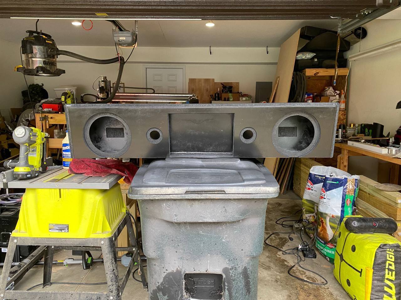

Yes, that's a shop vac mounted to my ceiling...
Rain and 55 degrees make finish curing so fun.

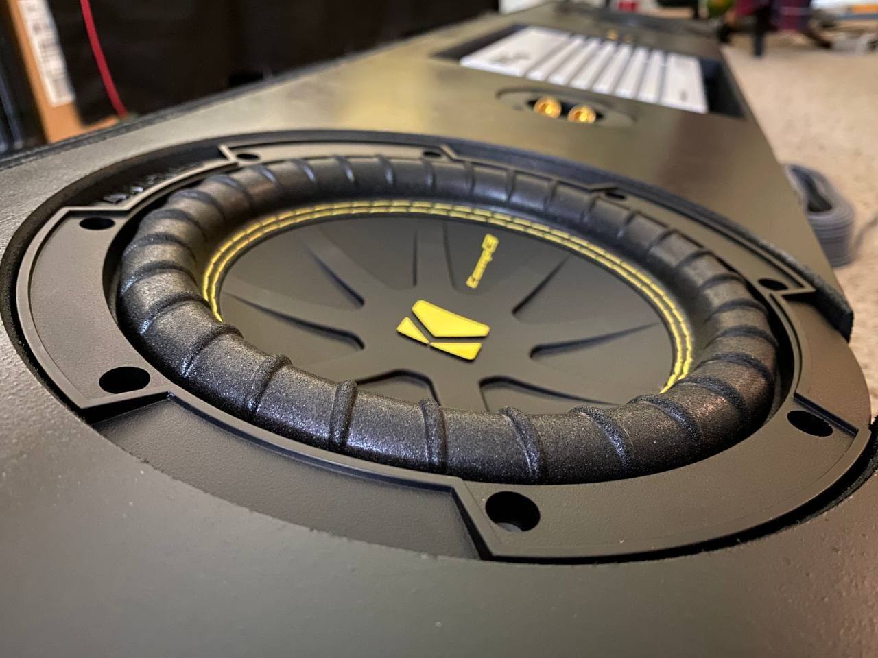

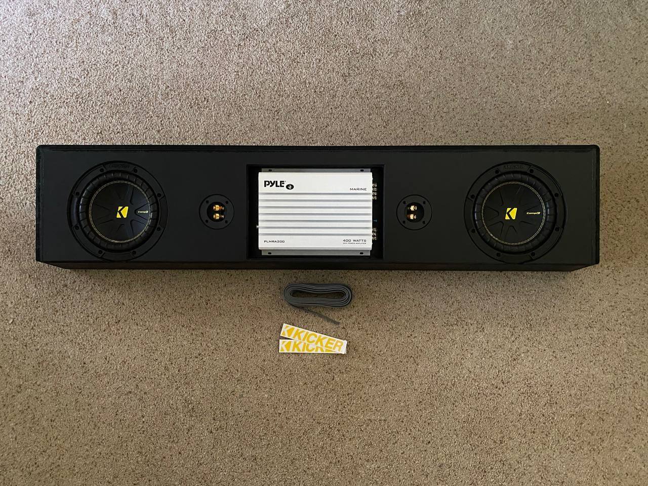

2x 8
2x 8" Kicker Comp C / Pyle Hydra 400w 2ch mono
Nice and flush.
Nice and flush.

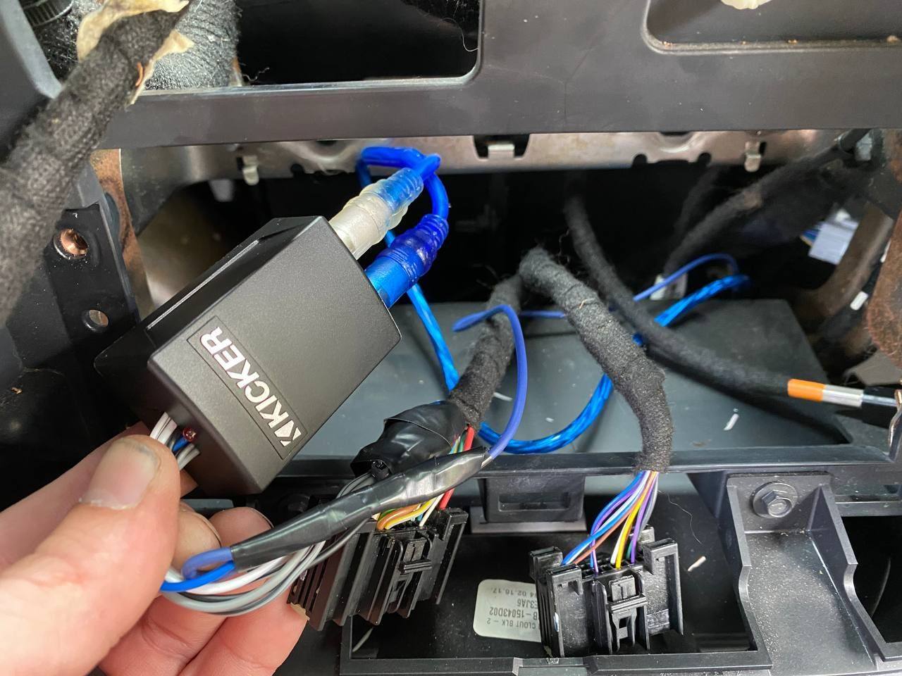

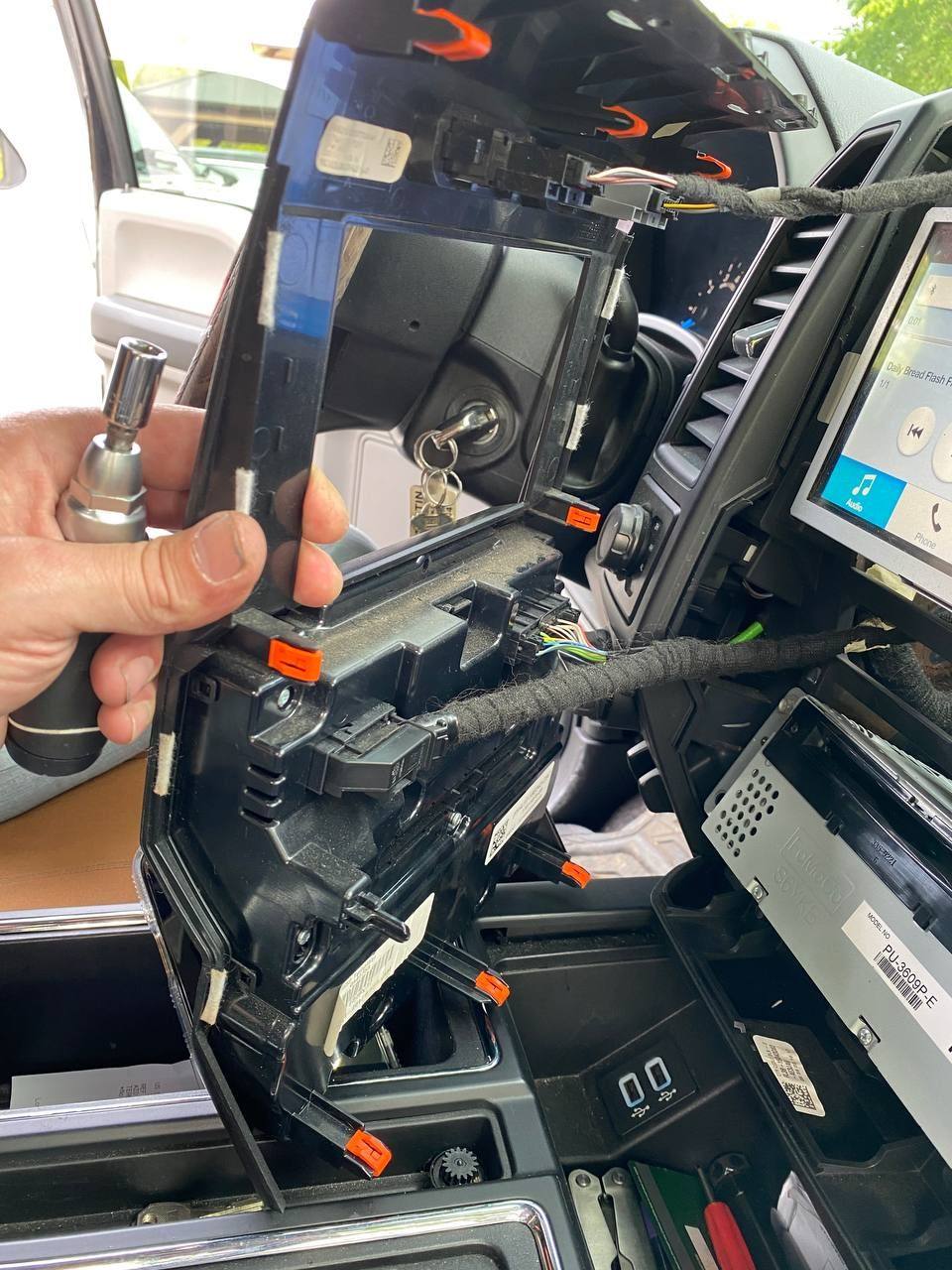

This install does not have that center mount speaker on the dash, nor a factory amp. Tied the line out converter into the stereo (CD player) harness. I didn't take any photos while soldering, as it was already a tight fit...didn't want to burn anything. I did however get some good pictures of the process.

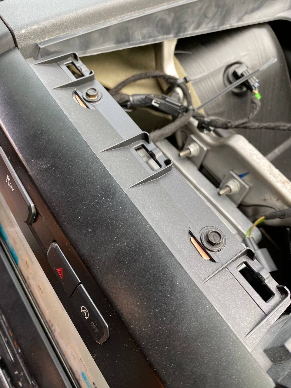

3 clips in front, 2 screws towards the windshield. For the top tray. Totally spaced on that picture apparently.
The faceplate has 8 clips, a firm tug at the top will release it. There are 2 screws on top (previous picture)

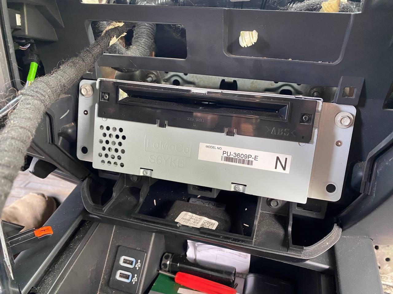

4 screws for the CD player. All are 9/32.

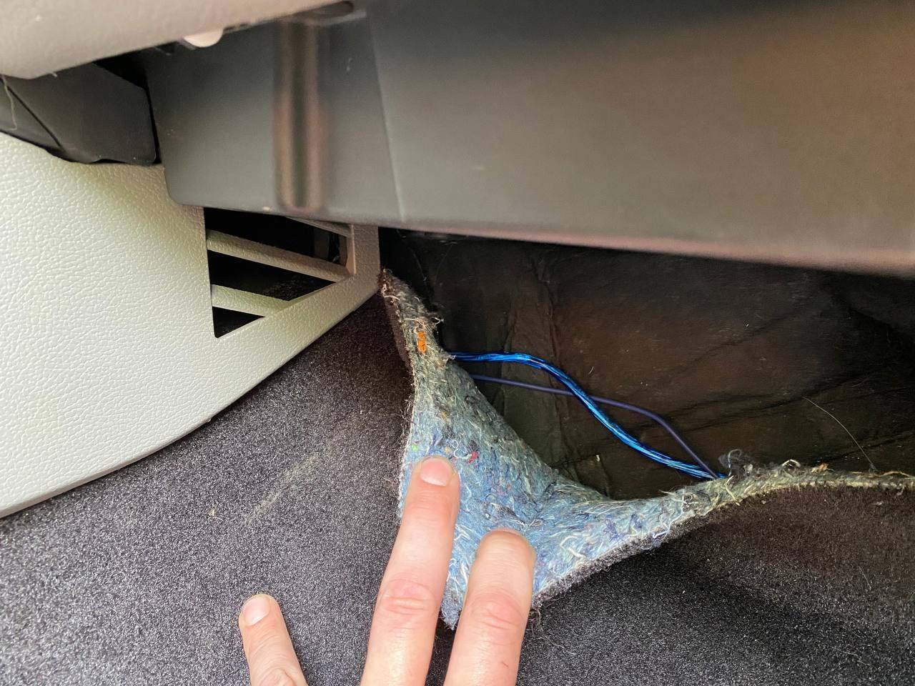

I tied into the front speakers, ground, and ran the remote with the RCA.
Very easy to fish on the passenger side near the center console trim. Pretty nice gap.

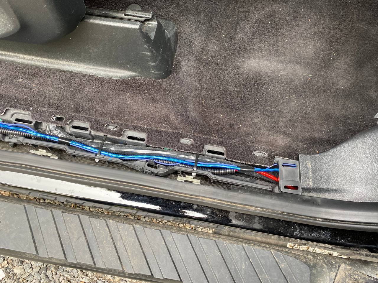

The wires tuck very nicely under the door trim.
Ran the wires behind the rear seat. Added some pass throughs for power and jacks in hopes to avoid any wires catching on the seat.

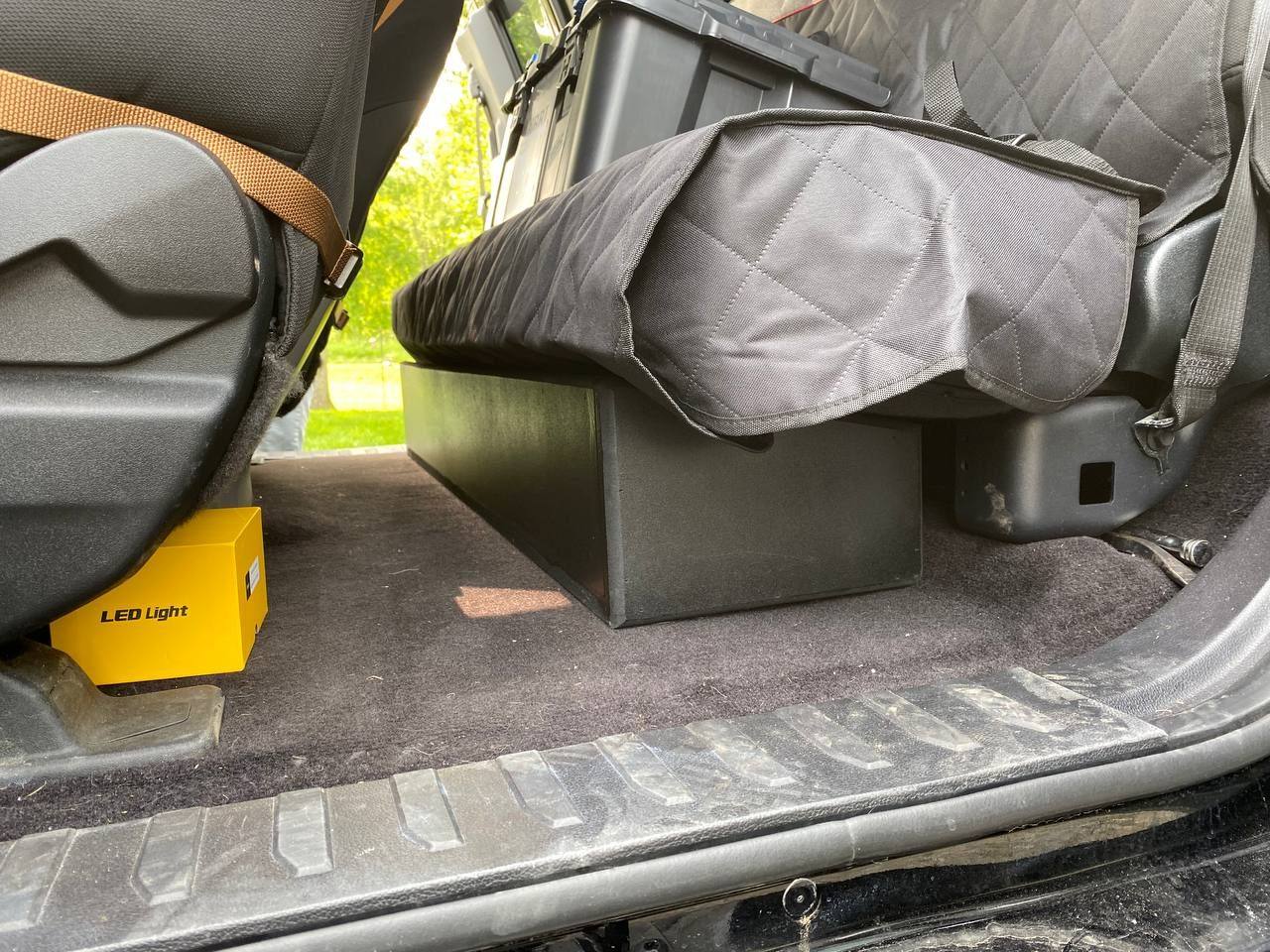

Perfect fit, with about an inch to spare above the box.

When you pull the CD player, you want the larger plug towards the drivers side. Obviously this needs to be done with caution, as you are modifying the stock harness. Take your time and you'll get it. Easy install with a buddy. Only took us about 3 hours, and we took a pizza break.
Left Front +: White Wire
Left Front -:White/Brown
Right Front +: White/Purple
Right Front -: White/Orange
Ground: Black
