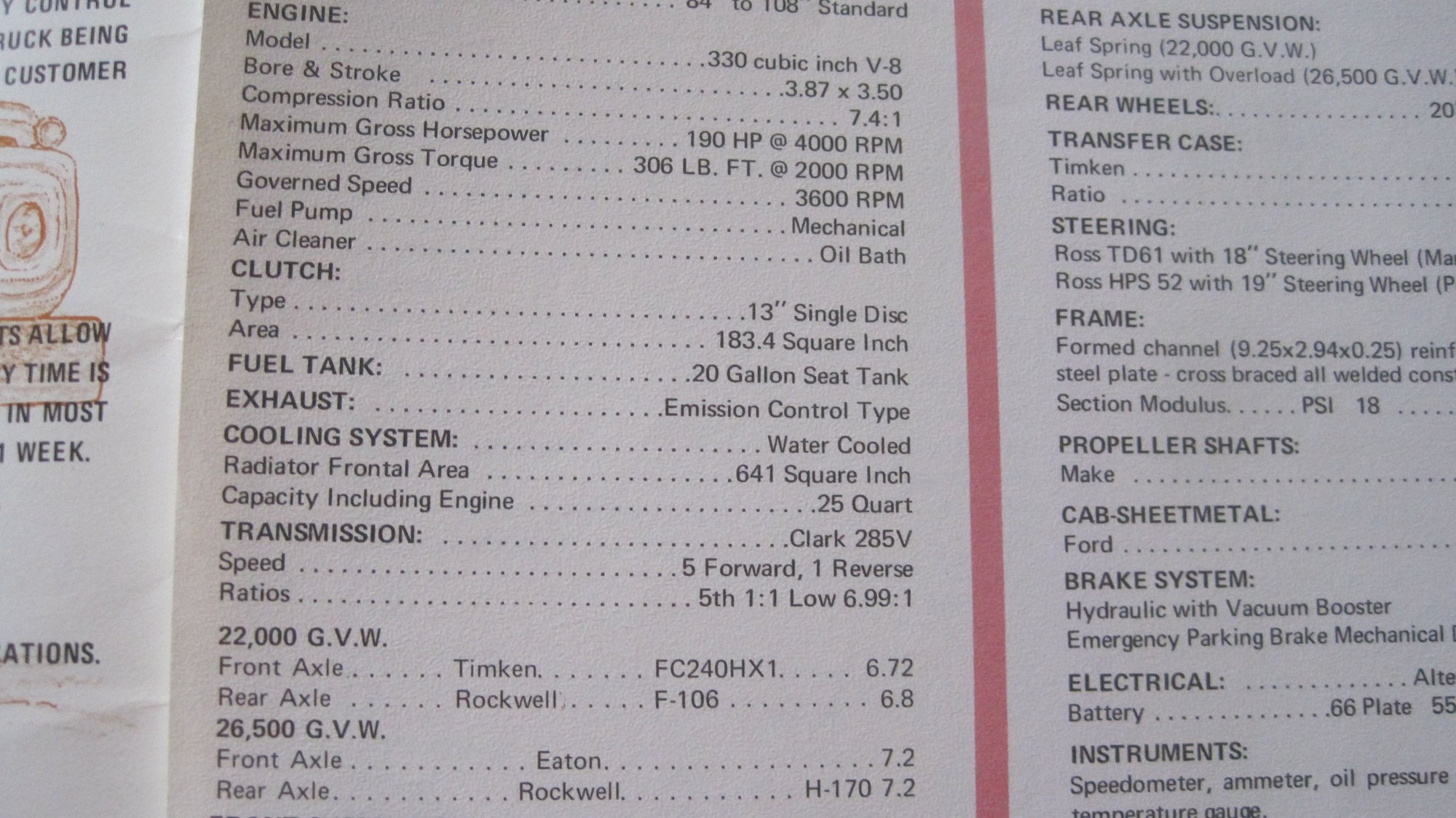

Old May 25, 2025 | 08:47 PM
tripleframe's Avatar
tripleframe
Joined: Oct 2011
Posts: 2,217
Likes: 647
Many conversion companies specified more durable Clark transmissions and Timken transfer cases(top) Ford 4x4 specs with Warner T 19 and Rockwell T 223 (below)
Old May 27, 2025 | 07:46 AM
Randretti's Avatar
Randretti
6th Gear
Joined: May 2025
Posts: 6
Awesome information!! thanks a bunch!
