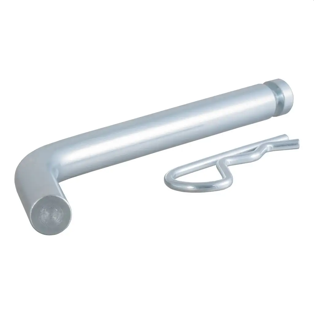

Originally Posted by Strider250
Also get a straight hitch pin like this one from etrailer, https://www.etrailer.com/Hitch-Pins-...25-GH-099.html and do not use the commonly provided j pin. J pins tend to elongate the hole on your trucks hitch over time.
I have a straight pin I'm using, but what is a "J" pin (never heard that term before).

This is the type I use. The picture is of a Curt Heavy-Duty 5/8" Hitch Pin with Groove (2-1/2" or 3" Receiver, Zinc) #21507. I just bought the Curt pin for one of my other hitches. I also use the Ford pin that came with my truck. The only time my receiver hitch has been goobered up was when I used the J pin with two sleeves so I could use a 2" WDH shank. Once I switched to a 3" WDH shank there was no further damage to the receiver.
If you have a 3" receiver, make sure you get the right pin. Most pins aren't long enough to fit the 3" receiver.

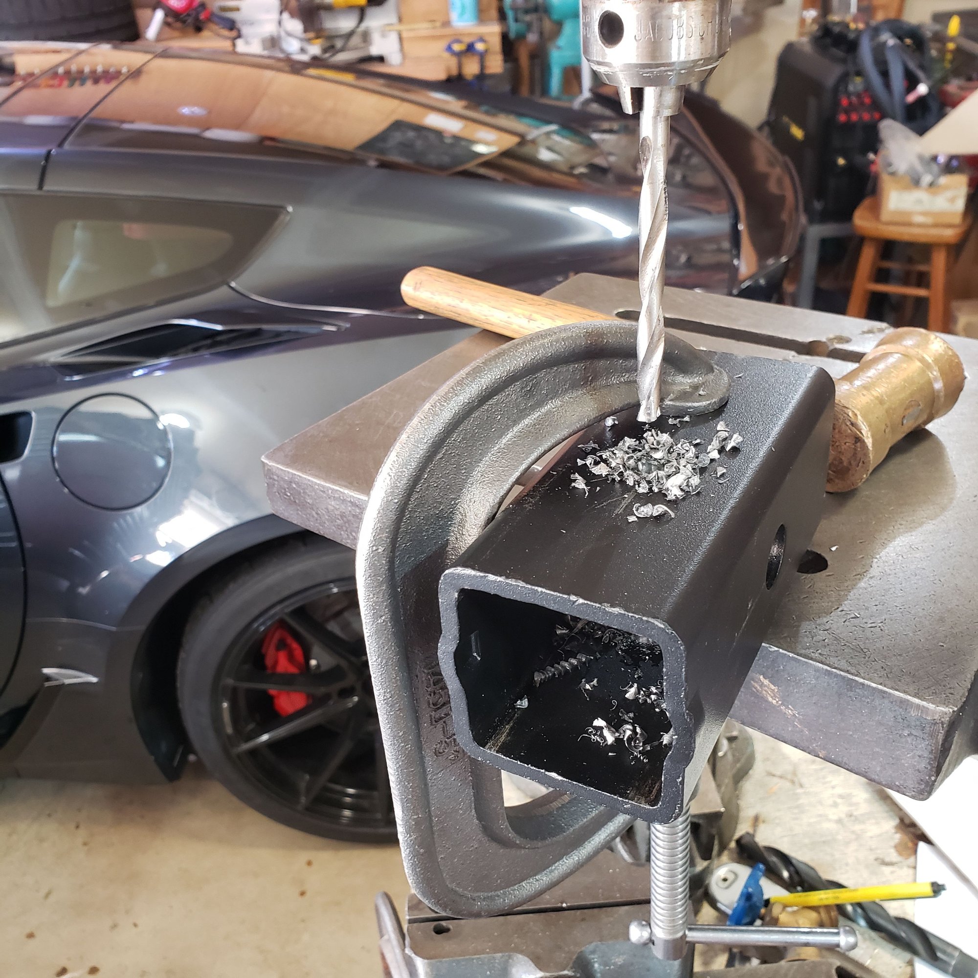

I bought a Curt at the local farm supply store. It has a couple stops swaged into one end. Unfortunately, when shoved all the way in to the stops, the holes don't line up. I marked the sleeve when it was all the way in and redrilled it so the holes lined up.
