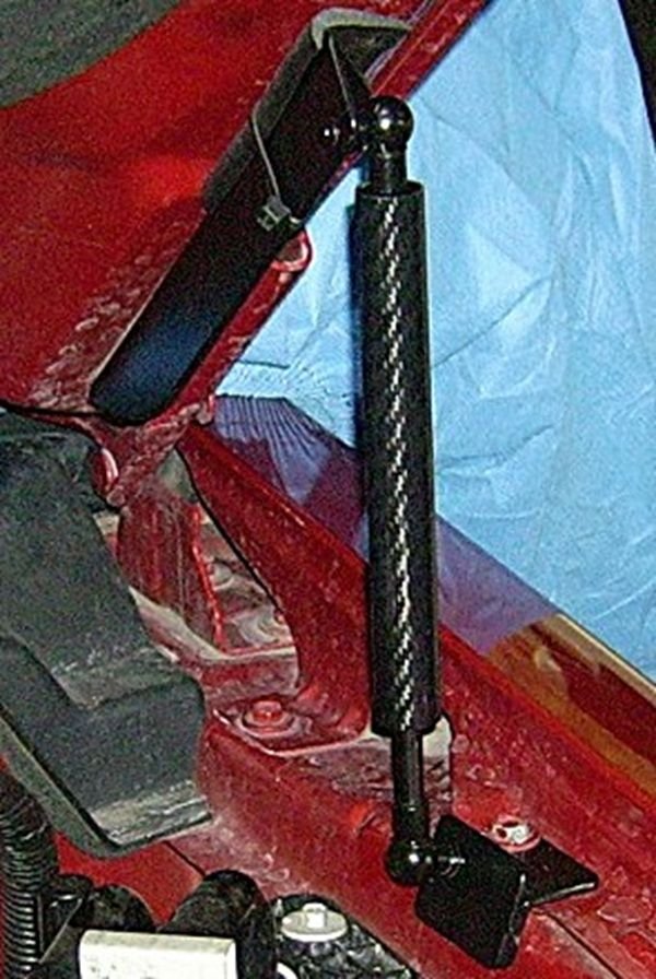

This is not a truck, it is a Mustang, but my guess is you're looking for a similar deal, but maybe 2X in scale. Pardon the dust.
Much lighter hood, lighter hinges, I only added the lifts in a kit. It originally used just a prop rod.
