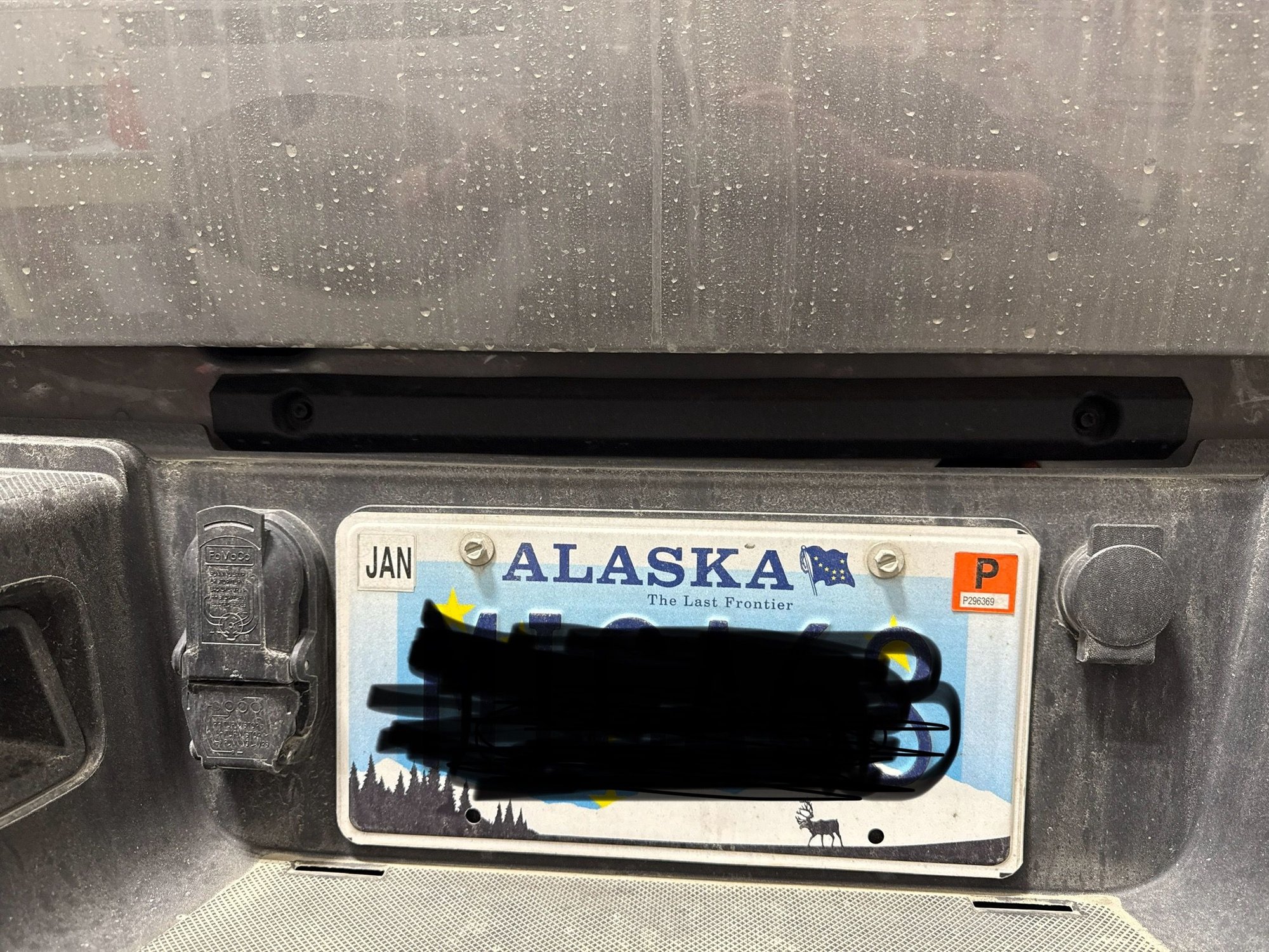

Before installing a light bar at the rear of the bed in the gap between the bumper and the bottom of the tailgate - I find this critter. Removeable? What is it?

That’s just a plastic block they put in place where the light bar goes for trucks that dont get it. There is a hole for the wiring behind it covers up. Throw it away/

Or just leave it. Its for the dually, I guess the bed pan uses the same stamps across the board.

he’s putting in the light.

Or turn it into a running light/brake light!

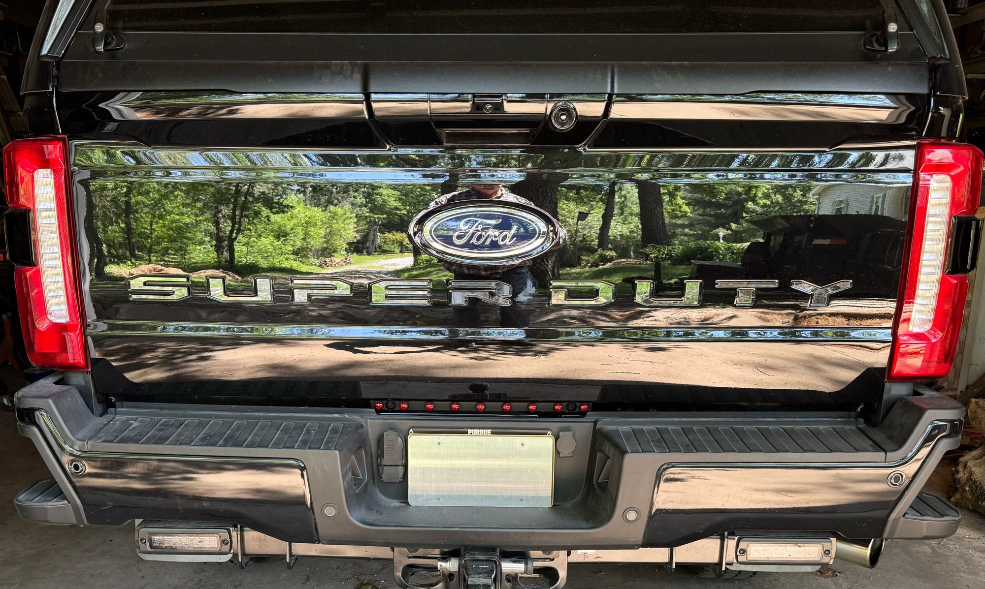

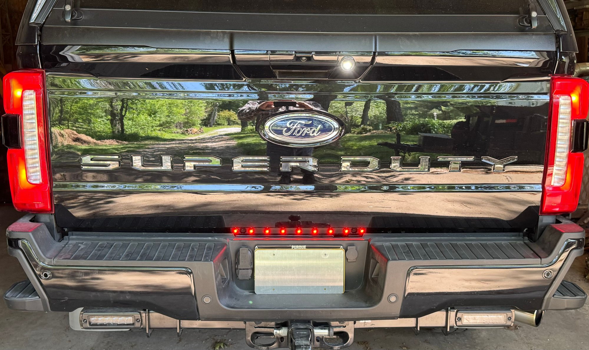

I did this and it took 5 minutes. I bought the oem light off ebay and bought the harness you need here.
https://limitlessautoworksllc.com/pr...b22075d3&_ss=r
There is a plug about in the center up behind the spare tire right near where the hole for this light is. You unplug the harness and plug this harness between the 2 oem plugs and it has a plug that goes to the light. Super easy.
