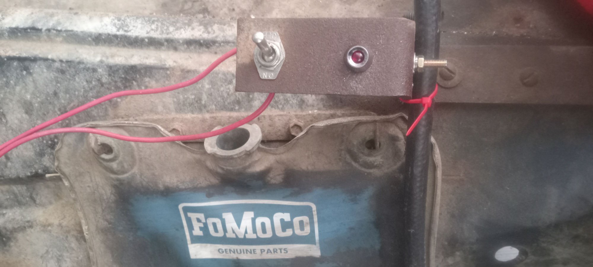

Updates: Engine Runs, no exhaust smoke.
352 2V running for 15-30 sec on fuel. Fuel pump picking up fuel. Rebuild kit will fix carburetor.
https://youtube.com/shorts/dDmf3JNCWNc?si=xyKVlsVi4_ilJhAw
Ordered a new ignition switch as well.

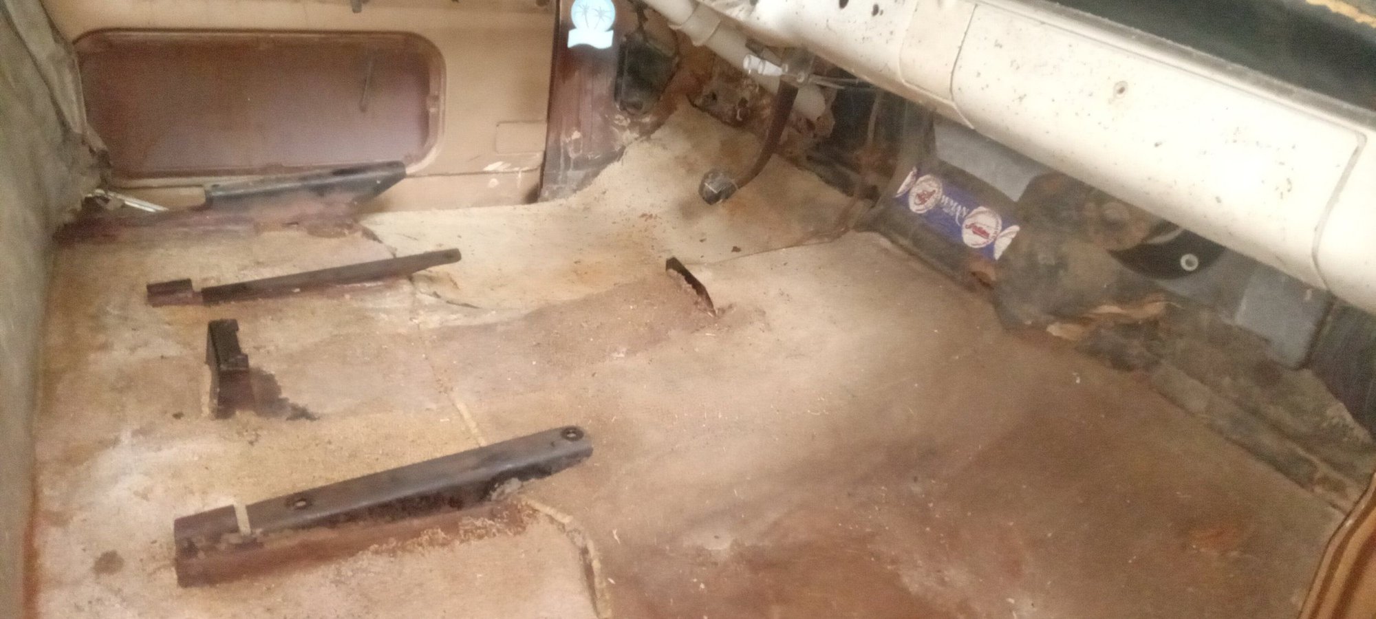

Floors
Originally Posted by g4g2g7
can you share some pics of the floors and front cab mounts?
Floors have been patched. Cab supports need attention. It will require a well planned, and complete repair.
Doors close real nice, and locks work with key.

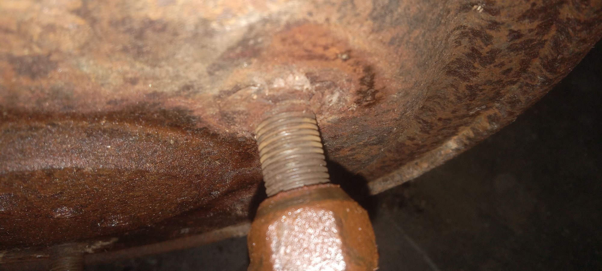

Rolling Now
Sitting in mud froze rear drums.
I removed nasty rusty drums, and at least it rolls, rear end, driveline turns well. One drum still had factory assembly clips on 3 studs.
9in rear end oil level was full.

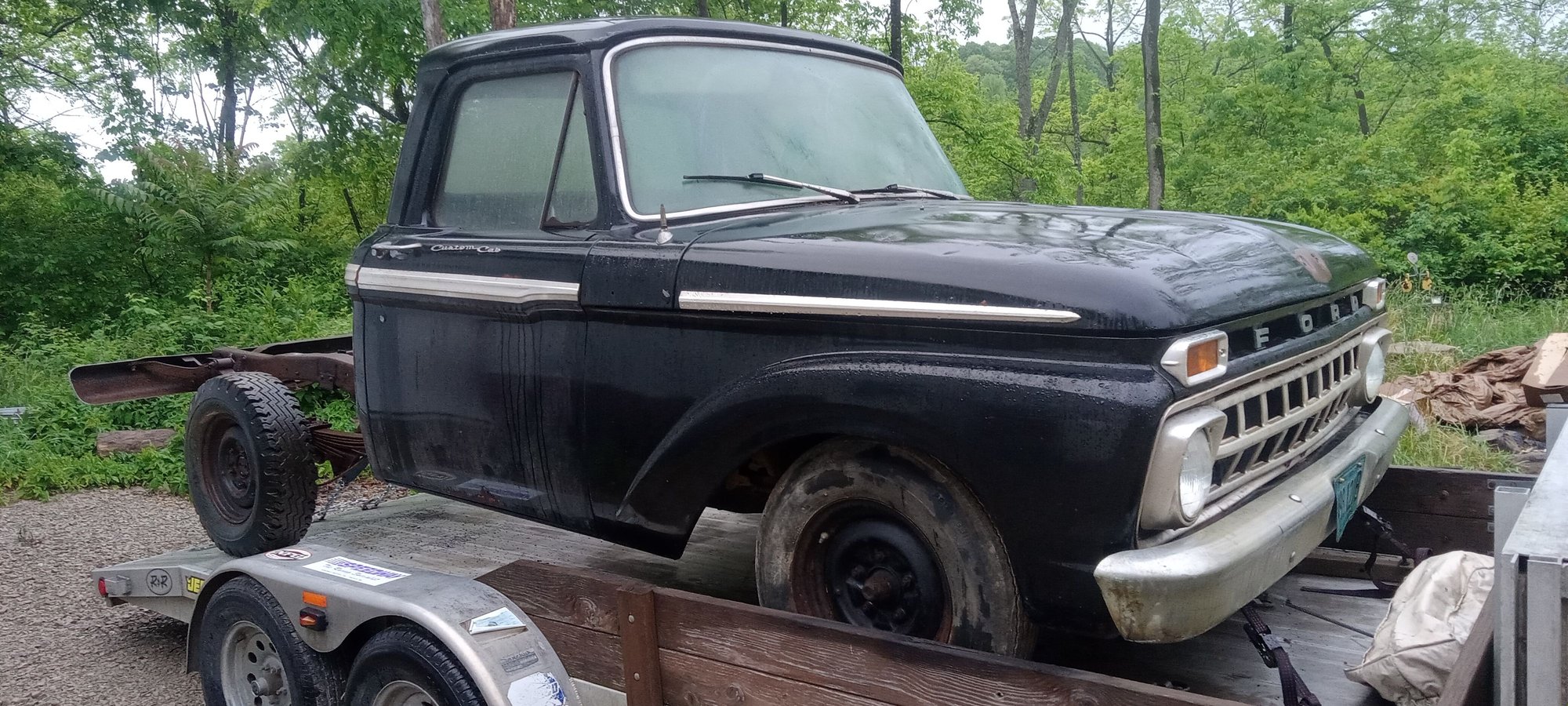

Images on Trailer

Looks like an old ford truck. Now, how about pics of the rust damage? Inside the doors, floor with door open, and a shot from inside the wheel well of the cab mounts is what is required to access the work needed to make it a good old ford truck.
