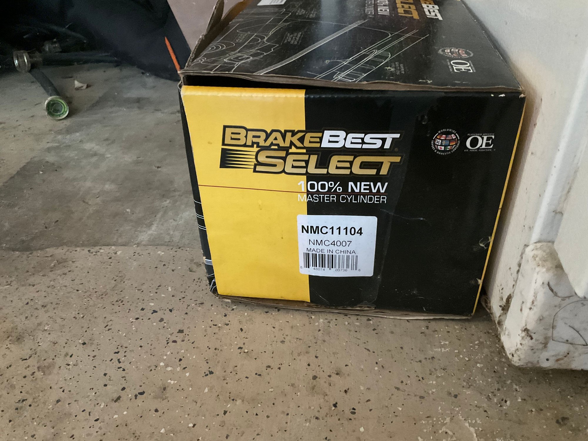

I replaced the new brake best select master cylinder and sticker on box said - made in China ! Returned it today and didn’t realize it cost 75 bucks ! I got fl1a filter and 6 qrts of oil and some spark plus and few other odds and ends and got 17 bucks back.
