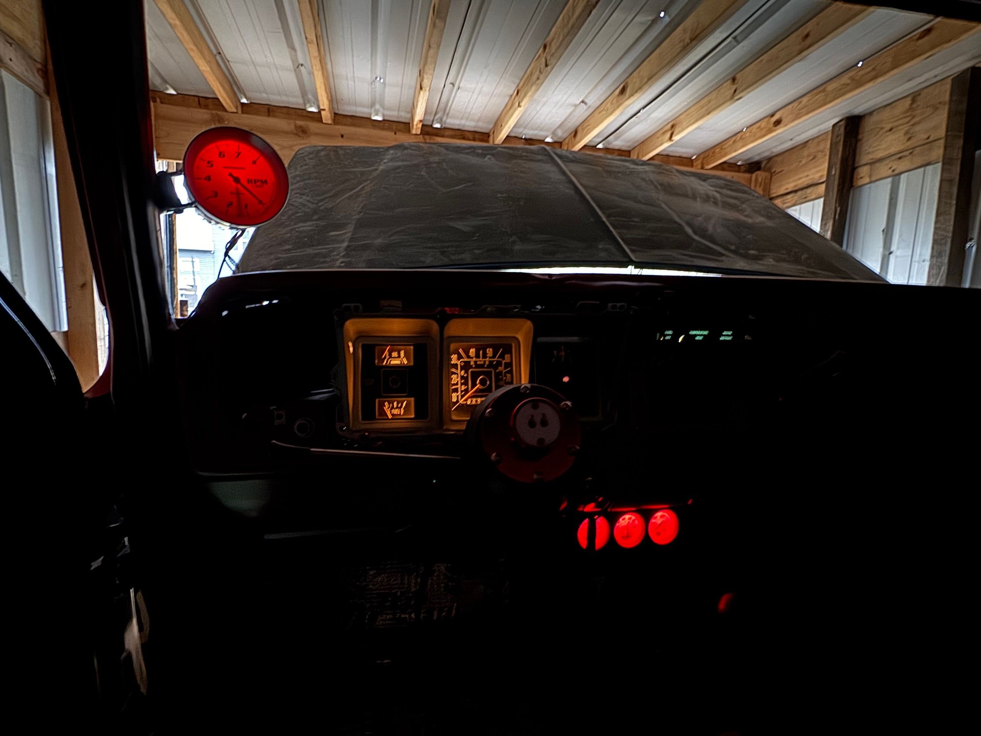

Is there a fix to how this cluster lights up? Like the right side has no power? All new bulbs. Sockets look good. Bent the tabs out to ensure contact….. not that it tremendously matters as I just installed a gauge cluster but would be nice if it lit up……

Clean the PC where the sockets make contact.
Test each & every bulb, even if they are new.
Clean the contacts on the sockets, both the ones that contact the PC & the ones inside the socket that contact the bulb.
Then test each & every socket with the bulb installed. Power to the contacts, make sure the bulb lights.
Make sure that the body of the cluster is not crumbling around where the sockets fit in.
If it is crumbling, the contacts on the sockets won't make good contact with the PC. Cure is to replace the cluster body.
I test the bulbs with a couple of wires & a battery charger.

To add if you are using LED bulbs some only fit is 1 way, try and turn them 180 degrees and see if they work.
