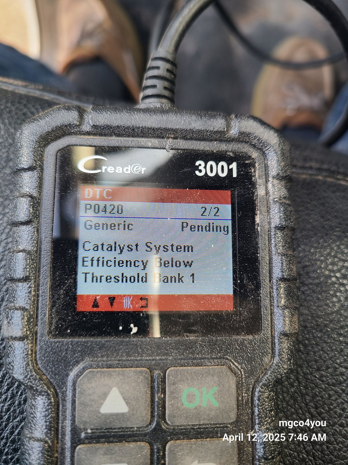

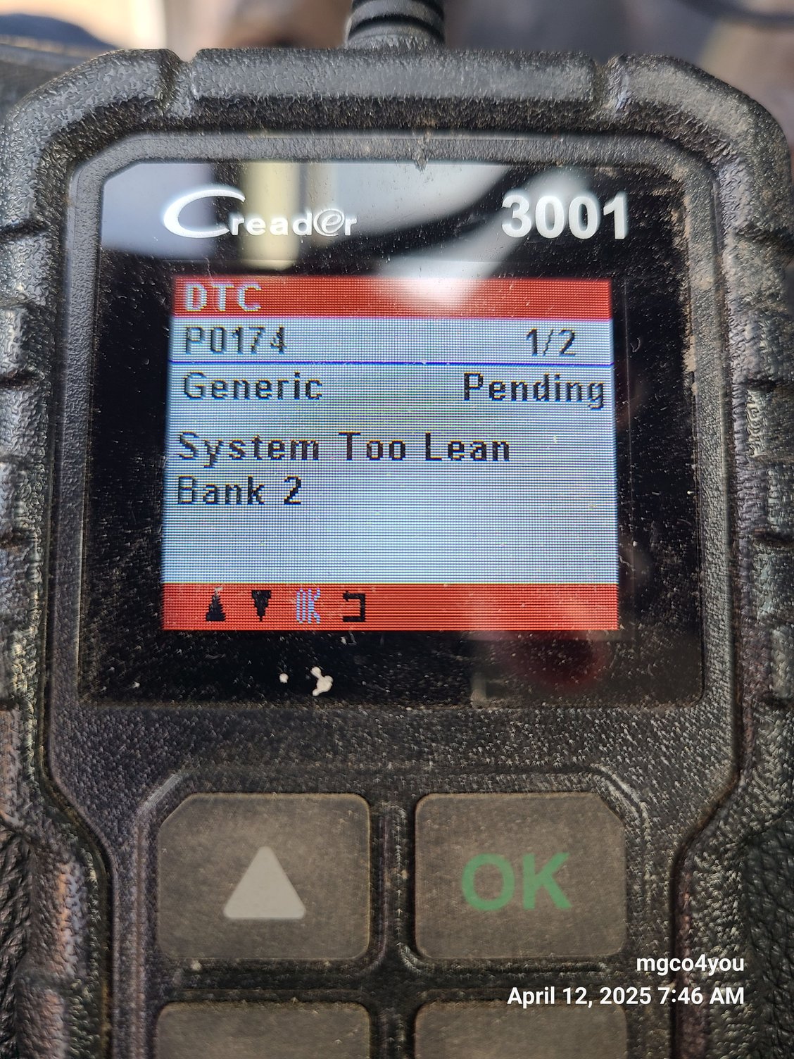

I recently replaced oxygen sensors and converter because the engine will start and run good but quits running after I press the excelerator.
Since then i use the truck for several trips
I don't have CEL but I run diagnosing and came up with a code P0174 and P0420

Not sure why it won't run, but doesn't trip the CEL. Both codes should trip that light pretty quickly.
I've personally found, and research here suggests that the trucks are very picky about catalytic converters. Most aftermarket units won't work. O2 sensors are a little more forgiving, but not by much.
Seems like two separate things on each side. I'd first check for exhaust leaks and loose connections. Something is causing that lean code and it might be the reason the truck won't drive. The Cat efficiency code may be just because the cats are aftermarket.
The only weird thing is that the CEL should be lit and the truck should start and run in closed loop mode. The stalling once you press the accelerator makes me wonder if the new cats (one or both) are plugged somehow??

No choke on a fuel injected engine, but there is a throttle body. Doubt anything if going on there but maybe. The downstream sensors only measure the efficiency of the cats. So they shouldn't affect how the engine runs. I'm still stuck on something wrong with the cats which may be choking the exhaust flow. Seems like its too coincidental to have driving issues and these codes after a new cat install.

I order a new MAF maybe that is the problem?

Problem fixed
OK problem solved there was a small bug 🐛 fried in the MAF sensor, she runs good now
