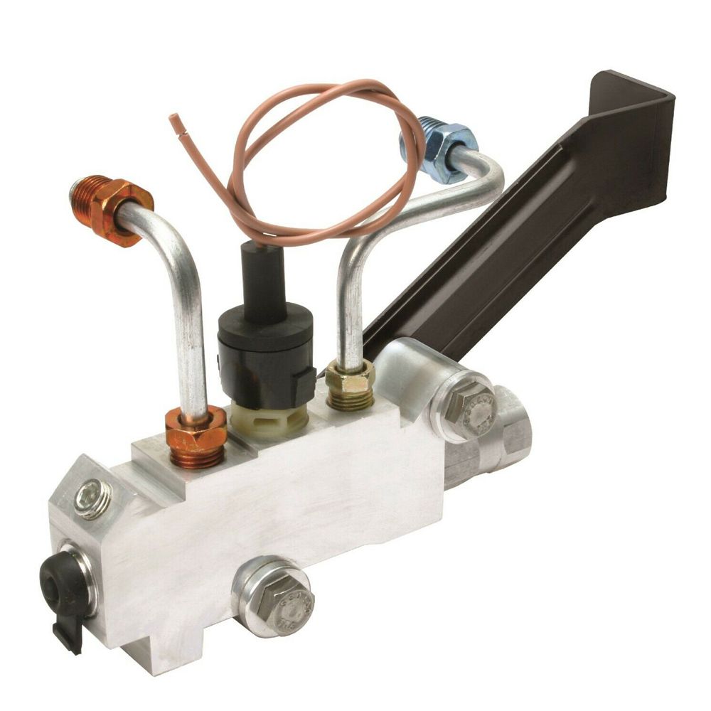

Agree with tubing bender and even then those runs into the MC can be tricky. Mine ain't that great and I should of gotten a pre-bent solution when I did a power disc brake swap. Also maintains your brake pressure switch.
