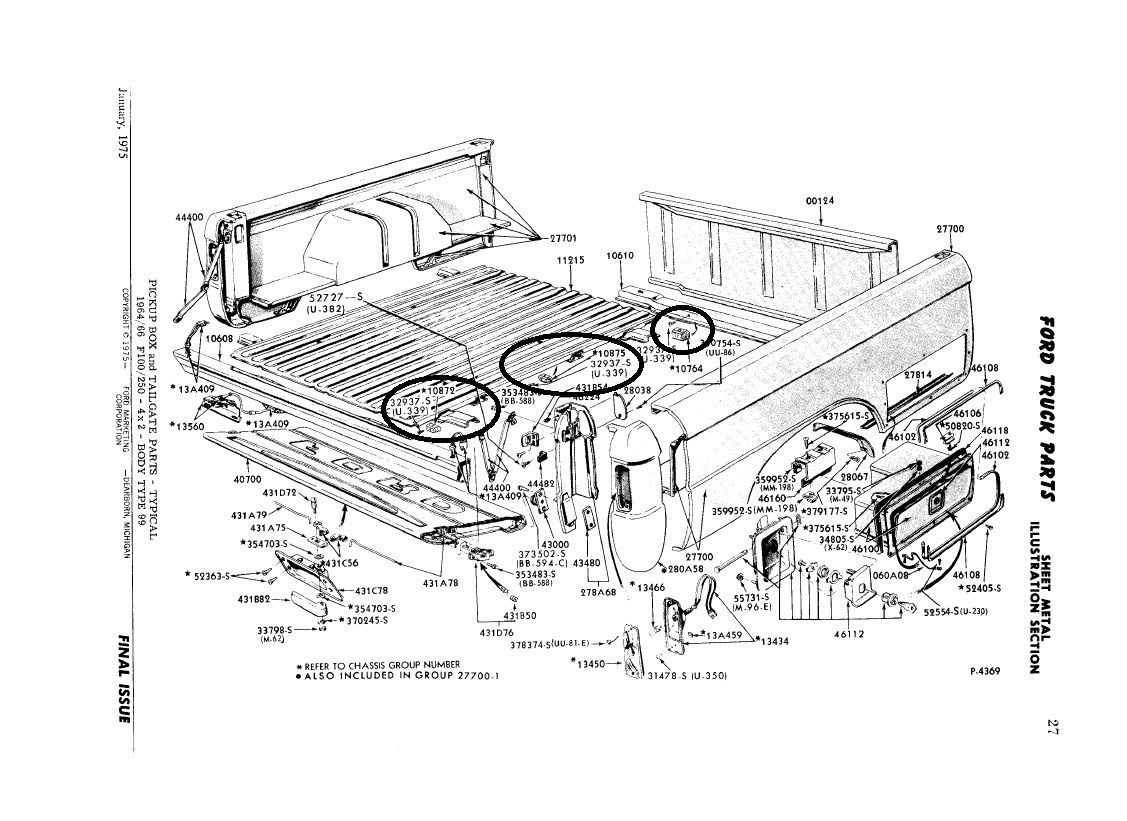

I layed out for cutting my bedside to install the box. I used this drawing, from a previous thread:
I have a question for anyone who’s installed a toolbox in a previously uncut bedside. Making the hole using the above drawing requires totally removing one of the bedside braces, no way around that. Using the factory bracket and two bolts that secure the box to the bed floor , does it make up for stability lost in removing the brace? Thanks.

Originally Posted by ibuzzard
I have a question for anyone who’s installed a toolbox in a previously uncut bedside. Making the hole using the above drawing requires totally removing one of the bedside braces, no way around that. Using the factory bracket and two bolts that secure the box to the bed floor, does it make up for stability lost in removing the brace? Thanks.
Sort of. One other thing they did at the factory was added a reinforcement piece below the opening. In the drawing if you look at the opening there is a number 27814. There is no complete part number for that piece, so it is an improvise deal if adding a box, but it was a piece of metal the same contour as the piece it reinforced but slightly thicker than the sheet metal - that was welded to the sheet metal below the opening adding stiffening to that lower part of the panel. It was longer than the opening - essentially spanning to the rear wheel opening.

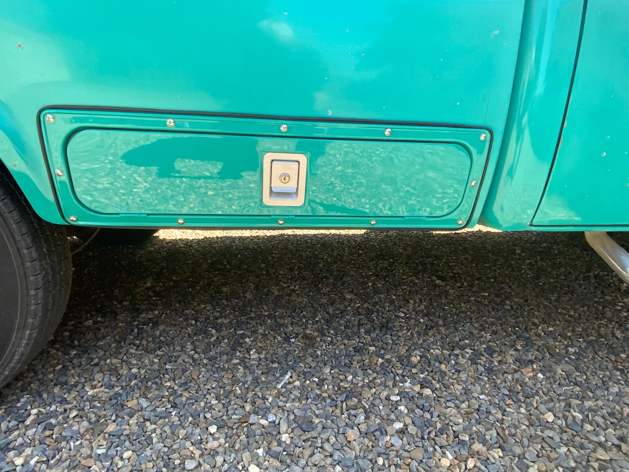

Very happy with the way my restored box looks after install, the local body shop did great. He took the liberty of replacing the oversized bulb seal that seals the door, recommended by another member, with a lower profile/easier sealing rubber seal. They did add a stiffening strip at the bottom, and used stainless hardware to attach to the bedside.

I figured I'd update you with my final result. It's not perfect by any means, but it's a great improvement over the old one. For those interested, I used this from Steel Rubber for the seal.
I had assumed there was a gasket of sorts between the flange of the box and the bedside so I went ahead and got some of this P section rubber from Acme Rubber. It's bloody expensive. It wasn't until I removed the old box I saw they didn't use a gasket at all, just some seam sealer type product. Oh well.
