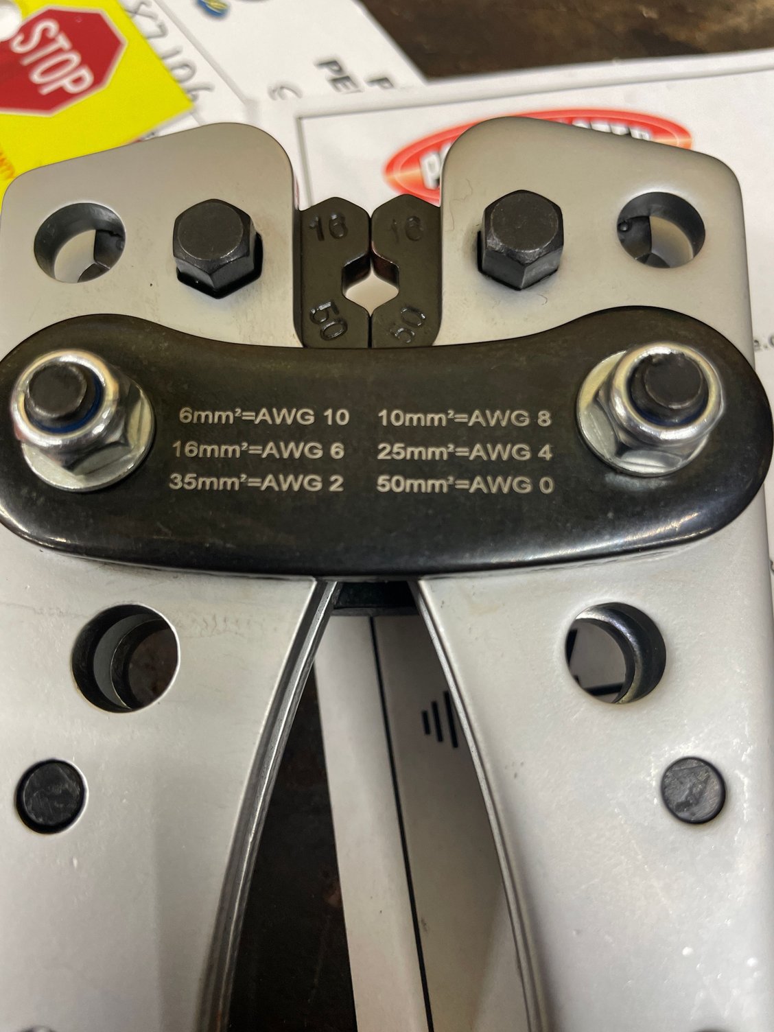

So I’ve got my alternator and 4awg wire. I bought the Sanuke HX-50B to crimp the ends and it doesn’t work for me. Am I doing something wrong. I even watched a couple videos on it.
It just doesn’t crimp tight. I even tried the die for 6awg connectors

So 4 AWG wire is about 21mm2 and so the nearest metric standards of 16mm2 is too small and 25mm2 is too big. Long story short, your dies are not for AWG wire.

Well shoot. They sell it as for my wire size but you makes sense. Good thing about amazon is that returns are easy

I just looked at the instructions again. It says “similar to AWG …”. LOL
Time to look closer when I purchase.

In all likelihood, that equivalent chart on the tool is more for adapting wire gauges from AWG to the next largest metric wire to preserve current carry capacity, not exact physical equivalency.

So what do you think of the hammer type?
It's cheaper and doesn't have dies.
I found another one that looks just like the one I got except the dies are in awg instead of mm.
