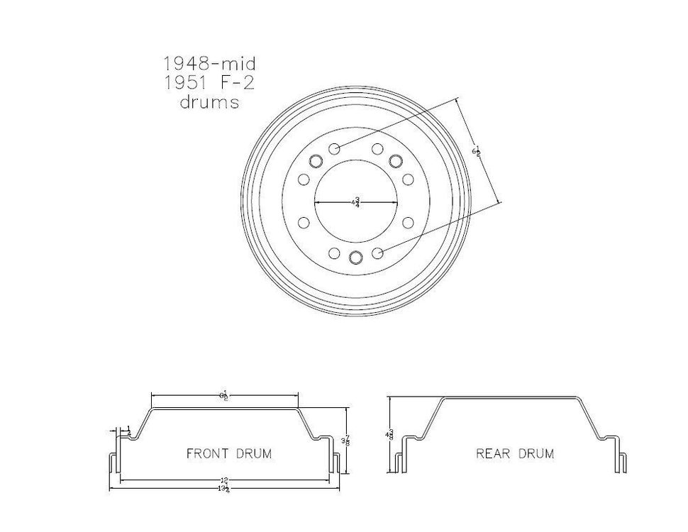

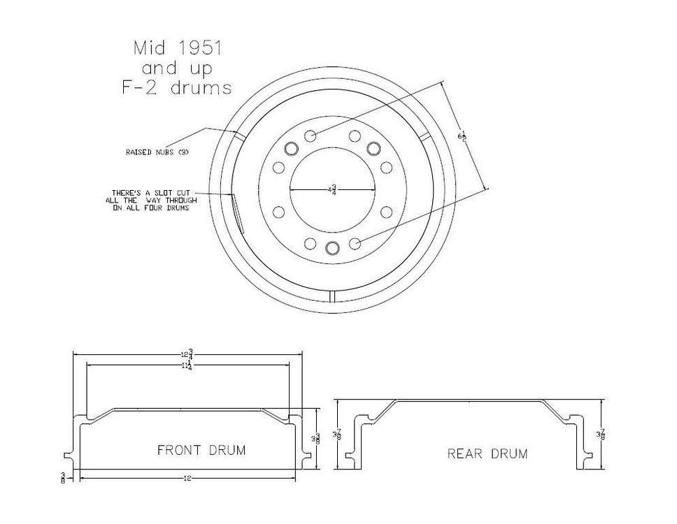

Here are the differences in the Lockheed and Bendix drums:

I have one of each. The lower one has the stock 12" diameter (2" face). Thanks for the clarification.

I suggest you match your brake system. Lockheed brakes have the lower double anchor cam bolts (and middle minor adjustment cams) whereas the Bendix has the more traditional star adjusting mechanism at the bottom.
