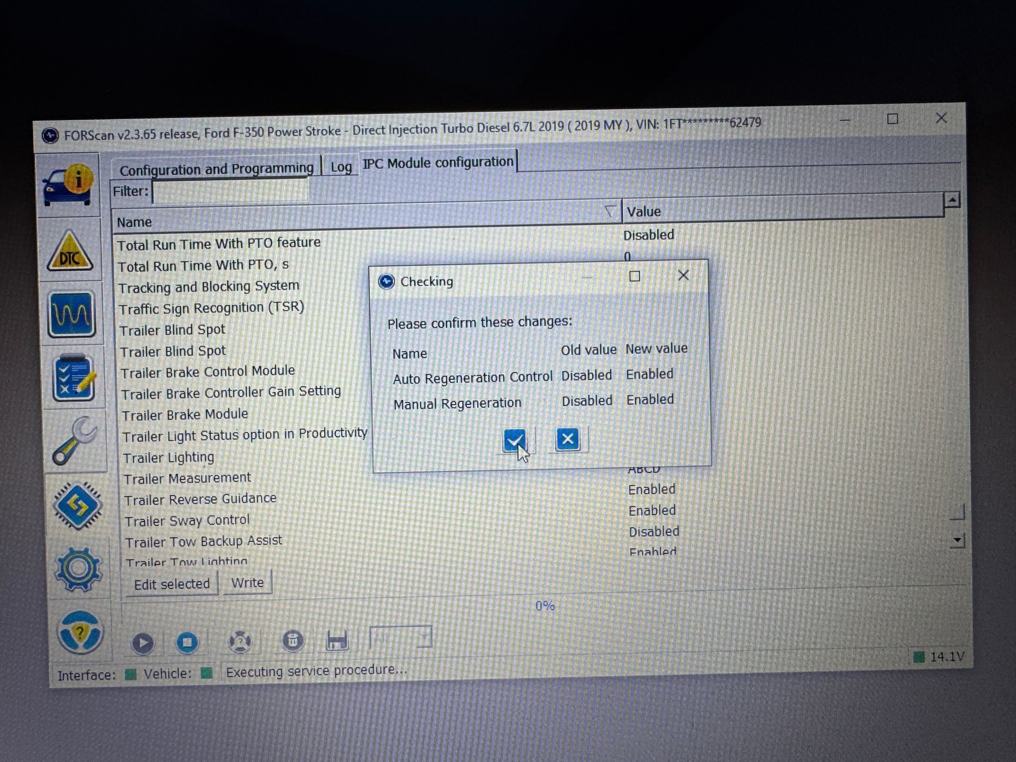

I enabled manual regents using FORSCAN. Where do I enable it on the dash? I cannot find where to enable it.

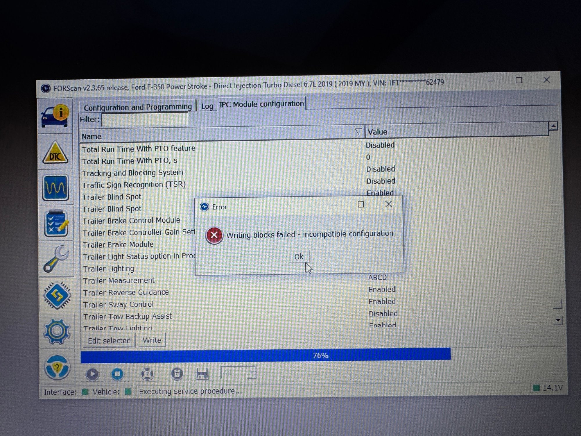

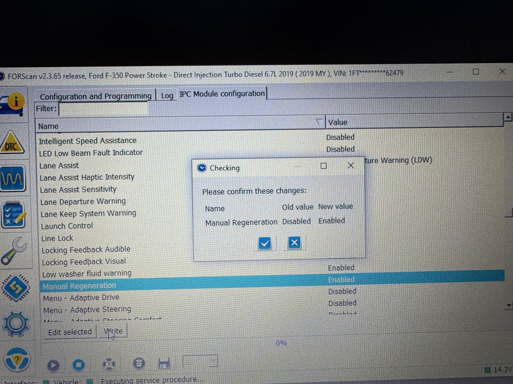

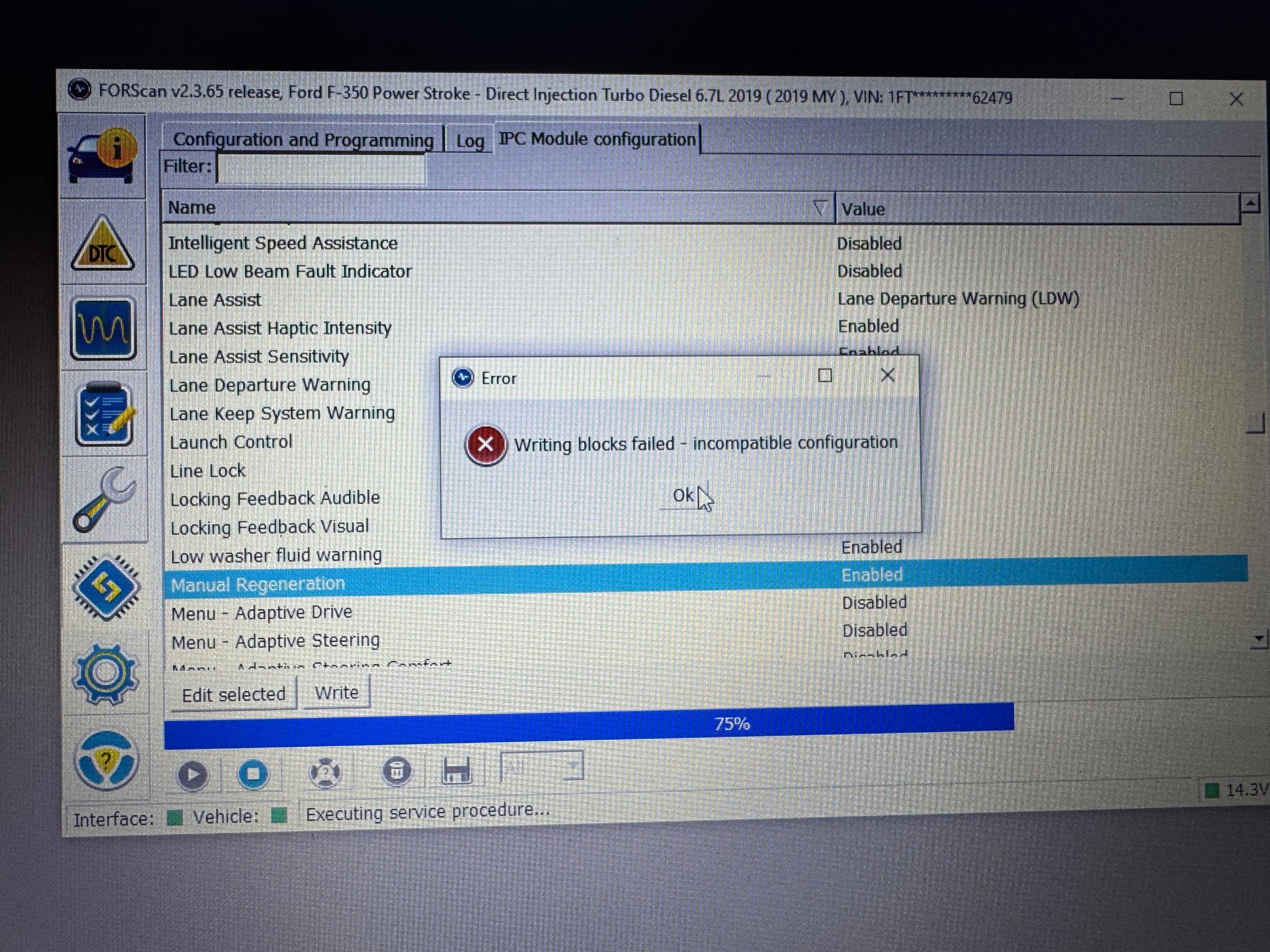

I went through Forscan again, and it turns out that it won’t allow me to enable manual regen. I kicks me out with an error.

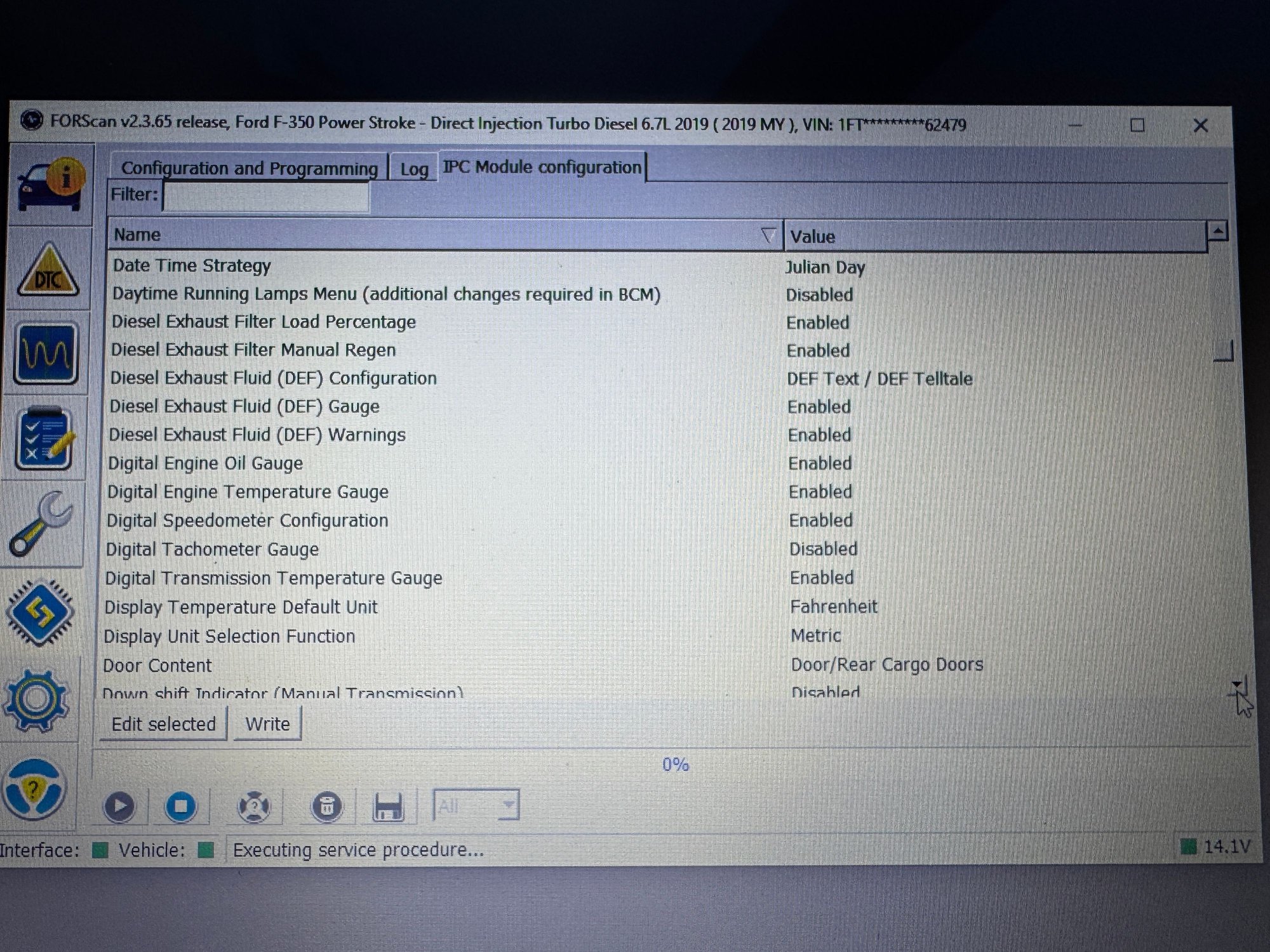

I had A Rod do mine with Forscan few months ago. Shows up in display so you can enable it after the software change.

The auto regen option in the IC does not allow me to check or uncheck the box.
my pictures did not upload for some reason.
