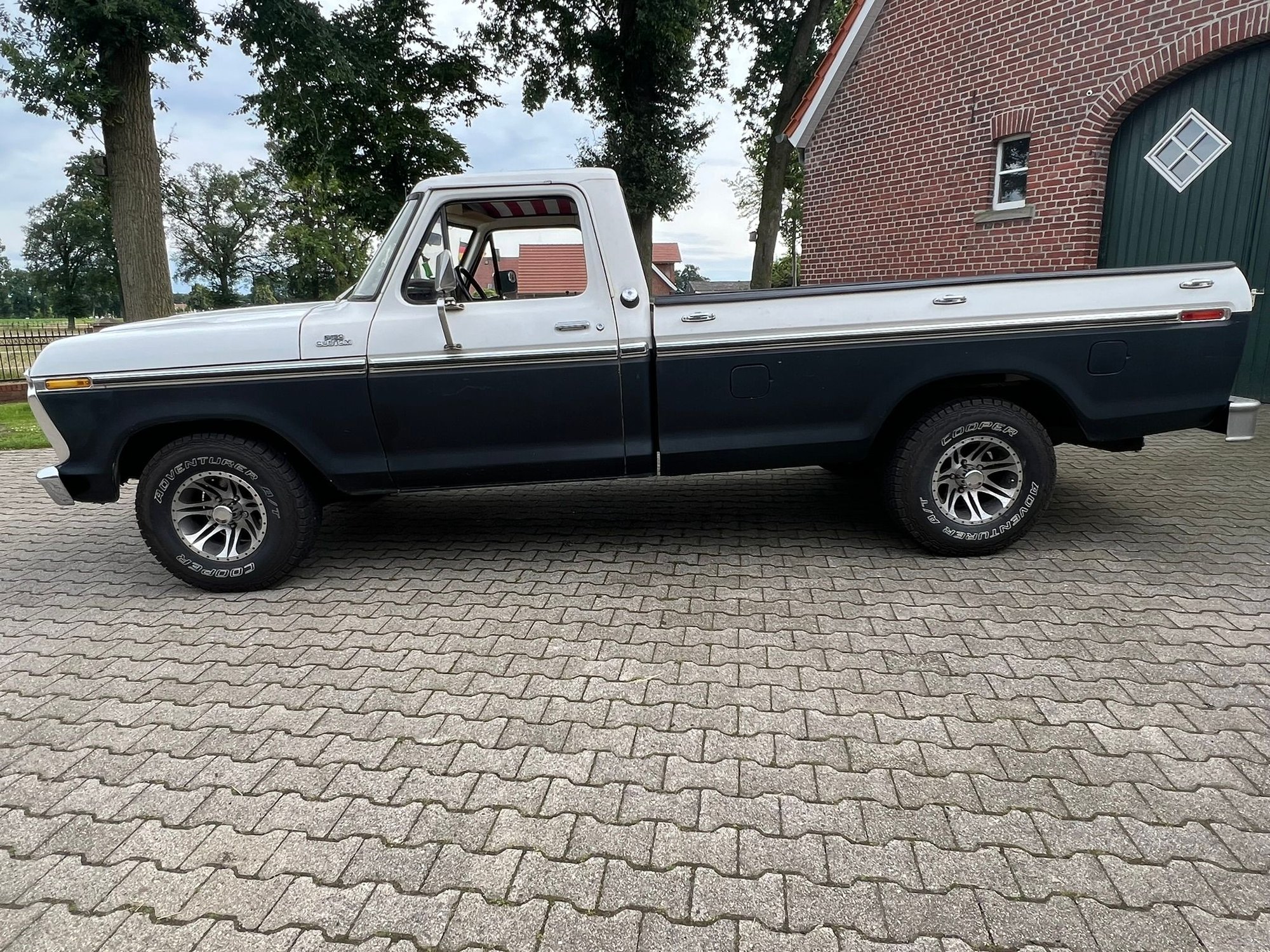

I have recently become the proud owner of a Ford F150 1977 Custom Truck.
I love this truck and will be restoring it as a rolling restoration in the next few years.
