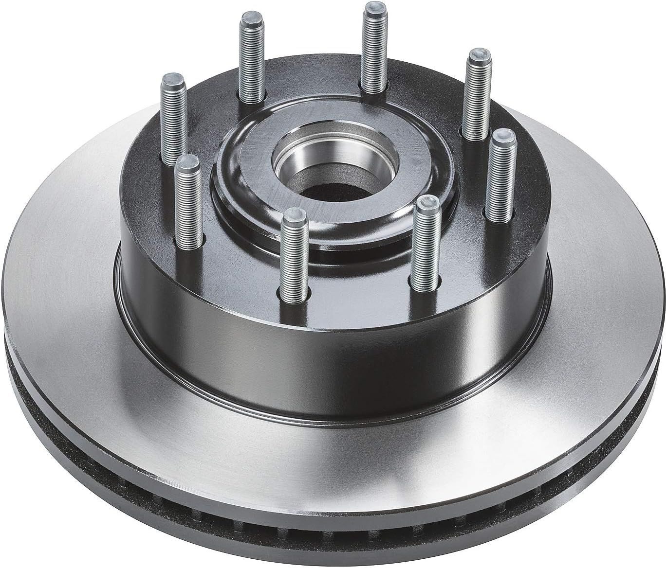

As noted in other threads, I am doing new front rotors, pads, wheel bearings in my 2005 Excursion V10 2wd.
I ordered a pair of rotors from RockAuto I thought were the right ones, and it turns out they are not. I thought perhaps I misread but it doesn't seem that way, and I went so far as to check other sources and ran into the same thing.
The rotors I ordered have a flat center section, and the ones on the vehicle now have a raised / extended center section. It does not look like the ones I ordered will fit as the spindle will be too long to work with the bearings. The two styles are shown in the attached photos.
Anyone have insight on this?

That looks like it might be a rotor for the front of a dually F350? Looking at Rock Auto for my 2wd 7.3 I only see the "correct" style I can't find the one you found. Nonetheless, that is the wrong rotor.

It's interesting as after I realized what I ordered won't fit, I stepped through all the front rotor listings for Excursion 2wd, and some showed the one I bought and others showed the one that will fit my Ex.
Here's the one I ordered:
WAGNER BD126213E Rotor & Hub; Black E-Coat on Non-Braking Surface Info
Front; RWD; with Twin I-Beam Axle; with Single Rear Wheels; 8 Stud Wheel; with 347mm Front Rotor [Wholesaler Closeout -- 30 Day Warranty]
Here are others that are similarly listed but the wrong style:
RAYBESTOS 680306R R-Line; Rotor & Hub Info
Front; RWD
BENDIX PRT5796 Rotor & Hub Info
Front; RWD
BOSCH 20011413 QuietCast Rotor & Hub Info
Front; RWD
