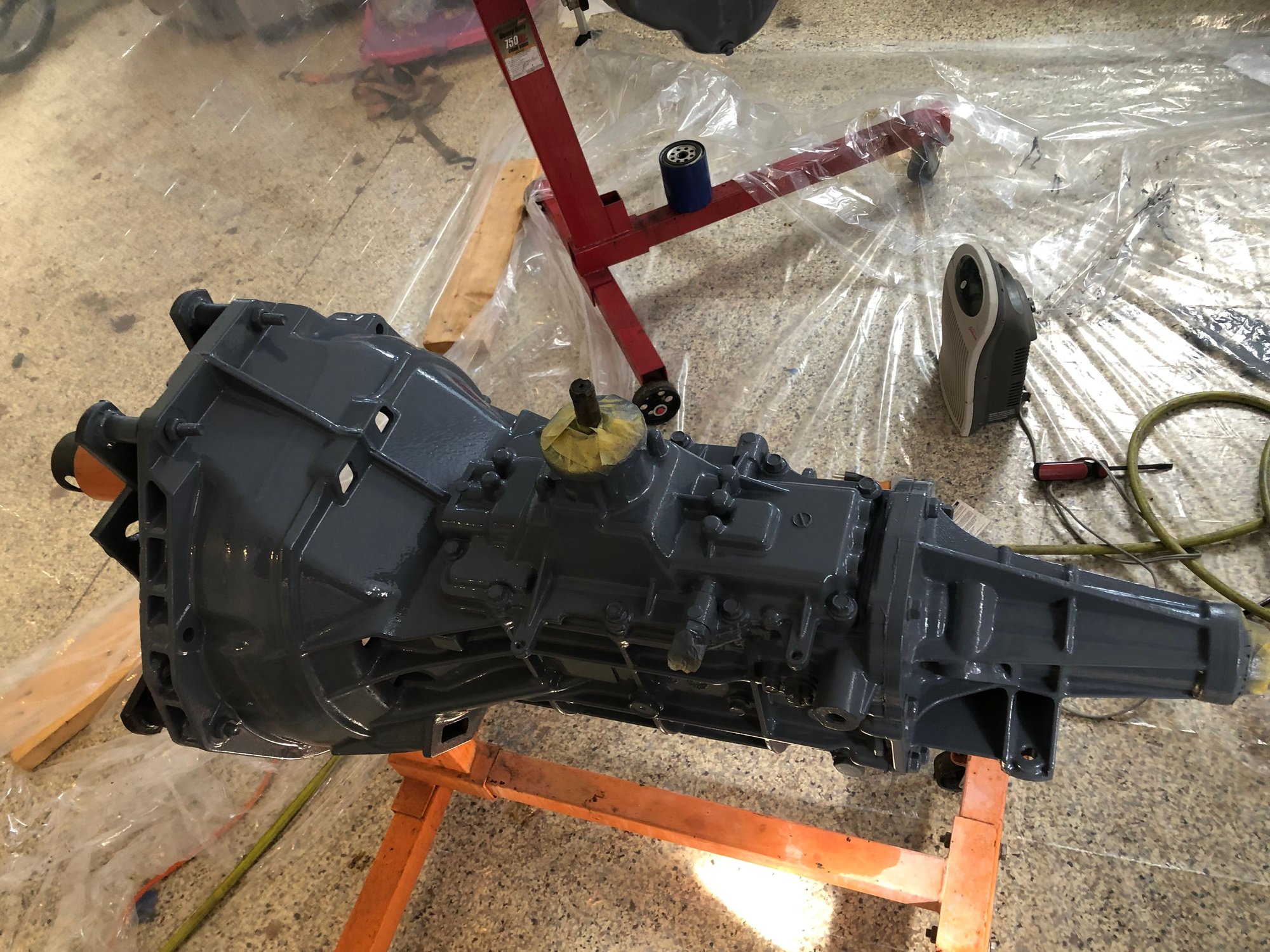

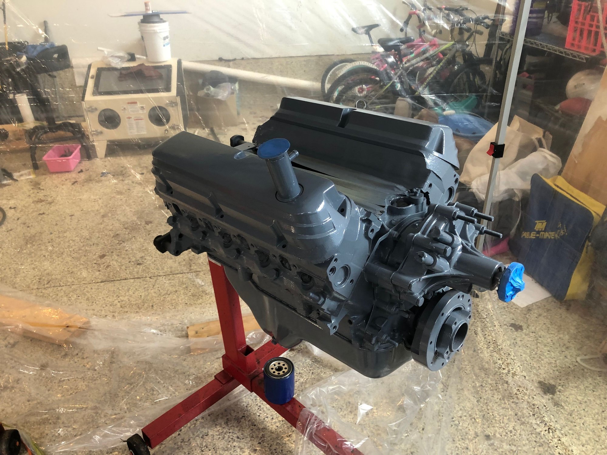

For motors I dont like to use primer before painting with a spray can.
The reason is too many coats between 2 or 3 of primer and the same for paint.
As the motor goes thru heating & cooling all them layers dont like to play nice and they start to flake off.
I de-grease the motor then wipe it down a few times with a oil / wax / de-greaser then just enough coats of color to get even coverage.
This is all done on a stand so I can get to everything. 3 motors done this way 1 a drag race motor and one in my 81 F100 with 5 years of driving on it.
Dave ----
edit: Unless you are doing a 100 point restored show truck I say paint it they way you want.
I have kind of asked the same question about my 81 F100 and a 70 Javelin and because they are not restored show trucks I did it my way.

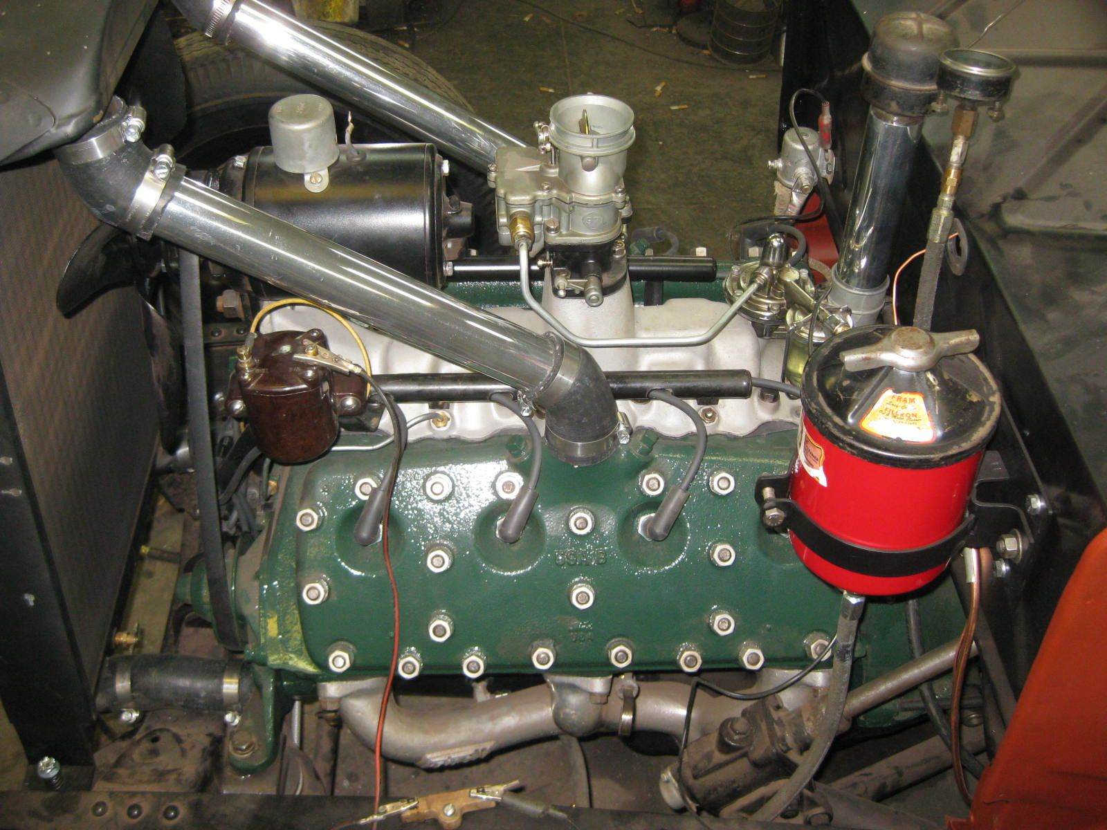

I like to paint motors the same way I would paint the body. Epoxy primer, then 2 part urethane. No need for high temp paint, just quality automotive paint. This is really for a new build, not so easy on just cleaning up an old motor, but urethane will not fail from gas and oil like a rattle can job will.
A flathead I painted 10 years ago...looks the same today

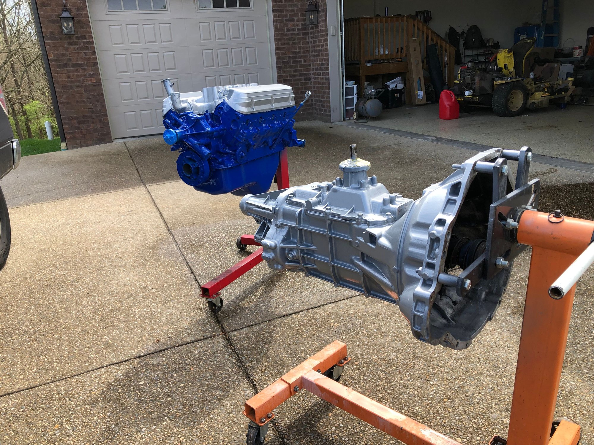

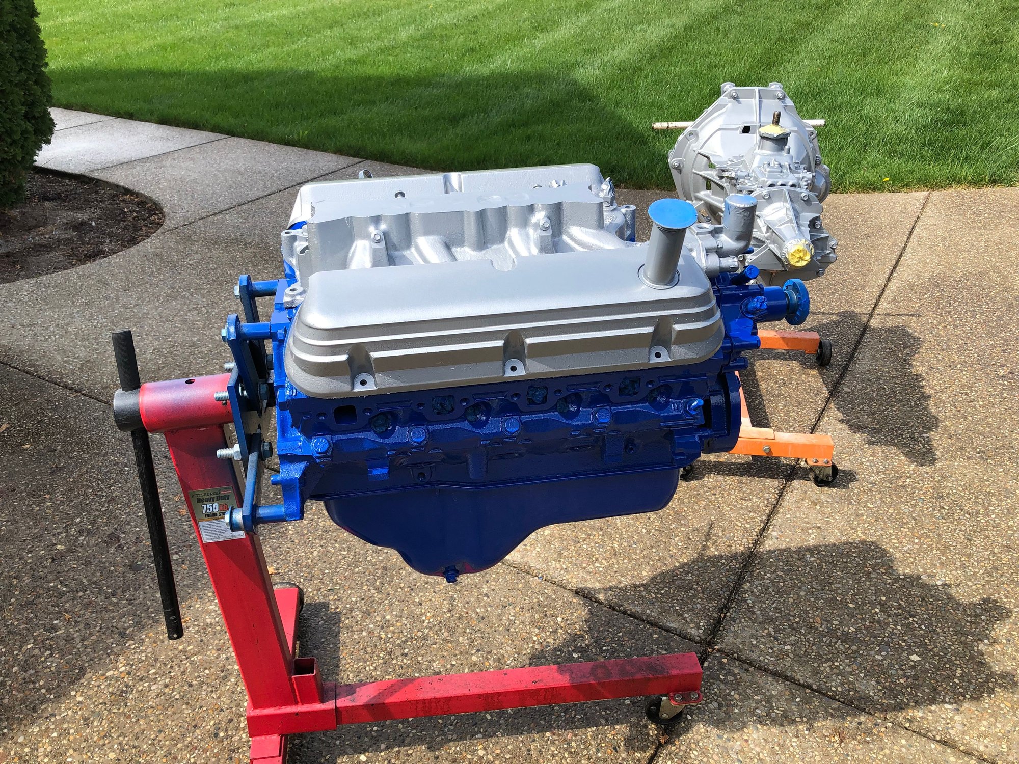

If you are on a budget rattle can it. Especially if it is temporary.
for engine I’d just get engine paint from the auto parts store.
if the engine paint is more permanent and you don’t mind spending some money then go with kbc motor coater kits. I used it on a build last year and there is absolutely no fading frome heat. Even on the FE exhaust flanges.

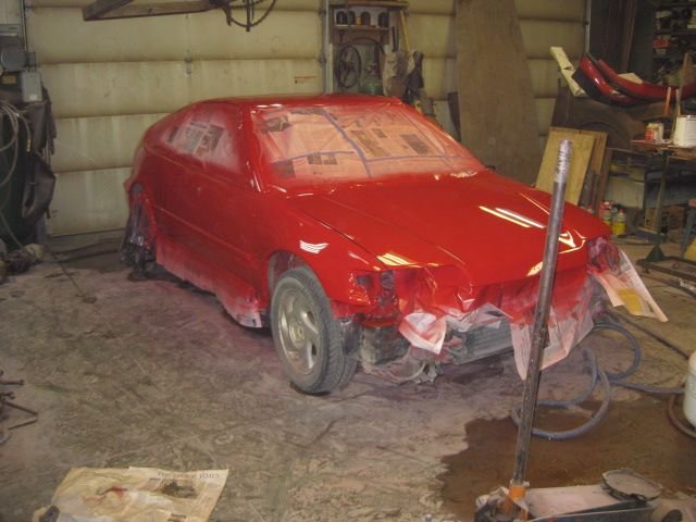

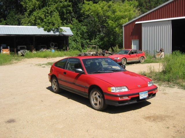

Personally, I believe rattle cans are good for target shooting with the .22LR, and thats about it. I will agree, paint prices have gone crazy for about the last 6-8 years. One quart of PPG epoxy primer now about 200 bucks with the pint of catalyst. Crazy!! I painted my 91 honda CRX a couple years ago,
The gallon of red PPG was over 500. I now lean towards brand x paints to save a little cost. Viking paints, in MPLS MN. sells epoxy primer for about 150, for 2 gallons, primer and catalyst. They make all kinds of paint, made in house no big brand name owners. I'm no professional, maybe painted a dozen or so cars in my lifetime, but I believe the amount of work that goes into the prep deserves a better top coat than rattle cans.
My 91 Honda CRX HF, amazing little car, get over 50 mpg...I love it!
