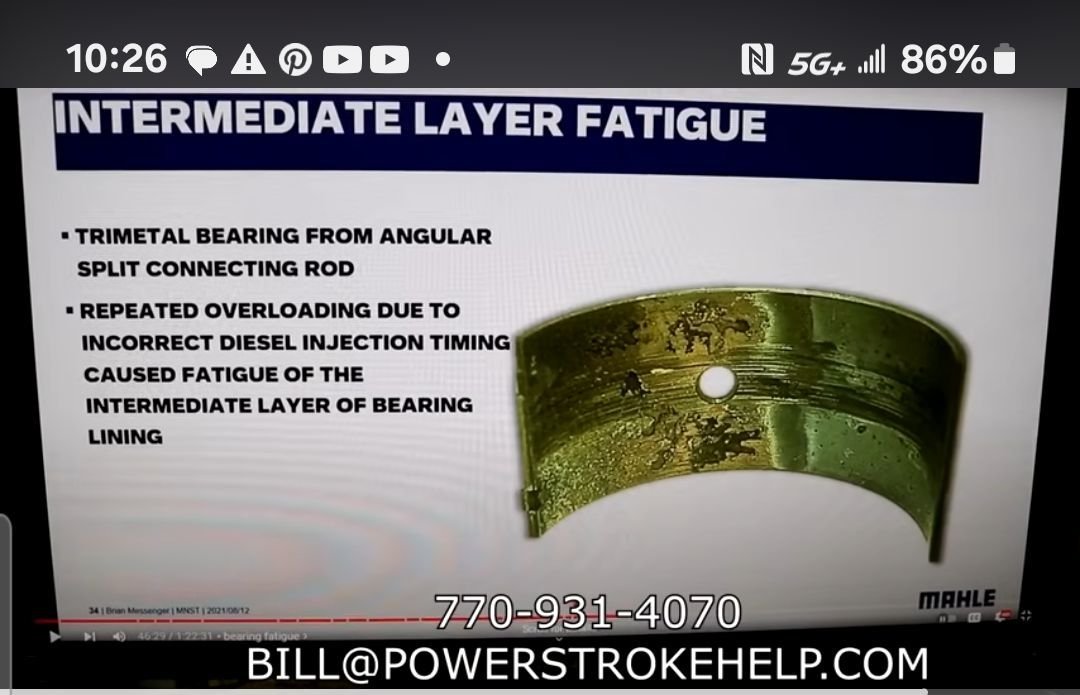

This is the point I was trying to make and this is from Bill's YT video I posted...
Just wondering if some of these 6.7s with main and rod bearing problems could be coming from...
I know there's way more knowledgeable folks here than myself, so I'm asking for a response to this and to Dave's concerns about the 6.7. I'd love to know the conditions of these trucks instead of just a general statement such as MY, mileage and tuned or not.

IIRC the video I watched, Bill lamented that it was due to "lugging" in OD. Recommendation was to keep the rpms up (higher) while the engine was under load.

That's caused by people doing tuning in the PCM without knowing what they're doing. Injecting fuel too early can cause combustion to happen while the piston is still on the up stroke and cause that damage. Factory tuning will not do this.
Yes that is correct and if IIRC, I thought Dave was mentioning all the main bearings he does in 6.7s... I posted those videos but watched them in the past. Maybe I need to watch them again if I'm wrong...

Lugging an engine down with a load on it is bad for any engine regardless of type. On a Harley twin cam you can snap the crank doing that.
You can't blame equipment for breaking when it's misused or abused.
Same could be said for modifying the tune in the ECM, just because you can crank the power up, doesn't mean you should especially if you're hauling a load.
The higher the performance the lower the longevity has been true since people started tweaking their engines to get more out of them. I'm guessing that was shortly after the second horseless carriage was built and there was a race between two enterprising fellows.
I too would be curious to know more about the conditions of engine, model year, how it was maintained etc before jumping to any conclusions as to why the bearings were ruined.
