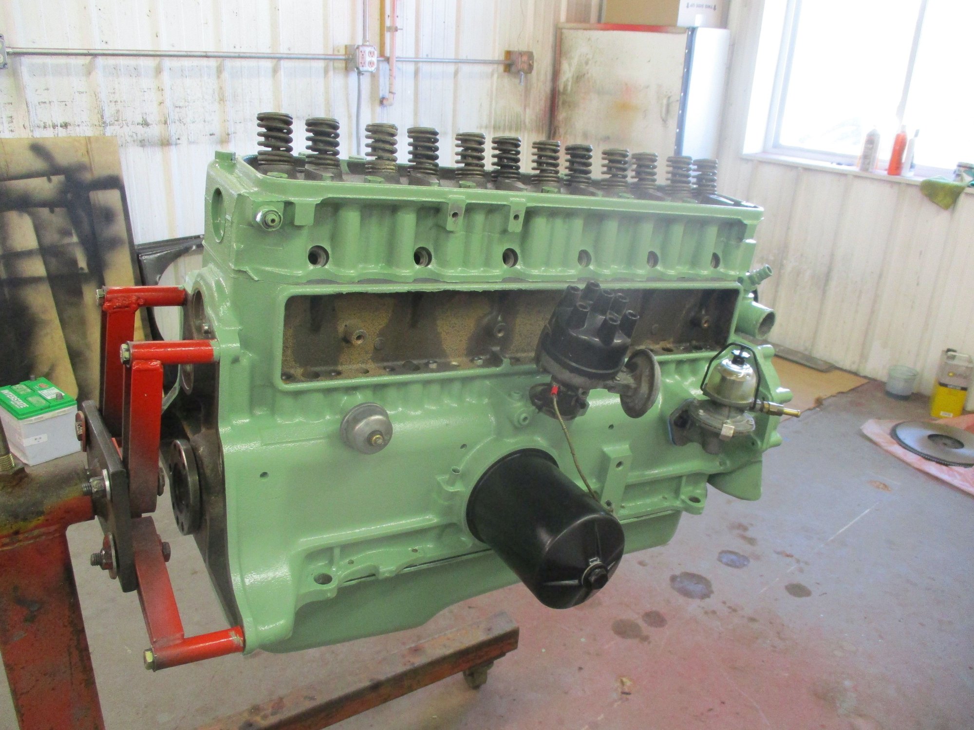

Originally Posted by 52 USCG Panel
My 52 F1 has a I6 215 that was bored out to accommodate 223 pistons and rings. The shop doing the work said it could be rebored at least one more time. Welcome and good luck with your project.
Jim
Thanks for the help. I need to decide what to do with mine. I have this engine but I also have a 302 that's been sitting in the corner for a while. It's not in as good of shape as the 215 but I'm still debating on it.

bmoran4's Avatar
bmoran4
Parts Nerd Extraordinaire
Joined: Sep 2010
Posts: 4,378
Likes: 1,787
From: Western NY
Jon, incase you missed the nuance, based on your bore measurement you initially provided, regardless if your engine was a 215 or 223 to start with, you already exceed the books max bore size for the 223 and thus already exceed what Jim has done and so if you are currently trying to source parts to rebuild it again, that could be futile.

Posts: 13
Originally Posted by bigwin56f100
not for the distributor. That front gear is the timing gear
Ok. The distributor gear is dead center

52 USCG Panel's Avatar
52 USCG Panel
Joined: Oct 2014
Posts: 3,912
Likes: 1,196
From: Deerbrook, WI
Dead center is correct for the distributor gear for an I6 215 engine used in 52-53:
I'm happy with my decision to stay stock. The fact that the engine you have probably can't be rebored again shouldn't be a factor for quite some time--and then you still have the 302 as a spare in the unlikely event your stock engine gets worn out.
Jim

Posts: 13
Thus is also why I'm thinking about the 302

Posts: 13
Jim
I would be happy to stay stock if I didn't already have it bored to max and almost it need rebored. I have a 223 block but its in pretty rough shape.
