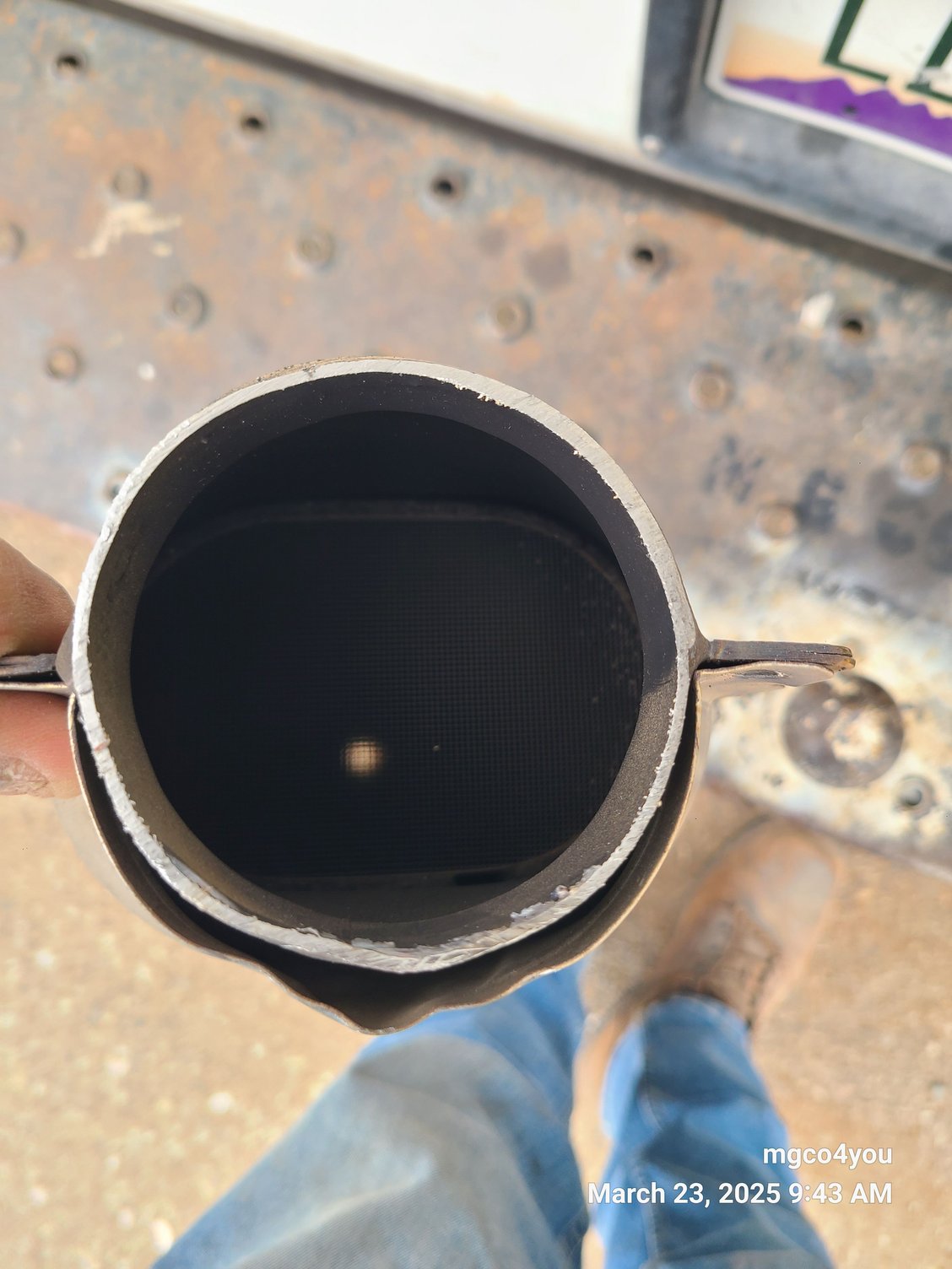

Old Mar 23, 2025 | 12:07 PM
inventor's Avatar
inventor
Posts: 87
From: Arizona
I have changed catalytic converter and sensors but the problem still is thesame nothing improved.
the old catalytic converter is very clean so installer new and the problem persist it idles but quits right after
Old Mar 23, 2025 | 01:03 PM
Eman85's Avatar
Eman85
Joined: May 2024
Posts: 898
Likes: 288
From: E TN
Expensive guess!
Let's start from the beginning. You posted about the truck not running right but didn't mention the check engine light. Then you say the check engine light has been coming on for months.
At this point I believe you have more than one problem and no diagnosing of any of them. A plugged catalytic converter can easily be diagnosed with a simple low pressure gauge and drilling a small hole in the pipe before the converter and measuring back pressure. Interesting that you stated that the catalyst looked like it had been changed once before, a lot of people guessing. it sounds like the code stored has been chased after before and doesn't directly relate to your performance problem.
How did you get the truck to a shop to replace the catalyst? Is it still not running good? I would start with the very basics of making an engine run, easiest to check is fuel. Check fuel quantity and pressure, a real pressure test with a gauge not pushing on the valve and seeing a little fuel squirt. When was the last time the fuel filter was changed?
