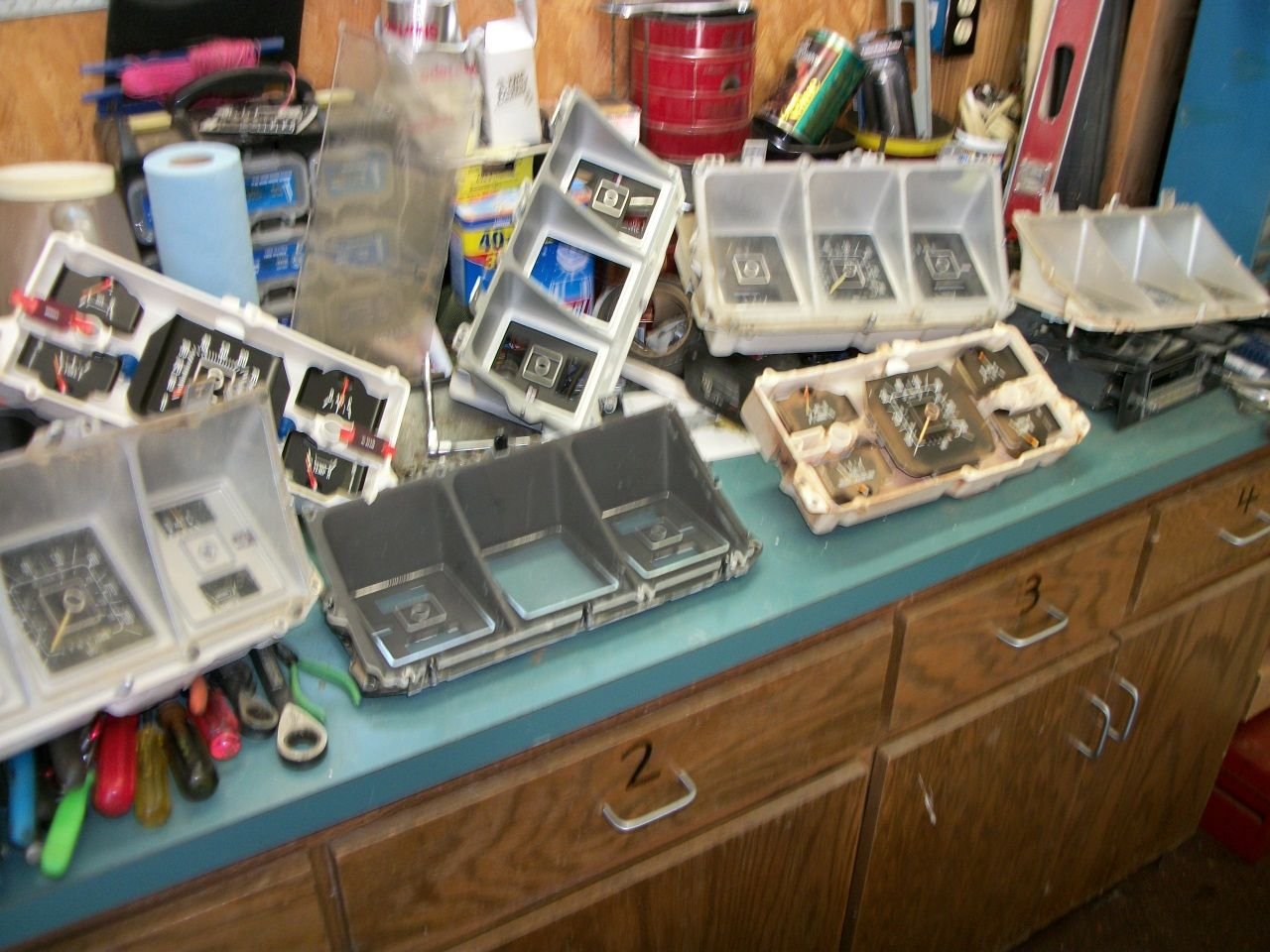

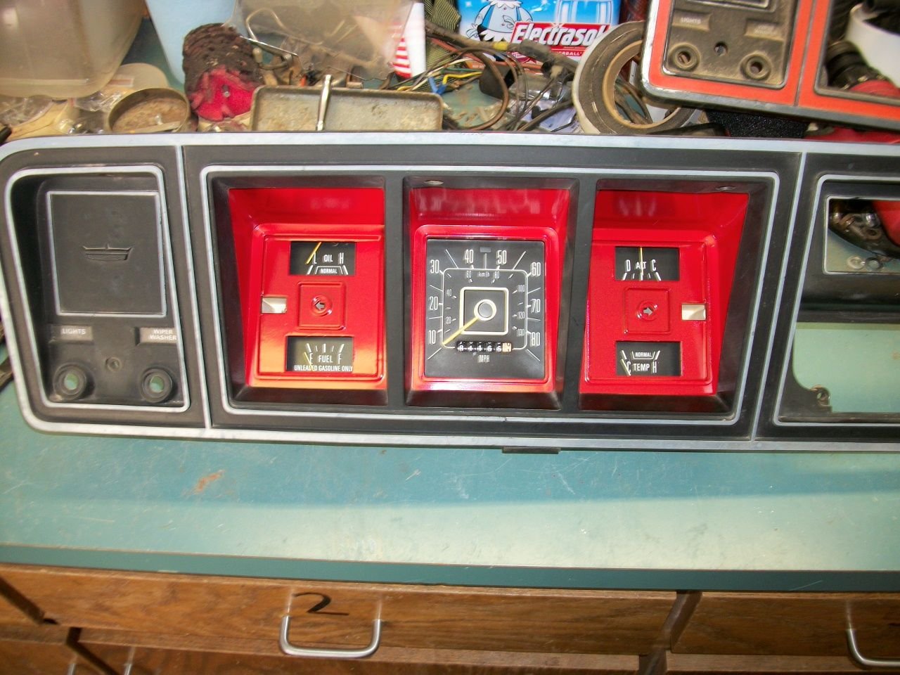

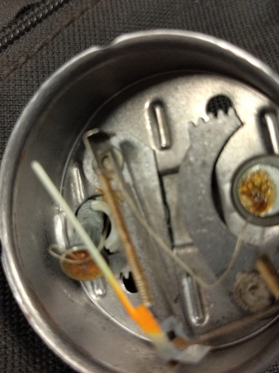

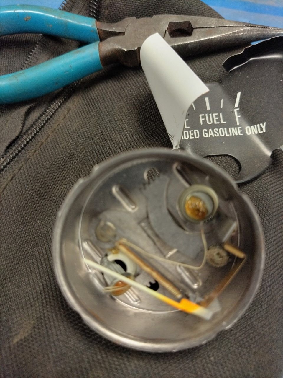

X2 blow it out with some very low pressure air or a compressed bottle of "canned air" like used on key boards. I know that you can adjust the gauge itself. Well make a adjustment to either side via a small hole in the back and some teeth on a arm with a small flat tip screwdriver. But it a tricky operation. Get the cluster to this part.
Notice that there is no rivets, the cover is crimped to the back round boody lip. Does not like to come off.
You can see the 2 arms and the slots that allow you to adjust. SO you do not have to take the fac plate off just get access to the back side of the gauge. And remember what direction to tun the arm. That MIGHT only chance the oms reading, I do not know. You can also see that there is already a cracked white piece around the threaded stud, that the nuts go on. The threads need to be held when you go to loosed the stud. DO NOTLET THE SHATF TURN,
When the stud breaks and fall out.
I have taken my fair share apart.
A guy just hade to Fast and Fusious his Ford truck in the dash dept.
