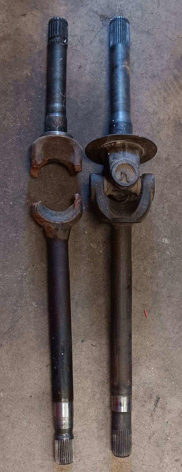

Hello, been reading the wealth of info/knowledge on this forum for many years.
Broke my driver axle ttb 44hd f-250 last year. Can't find replacement for the ttb 44hd so i bought one from ttb50. Length and inner shaft spline seems the same except for the spline on the short outer stub. U-joints are bigger as well. My question is can i just use manual locking hub from ttb50 so the spline can match with the short outer stub/axle or do i need to change out knuckle and spindle or anything else

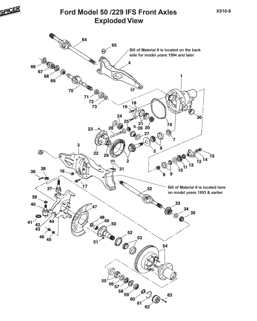

Considering you didnt ONCE think to include your YEAR for your vehicle in this post, i am just posting this first page of list numbers. Please go and give us the list number and some details about your truck please

According to what Spicer says, your axle is a Dana 44 UNLESS you have a
According to what Spicer says, your axle is a Dana 44 UNLESS you have a "SNOW FIGHTER" plow prep package. heres a Dana 50 for comparison to the previous post. Notice how it says where to find the axle ID on the member

Can't use d50 lockouts on your d44hd bc the d50 parts are larger diameter and won't fit in the hub. As I understand it, pretty much nothing between the two swaps.
Best bet is probably a junkyard for the correct stub shaft for the d44hd. Or, get a whole d50 and swap that in. You'll be less likely to break again. I'm just not completely sure the beams are the same length? I think they are, but can't tell you for sure.
Thanks boarding. You're correct. Lockout hub on the 50 is larger. Back to searching the junkyard

I'm gonna pull this from my memory of 20 years ago when I was a junkyard addict, building all sorts of rigs with junkyard parts --- The d50 outers are the same as d60, the shaft outers are bigger than 44, the shaft itself is bigger than the 44, and it necks down to same size as the 44 to get into the differential. The the u joints are bigger in the 50 than the 44 and the 44hd has only the larger outers (hubs) with the rest of the sizing to be the same as reg 44. You can't make any 44 parts work on the 50 without modifications or sourcing the correct parts.
Awesome van. If it has a 44 currently, I'd simply source a complete 50 TTB assembly and put that in. It *is* an upgrade and would eliminate any of the bullshlt that you're going through now in sourcing parts. Also you should be able to find a 50 ttb assembly for cheap
