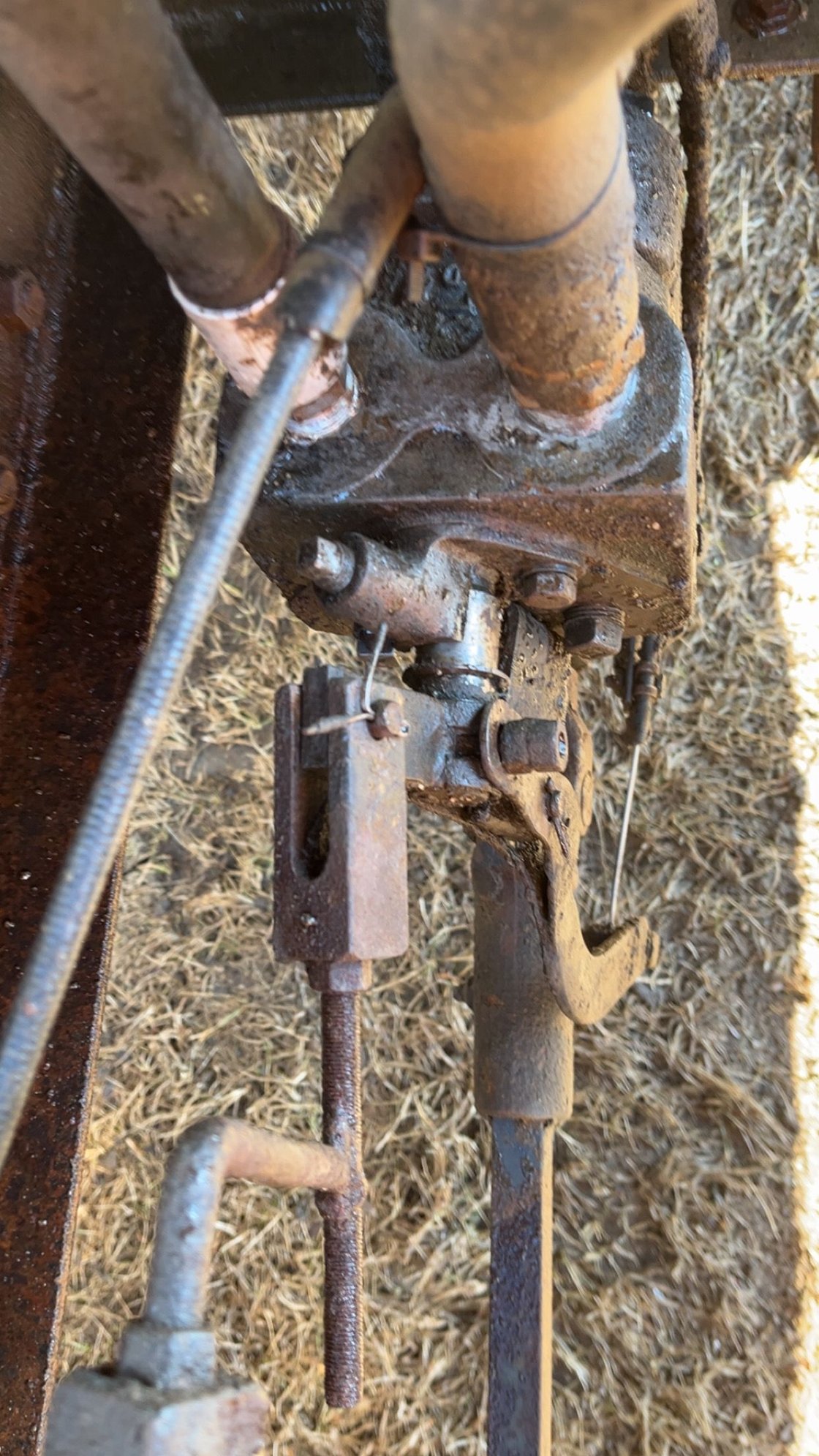

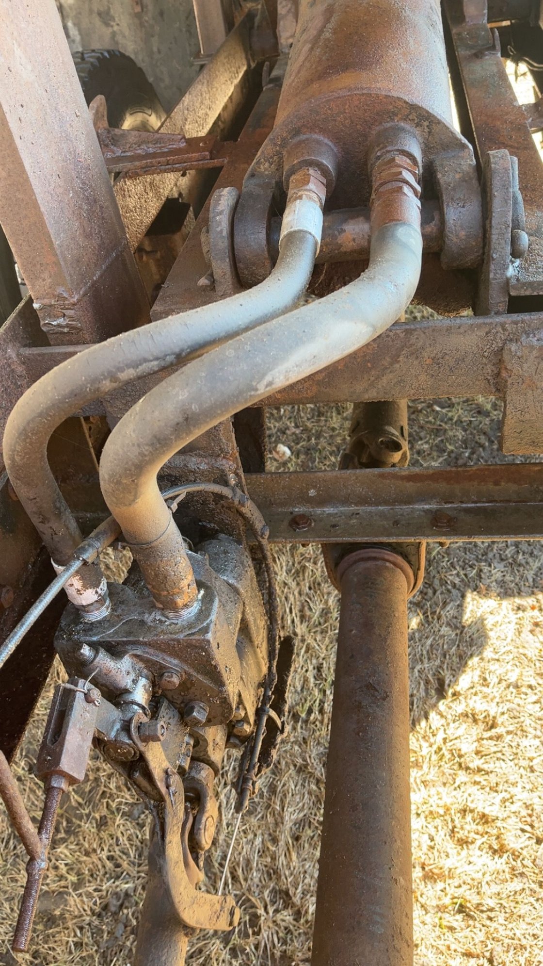

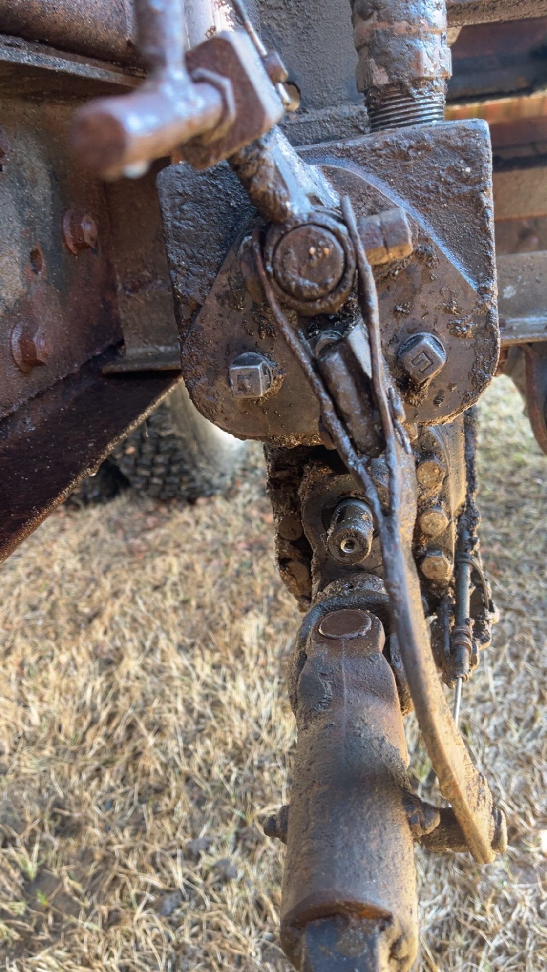

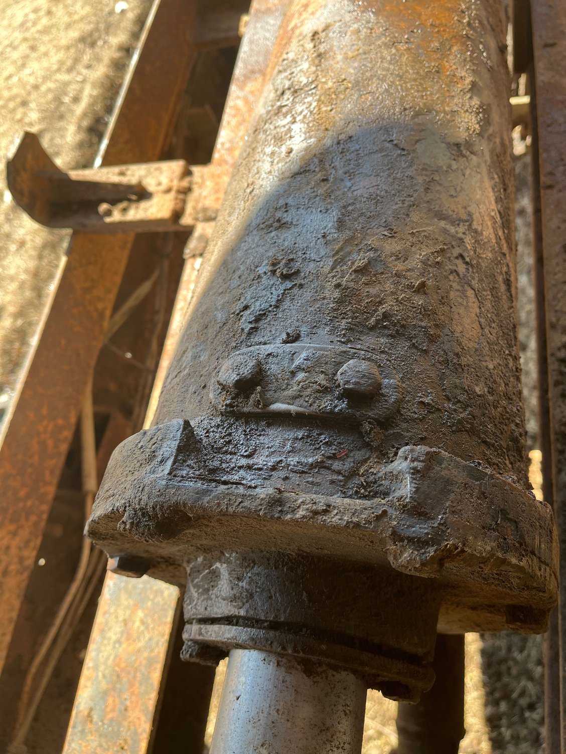

Pump pto pics
Spoiler
I got some better pics today I don’t see any resivoirs just the pump itself and I’m unsure what’s the exact fill location

Cylinder I believe is usually the reservoir on those. Should be a square plug on it to fill, at least the last one I saw did.

I guess that would make the most sense having it at the top of the system to fill all I see are these two bolts and plate up here.
