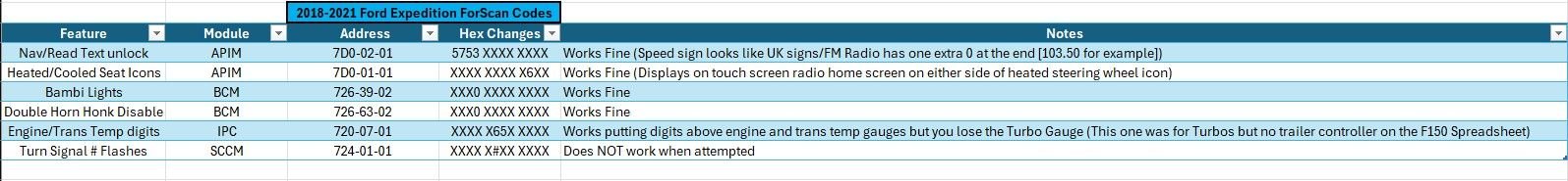

Used the F150 spreadsheet for a while on my last 2 F150's and now that I have a 2021 Expedition alongside my 2019 F150, figured I would try my hand at what works for our Expys. Here is what I have so far that works and one's that I tried that didn't work from the F150 Spreadsheet:
My Expy mirrors already powerfold on lock or I would have enabled that so didn't test (My F150 mirrors didn't until I changed that). This is all I got around to testing today. If I look to try more, I will add here. If you have never done this before, consult the F150 board that has the how-to guide and table of codes to try but be warned they may or may not work depending on what you try. If you find more codes that work. Feel free to post here and I will add them to the master list.
ALWAYS REMEMBER TO BACK UP YOUR "AS BUILT DATA" PRIOR TO ATTEMPTING ANY FORSCAN MODS!
