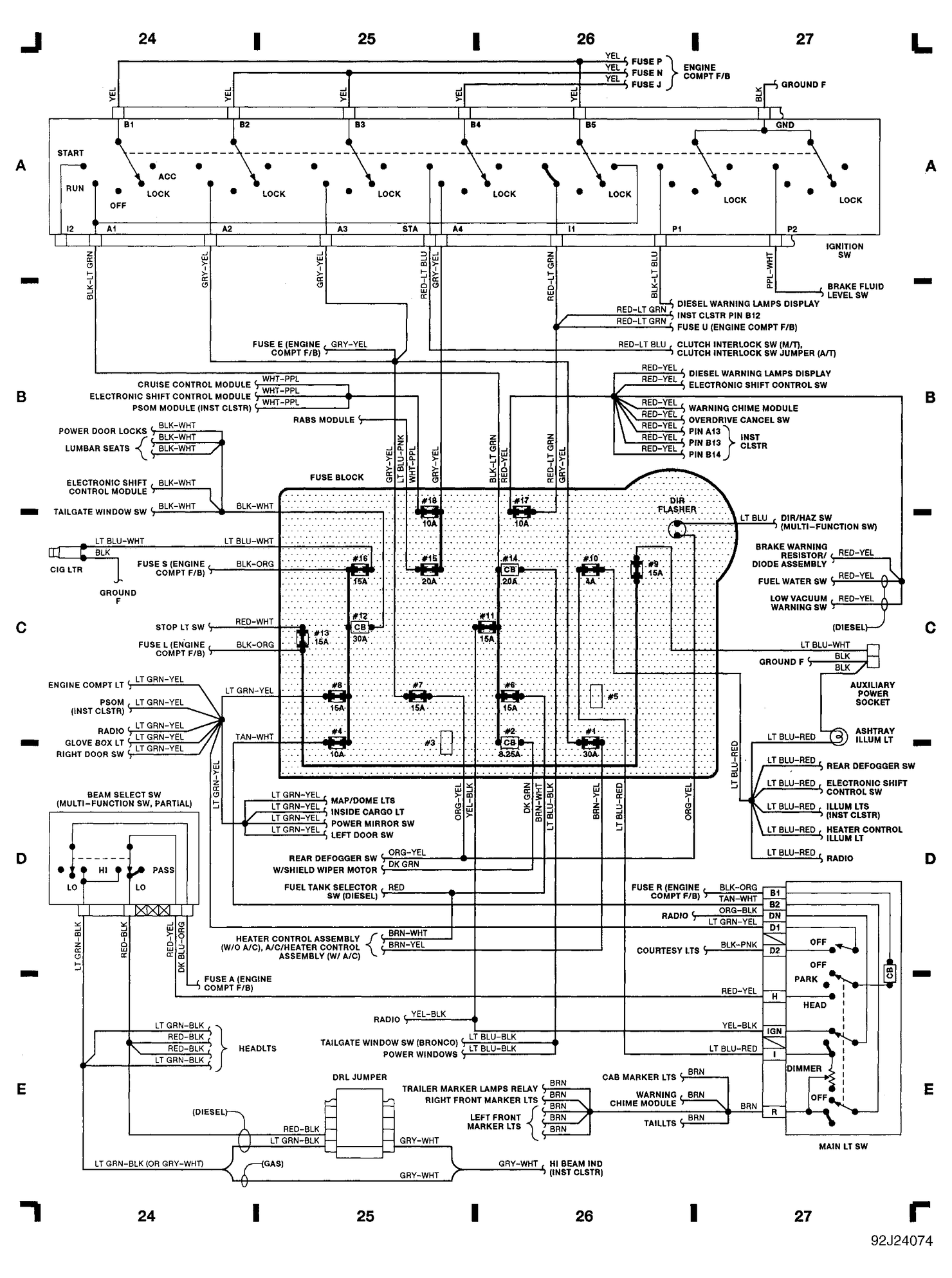

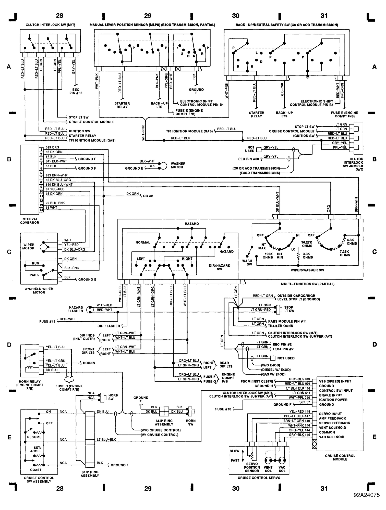

What transmission do you have?
And your issue, to me, is sounding like the headlight switch-to-column multifunction switch wiring.

Originally Posted by Aaron71houston
It is a zf5 truck. Im not exactly sure what you mean by headlight switch-to-column mulitfunction switch but can assume its the rod that you can pull and twist to turn the headlights and interior cab light on. If this was faulty would having no blinker be my only issue?
No, the switches are both known for wiring hiccups , and pretty sure they go to eachother since they are closely related on functions
Id recommend pulling the switch for the headlight and the column switch and checking contacts/wire conditions
Also, a really good thing to check is to try probing your trailer wiring for turn signal while you have the switch in detent with key on. The trailer wiring originates from the trucks switches but it does piggyback off the wiring for the truck,its doing its own runs.
Stop/Turn should be tied to the wires, so dont hold on the brake or youll be confused whats happening lol
The trailer wiring terminates by the rear bumper regardless if you have a connector or not.
the colors for your year may differ from SAE standardized trailer wiring, i forget what year they changed it.
Does your cluster indicators work with the switch? Even if its just solid lit while in detent?
