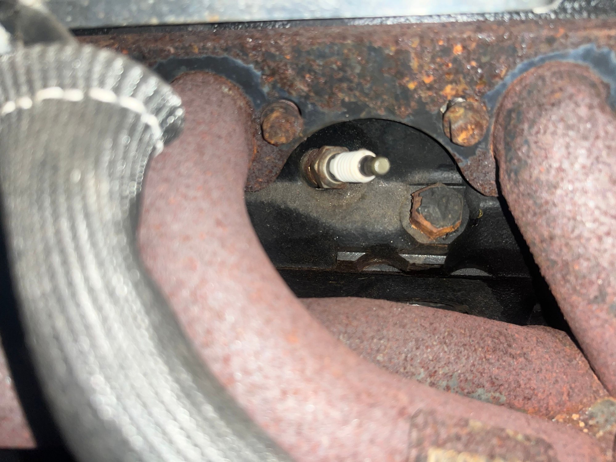

I will add the video of what’s happening. Few days ago i was driving home and going up a hill accelerating fully my truck bogged down in rpms and just started sounding super unhealthy, filled up gas because I just figured maybe I could be low fuel, went to put in reverse at gas station and truck died. Next day I started her up and even in cold start idle she was only running 2500 rpm’s compared to the usual 3-4000 then once warmed up it died out.started back up but Doesn’t sound like it’s running good when last week she was running beautifully. Note I did check fuel filter, truck will start right up just fine, just doesn’t sound the healthiest. This is a new 302 5.0 and trans.. and I did do some adjusting to the carb about a week or 2 ago as well, ran fine for about 5-7 drives. I have a video but it’s too long for this page. I could send it privately if you’d really want to help.

Each plug is heat wrapped and not even the wrap is touching any headers or exhaust plenty of space. Don’t see any sparks flying either in the dark garage when I try to start up

^^^ This is a lot more than the end of the wire being covered with heat shield material. Quality wires and properly routed?
yes properly routed MSD performance plugs and boots. still have the paper work from it being brand new along with engine and trans from about a year or 2 ago. truck wasn’t driven all that often since then. I’ve been putting more miles on it lately. But I will look into the plugs. What’s the best way to test them? Just by looking at them I can see any issues?
Yes, the condition of the spark plugs is a good indicator for certain issues.
