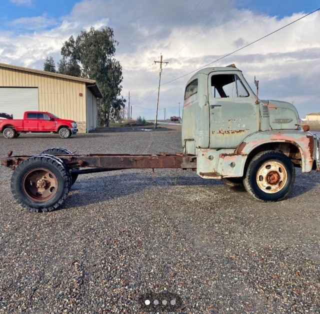

I recently purchased a 1953 Ford C600 cab forward truck and am looking for any information on the hood latch mechanism. It is missing the latches that extend through the hood to latch and relase the hood as well as other parts. Does anyone know if there are diagrams for this in any of the manuals? Replacement parts are nonexistent and finding used ones appear to be nearly impossible. I would like to replicate the factory latching mechanism. Also, has anyone seen the type of side markers shown on the steps. Below is a photo.

About the size markers, they are not original. Are you saying they are side marker lights? The picture is too small on my phone to see .

I thought the markers must have been added as I haven't seen them before. There are 3 total and they are not lit but could be wired to be so. They are pretty cool looking.

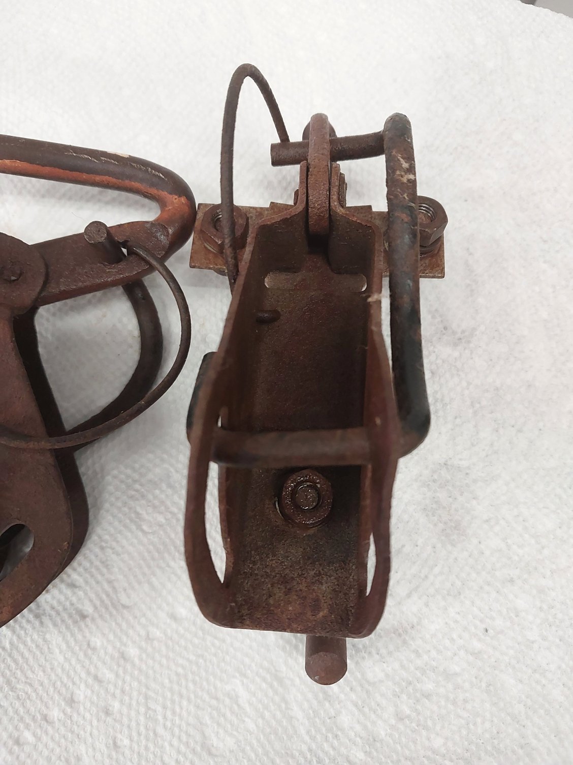

Is this what you are looking for? I don't think I have the bottom catch but that's not complicated to make.

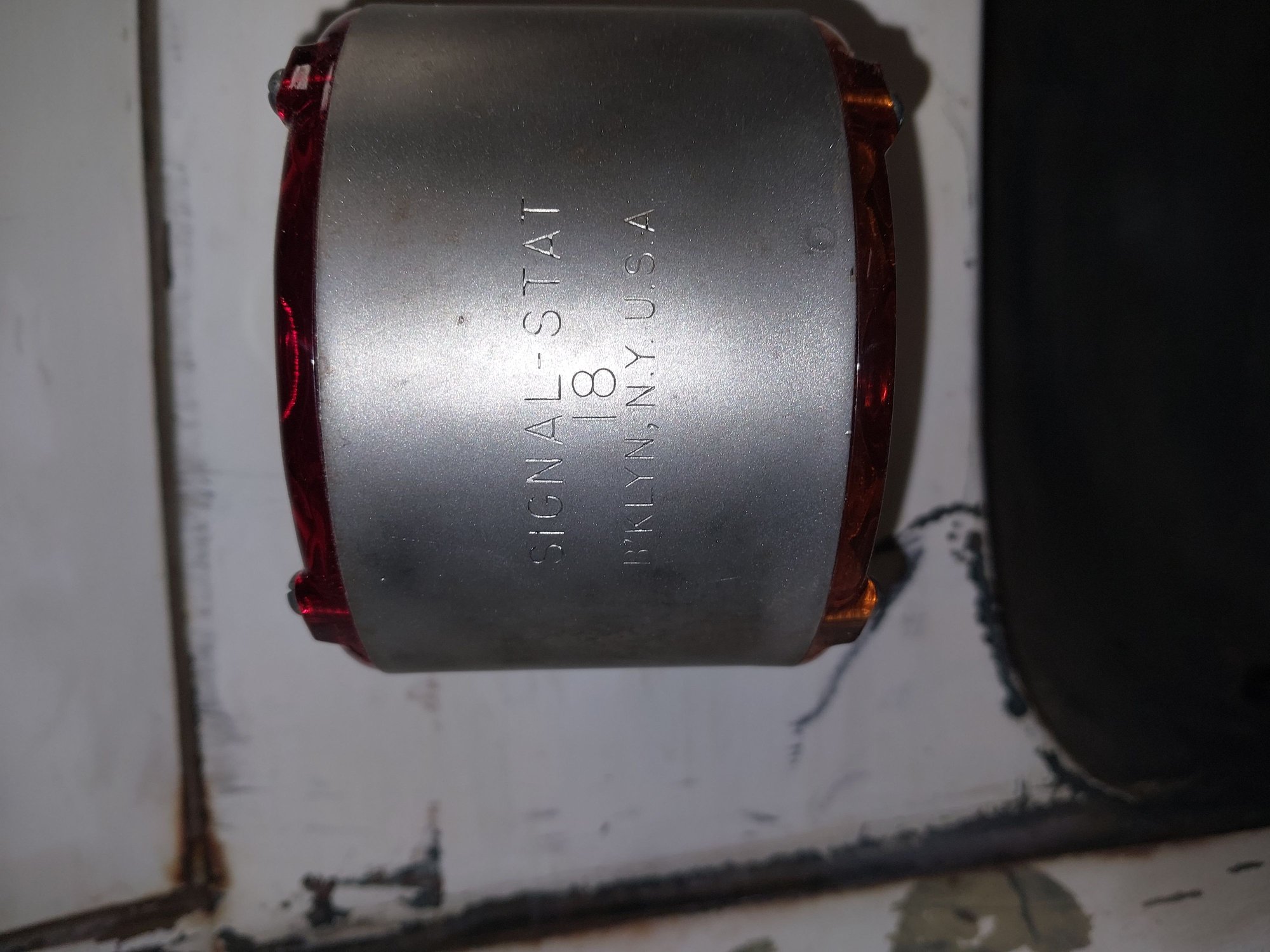

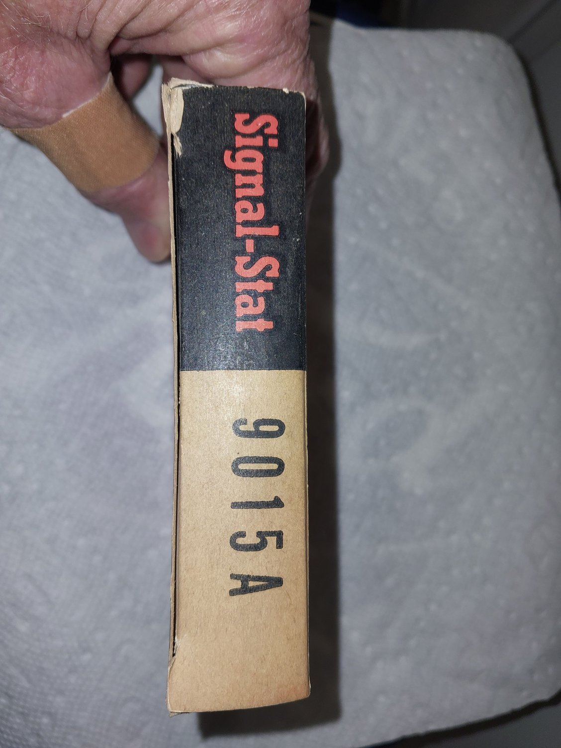

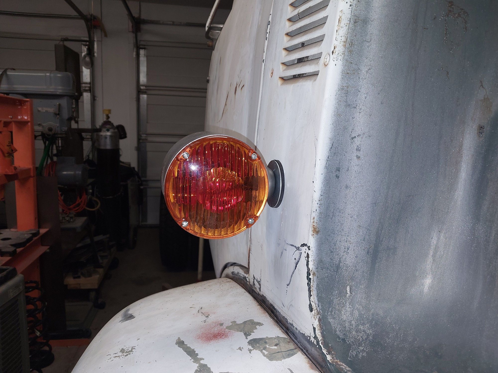

Signal-Stat lenses
It looks like you may have Signal Stat #18 lights. They were a popular add on back then. Replacement lenses are part number 9015 for red, and 9015A for amber. Blake Baughman had NOS USA made lenses for sale when i replaced mine. He's a member on here. I have a pair of the hood latches off my truck in a box somewhere in the garage. I'll try to get some pictures of them later today.

I missed the part about being on the steps. I can't answer that but if you need parts for the fender lights, my previous post might help. Nice truck.

COE latches
these are upside down.

Lower latch on radiator support

Latching part
Latching part
