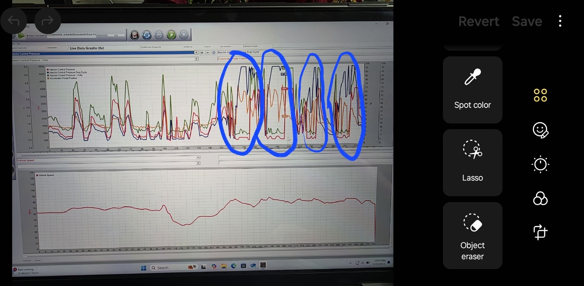

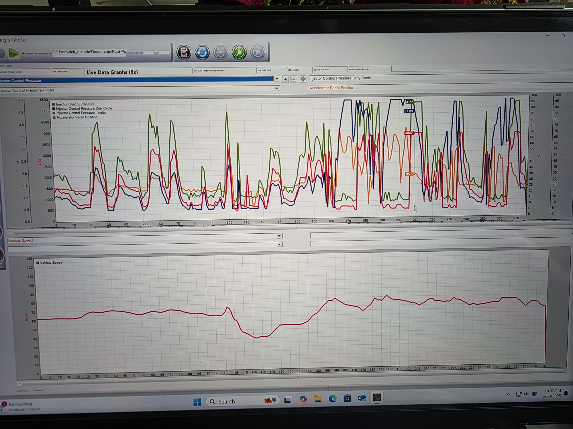

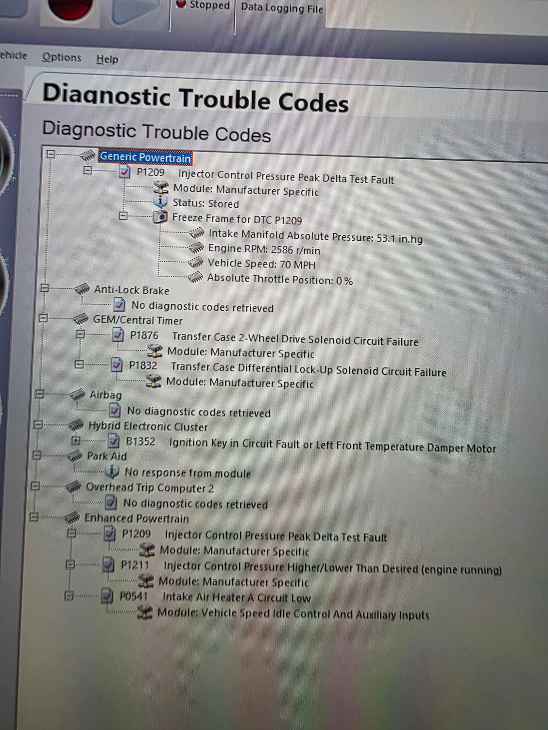

okay so ive done some data logging with my auto enginuity scanner and had some interesting findings, the problem only occurs above about 67 mph, it only occurs on deceleration after an acceleration above 67... upon application of throttle during this decelaration i have no throttle response for atleast 5 seconds, modulating the throttle does nothing, i have to let the truck coast then i get the ability to accelerate back.. generally the truck decelerates to about 60 before i get the pedal back. ive attached my AE logs and you can see that the injector control pressure duty cycle maxxes out and the ICP and ICP volts stay tanked. The orange line shows me modulating the throttle to try to get acceleration back then with a big puff of black smoke i regain the ability to accelerate again assumingly because my injector duty cycle is pegged at max. after driving the truck for a while and getting logs it also through some check engine lights. p1209 injector control pressure peak delta test fault; p1211 injector control pressre highter/lower than desired. i provided the log and another copy where I circle the episodes in the blue and ive included the CEL log. So far Ive replaced the pedal assembly, two icp sensors and the IPR valve, all genuine ford parts. With this log it appears that the truck is calling for injectors to open with the application of the accelerator pedal but the icp is showing low oil pressure and volts. Am i correct in interpreting this as the hpop is falling on its face after any accelerations above 67mph. Maybe it just cannot keep up with the bigger injectors? Any other ideas? I have another fuel pressure gauge on order as mine has failed. Once i have this i can confirm that i have fuel pressure during these episodes, the bosch and fass pumps are fairly new. Any ideas on my interpretation would be great, anyone who knows or has any ideas here would be really helpful.
circled areas are when the issue was happening
If I am reading this right, your IPR duty cycle is maxed out and your ICP is not keeping up. Your HPOP may be on its way out. The lag after high speed cruising may be the HPOP reservoir emptying out as the leaky HPOP attempts to keep up with commanded ICP. The APP seems to be reading okay so it's not a potentiometer dropout.
